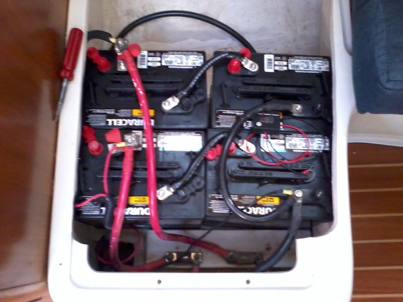

Just checking to see if anyone has installed 6 volt batteries, did some measurements and it looks like they would fit. My plan is to put 4 6volt and 1 12 volt for my starting battery.
Thanks,
Mark
Just to bring this back around to Mark's original question, here are my thoughts and experiences. You can read all of the details of my battery system upgrade on our blog.
You can not fit 4 golf cart batteries and one group 24 battery in the proper orientation in the battery compartment on a Catalina 310. I tried every possible configuration. In the end I had to accept that two of the batteries are not orientated correctly. I was willing to do this because of our cruising plans. If I was simply doing weekend cruising/say sailing with a couple of vacation cruises mixed in I would not do this setup. I would probably do a primary bank of 2 12 volt golf cart batteries and a reserve bank of 1 group 24 or 27 battery. As Maine Sail pointed out, 225 Ah is a little small for the primary bank. The 2 12 volt golf cart batteries would be around 300 Ah.
This brings me to my second point. Eliminate the terms "battery #1", "battery #2", "house bank" and "starting battery" from your vocabulary. Think instead in terms of "primary bank" and "reserve bank". As Maine Sail pointed out, you don't need starting batteries on our boat. I have started the engine at least a dozen times from a group 24 battery. I have only used the group 24 just to test it. Because the primary bank of 4 golf cart batteries fires up the engine with ease and keeps me in plenty of juice. With the addition of our solar panels (man, I really need to write that post already. sorry) we don't need shore power. It has been 6 weeks since we last plugged in. That's 6 weeks of full time live aboard with the refer, water pump, TV, fans, stereo, etc. running. During one stretch of 3 cloudy days in a row the worst I got was down to 65% SOC.
The way to size the bank is to work out your power consumption and then see how many days you want to go without charging. My estimate had my max usage at 178-195 Ah per day. Our real world experience has been closer to 40-80 Ah per day. I think the big reason is two fold, 1st I am installing the inverter this weekend. So I haven't had that use on the batteries at all yet. Second, the refrigeration system. I did some tinkering, recharged and bled the system, changed out some gaskets, etc. I also only keep it just cold enough to make ice in the freezer section. So it's typically only 28 degrees in the freezer and 35-45 degrees in the fridge portion. This is warmer than you house fridge but more consistent than just having a block of ice. Right now, we use about what we can put back in every day.
Good luck and fair winds,
Jesse

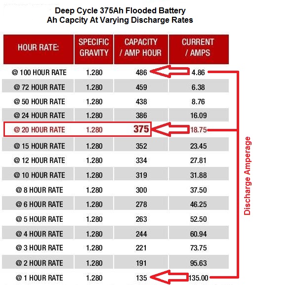

I have a question to help with the understanding of this... if one has the original stock alternator, using either 2 deep cycle batts vs using 4 deep cycle batts, if one was to draw the bank down to 40% of charge (NOT 50amps), would it take the same time to bring these banks back to full charge, or even within and hour of each other?
With the same charge source current the larger bank takes longer due to the longer bulk time. The absorption time will be similar though the larger bank will attain the limit voltage a bit higher in the SOC curve thus utilizing the max potential of the alt for a bit longer.
Let's assume a C-310 with a 55A stock alt and a voltage regulation point of 14.4V. Let's also assume that in bulk the alt can't produce more than about 45A due to heat and we are using 50% of bank caapcity.
The 225Ah bank is charging at 0.2C or about 20% of its Ah rating. This battery will attain the limiting voltage of 14.4V at approx 75% SOC and bulk charging will take roughly 1 hour. From this point forward the charge acceptance rate at 14.4V and XX SOC is governed by the battery and determines how long it takes to get to full. With a brand new battery you are upwards of 7 hours and as it sulfates closer to 10 hours or more.
You used 112.5Ah's and in 1 hour you were able to return about 43Ah's before your charging speed began to decline to a point where you were no longer using your alternator in an effective or efficient manner. If you do 1 hour per day of charging then you essentially have about 43 usable Ah's when off cruising, unless you want to run the motor and alt in a less efficient manner. You are also discharging the bank and cycling it between 50% SOC and approx 75% SOC.
The 450Ah bank is charging at 0.1C or about 10% of its Ah rating. This battery will attain the limiting voltage of 14.4V at approx 85% SOC and bulk charging will take roughly 3.5 hours. From this point forward the charge acceptance rate at 14.4V and XX SOC determines how long it takes to get to full. It will essentially be the same duration as the smaller bank once absorption voltage has been attained.. With a brand new battery you are upwards of 7 hours and as it sulfates closer to 10 hours or more.
If you used 225Ah's over a few days in 1 hour you still return 45Ah's. If you run the full bulk period this will take approx 3.5 hours but you are returning approx 157.5Ah's in bulk vs. 43Ah's. Also due to the C rate being smaller you get to a higher SOC before the alt begins cutting back current based on battery acceptance. Due to the lower C rate your alternator is getting the batteries to a slightly higher SOC point before voltage limiting begins. With 1 hour per day of charging you are still easily able to get 43-45Ah's of use but if you keep up with that 1 hour per day your 450Ah bank can remain at an overall higher cycling SOC every day than does the 225 Ah bank..
This means longer life from the larger bank plus the ability to go a few days in between charging episodes, if you are willing to run the engine longer for bulk replenishment after not running it for two or three days. Usually this can be planned around a windlass day but you get the option and the bank, if you keep up with 1 hour per day, remains at a higher SOC than the smaller bank which can lead to dramatically longer life...
Course Peukert has also not been accounted for and the larger bank will be drawn down at a lower percentage rate so it can actually deliver more Ah's than the 450Ah face value rating.. If we figure 100Ah's per day then the average load is about 4.2A and your Peukert corrected bank size, assuming 1.27 Peukert, at that load, grows. The 225 Ah bank also grows at that load. The larger the bank and the lower the load the more effective gain you get from Peukert. While both banks have a net Peukert gain at a low discharge rate, the large bank gains more effective capacity, as a percentage, due to Peukert in relation to the same discharge rate.
This is a good battery manufacturer chart that sums this up:

*Charge efficiency is better
*Cycle life is better
*The batteries ability to support voltage is better
*You get slightly more usable capacity at the same average load

What size 6V batteries?
Feb 6, 1998
11,765
From the photo I can tell they are group GC2 size and would be either 215 Ah or 230Ah Duracell's which are made by Deka/East Penn for Sam's Club..
