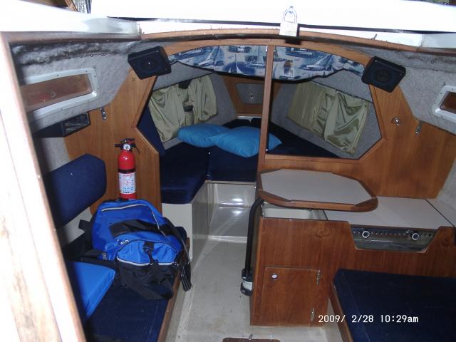

I just bought this boat, so can't attest to this location, but here is where PO placed stereo.

Hey Mick!
That's where I would have put it. Did your table come with that Formica top on it, or did you put that on? That cabin looks great.

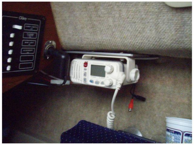

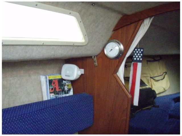

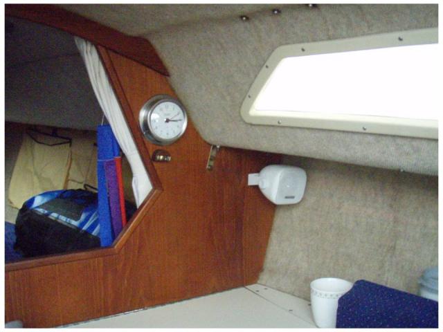

I mounted mine just inside the companionway under the starboard stantion. I did this by getting a longer backing plate for the stantion that extended further toward the bow, and then mounted to that backing plate. My VHF radio is mounted on the other side using the same approach. I did put a plastic barrier to protect against a leak at the stantions. My speakers are mounted under the sidedecks against the forward bulkheads. I'll try to get pictures in a week or so after I retrieve the boat from storage.

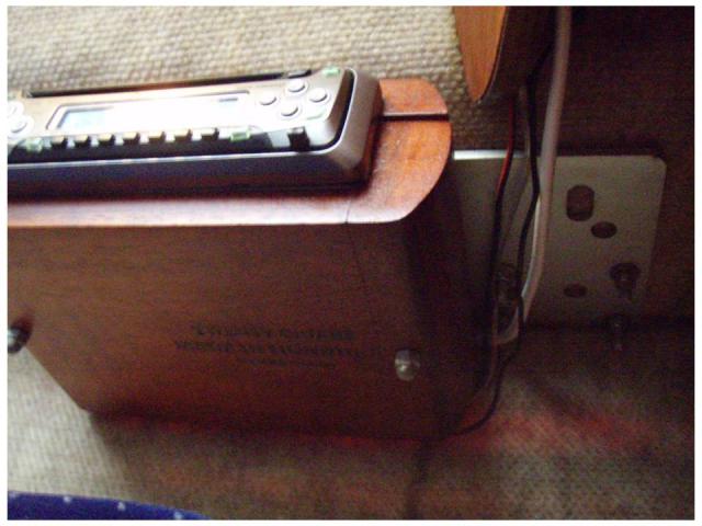

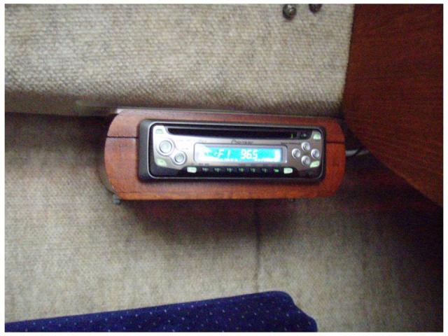

Here is the picture of the stereo mounted under the backing plate. I cut down an old cigar box to make a case for the stereo. As I indicated in my earlier post, I took some scrap aluminum and made new backing plates for the stantions. The stereo box was mounted just forward of the the starboard aft stantion. I did put a plastic lining against the backing plate so a leak at the stantion doesn't fry the radio and I also re-chalked everything. I angled the speakers in slightly using small wooden wedges. The starboard side mount has to be close enough starboard to open the cover for the stove. Also, on the port side, I attached the VHF using the same approach. Overall, I have been pretty happy with how it turned out.

That's one nice cigar box! I just made the cut yesterday for my stereo and speakers yesterday. I think the location is good, but I'm not 100% sure the cover I bought is going to be the best since the lid doesn't lift too high and the stereo is pretty low, so you need to bend down farther than I expected to look at the faceplate. I also finished wiring up the boat yesterday. I want to go ahead and run a vhf antenna cable, just need to decide where (mast or other option). Almost ready to put the hull liner back on.
