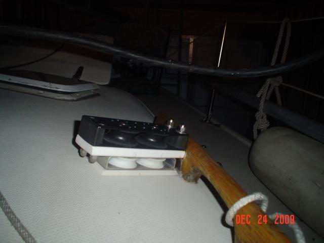

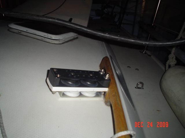

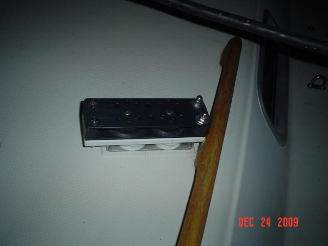

I have 4-line deck organizers both sides and run all lines back to cockpit on my '93 C30. Easily replaced the 2-line with a 4-line organizer. Making room for additional cam cleats on the starboard side is the only issue. Next trip to the boat I'll get pix for you........

Thanks Stu. I called Garhauer and bought (2) four hole replacement guides which will let me take 8 lines under the traveler and back to (2) four position rope clutches.
Thanks to all !!! Problem SOLVED.
