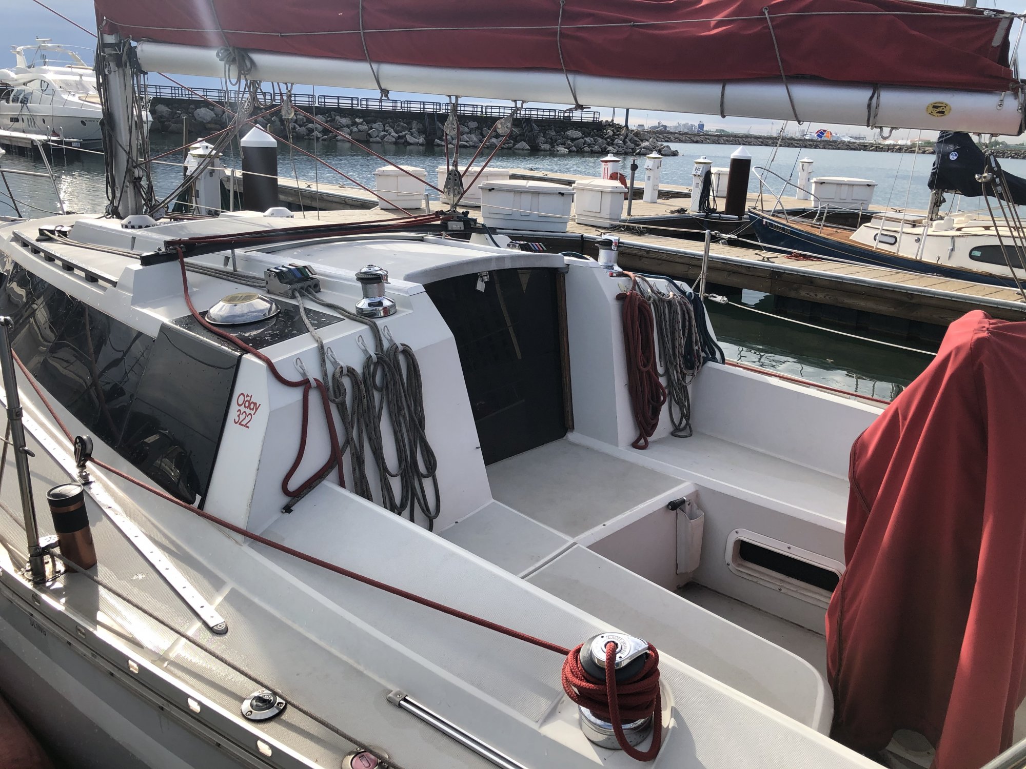

I think you have most of it…
turning block at base of mast, line organizer probably, clutch, and a winch.
You can see how my lines are run back to the cockpit in this shot…halyard is actually on the other side, but same setup.
Greg

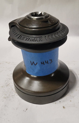

For the winch, you can get away with a small single speed winch….something like this…
Many boats have 1 cabin top winch, but I would go with 2…so you can have the halyard on one, and a reef line on the other when reefing.
My O’Day 322 came with something similar…I don’t remember the exact size… but I upsized my primary winches and moved my smaller primaries (2-speed) to my cabin top.
