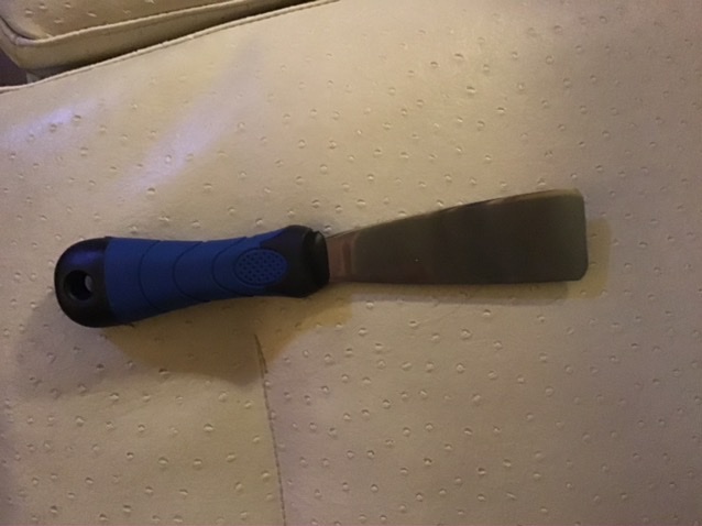

Cut holes in the headliner? If this is the headliner that is tensioned coated textile as on my Hunter, there is a better way. Pull it out of the edge where it is tucked in using a special tucking tool.
You can make your own tucking tool by using a flat painters spatula and rounding the corners.
Below is a picture of the one I made.

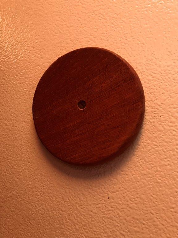

That is exactly what I did to mount our (pretty heavy) 6 person Switlik life raft on the foredeck of our P42. I cut the holes (4.5 inch diameter) through the liner. bolted the 4 inch footings for the liferaft holder to marine plywood backings w/sealant, then made four round teak covers that are about 5.5 inch diameter. I affixed the covers with a single wood screw into the plywood backing plate. It's been 29 years now without any problems.
