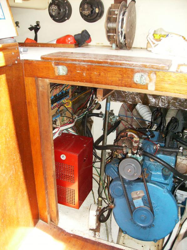

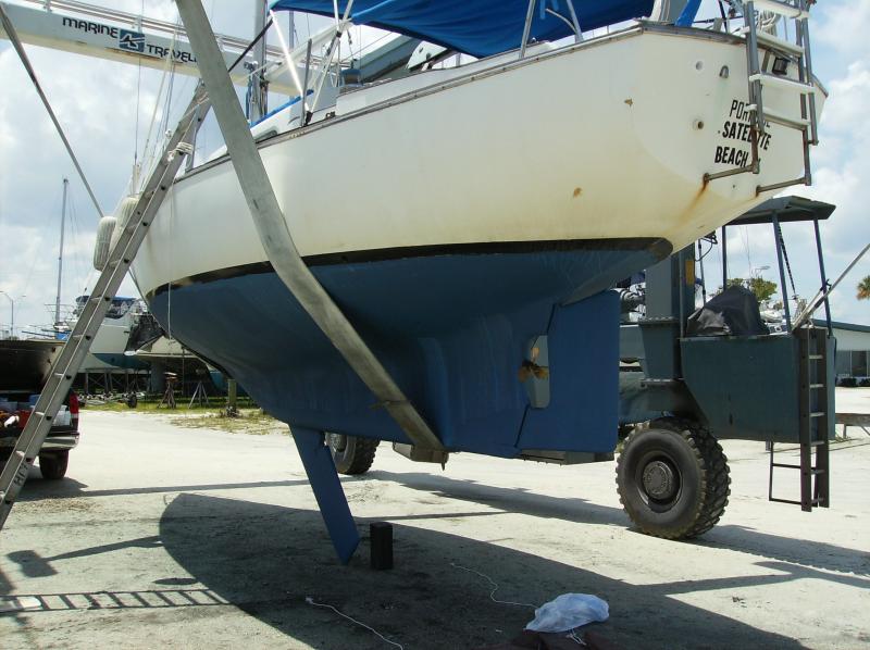

As Griz mentioned, the sole purpose of the centerboard is to improve windward performance. It's not heavy, my guess is fiberglass over wood, like the rudder. I attached a picture with the board down and another showing the dual-drum mechanism that raises the board. The wire braid pendant from the small drum runs through a bronze tube with multiple curves that exits the hull inside the slot in the keel for the centerboard. You can see the straight part of the tube descending between the charger (red) and the engine. It is a PAIN to replace this wire pendant if it breaks, so it should be replaced at each haulout if possible, by pulling the new pendant through the tube using the old one.
For what it's worth, I've had the boat almost four years and have never used the board as the water is shallow where I sail and the boat sails to weather quite well without it. I suspect the long keel projects a substantial lateral surface to which the board doesn't seem to add much.
