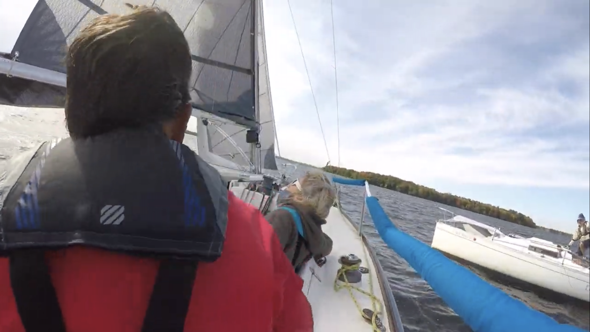

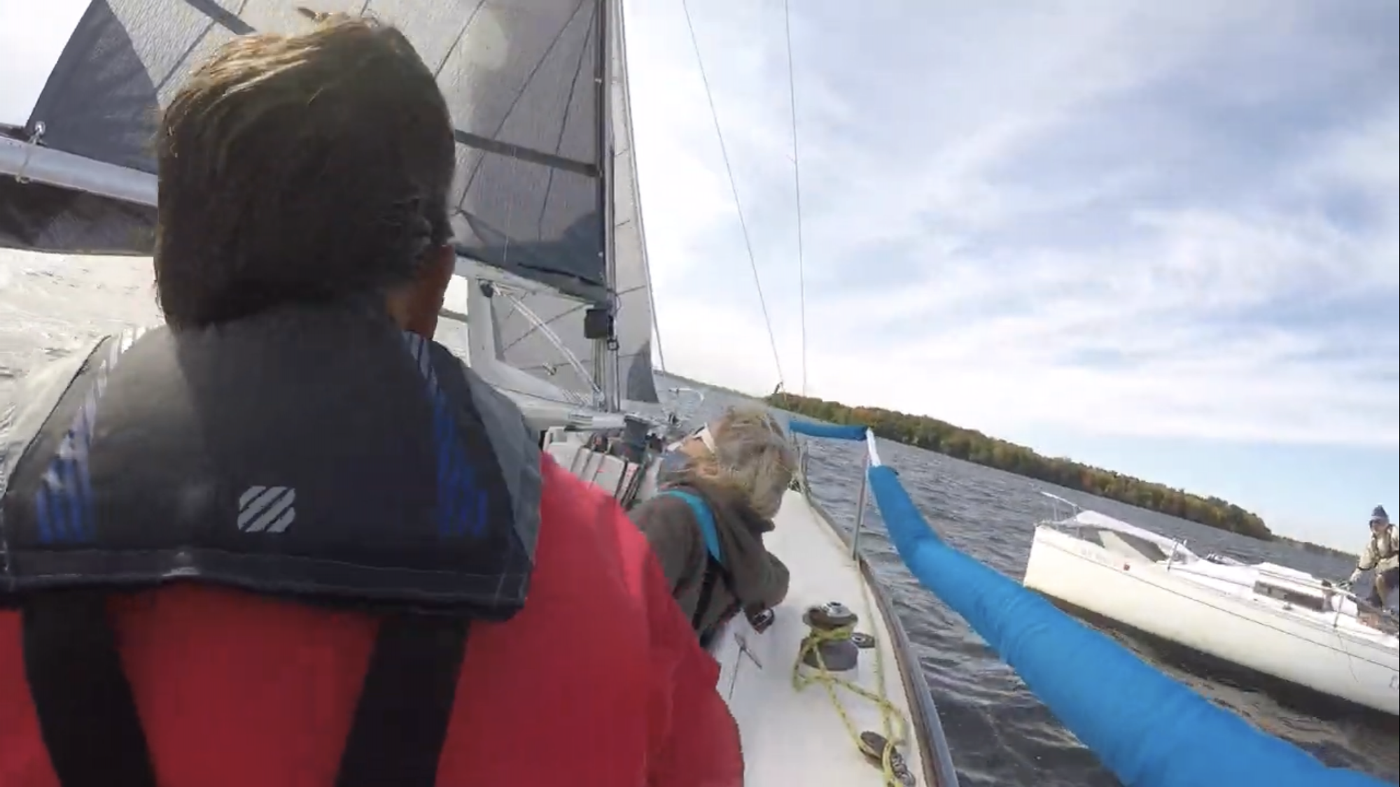

Jodi and I sailed in the double-handed fleet in the WYC Fall Regatta last weekend. 2nd day was breezy, hung around 20 all day. PHRF started right before us, and there was carnage; a collision in the pre-start; and then this right in front of us on the first upwind.
Sep 22, 2018
1,869
Hunter 216 Kingston
That looks like they aren’t having fun :)
I’m confused how their rig ended up on what appears to be the windward side?
Nov 8, 2010
11,386
They had just tacked, and then it fell to leeward. It was blowing 20+ knots, and the rig acted like a sea anchor. The boat swung around almost instantly.

WOW! looks fairly flat for 20 kts...

It does, couple of reason for that/.
The wide angle gopro flattens things out.
Starting from 8 knots when we motored out, wind had been building all morning (this was at 11:15am), so the wavetrain had not gotten rolling.
There was not a long fetch to windward to allow a bigger build.

The happy truth is that rigs almost always fall away to leeward, away from the typically windward crew.
I often describe it like being shot at and missed. Before you realized there was danger, its over.

Curious about how the demasting (or is it dismasting :) )happened? Looked like the mast broke near or at spreaders. Would that be too much load up high or perhaps a shroud let go and the mast broke during the subsequent reaction?

Strong wind does not cause dismastings. The rig is designed to match the righting moment of the keel plus a safety factor, past that the boat just heels. Missing rings, frayed wire and slipped spreaders cause 99% of them. In this case it was a missing ring, that allowed the pin to fall out of the lower diagonal shroud while loose and leeward. After the boat tacked, the missing lower on the new windward side allowed the mast to buckle at the spreaders.
But N.B. - The First 235 is known for having an under spec'ed rig. Sold with a babystay to help, it took two updates to the spreader system to fix the problem. Most 85-88 boats now have done the retrofit. This boat had the update, but nothing will save you from losing a lower.

We stopped and stood by. They were close to a lee shore, and in 80 feet of water. We offered our hacksaw, but they saved the rigging by unthreading. Ended up towing them home when their very nice OB failed to start.
