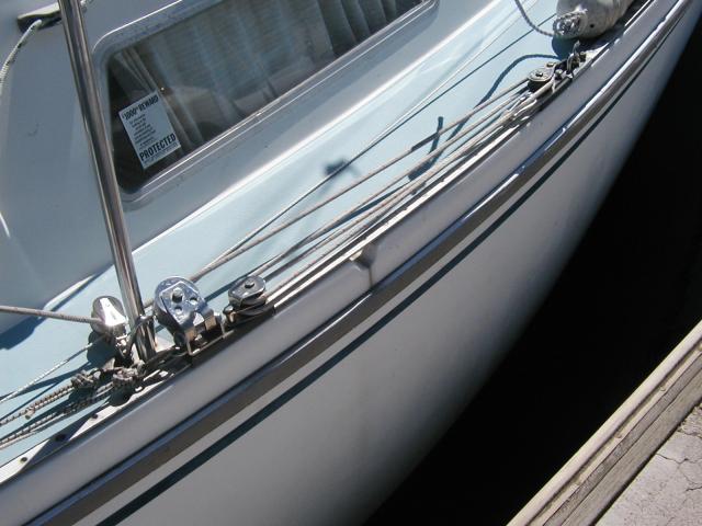

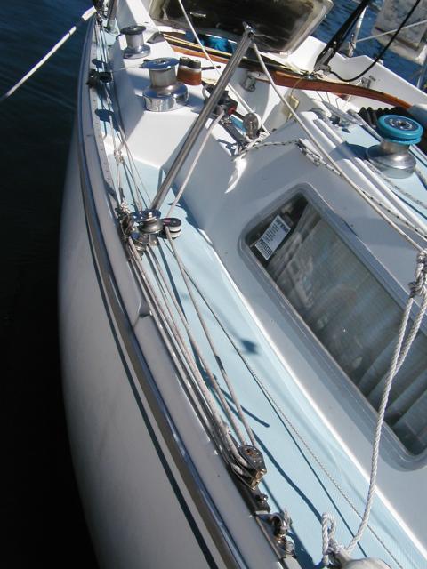

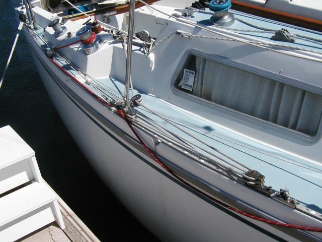

Alan has shamed me into adjustable fairleads.

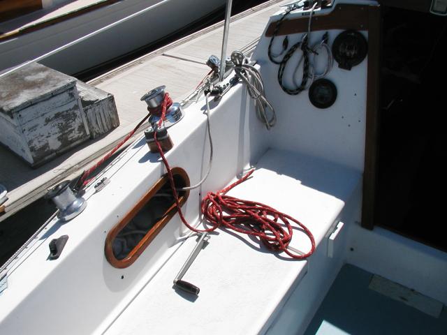

I was worried about extra lines in the cockpit, but since I put the traveler system in, Sue likes it a lot more than she did when I was commanding her (asking her) to adjust the pin stops.
So the genoa system is going to be next ... I'm wondering if it is better to lead the lines back to the helm or cleat them forward in the cockpit. I don't like the idea of lines draped across the deck in front of the cockpit because that is just begging Sue to trip on them when she goes forward for the sun

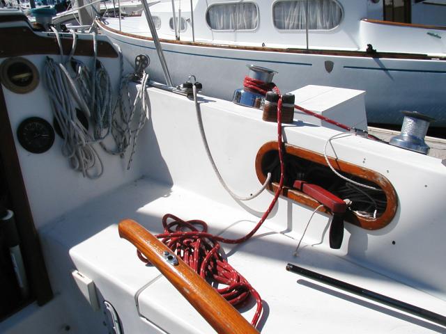

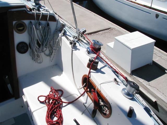

. If I can lead them outside the stanchions to the helm, that might be best. Maybe there is an intermediate point where I can set the cleat so that it can be reached from behind or in front of the wheel without being a nuisance either way. Then a real jib trimmer can adjust them if I ever got so lucky!
My winches are back by the helm and I find that when sailing alone (or giving Sue a much needed break from ANY sail trim duties
) it easier to release the sheet on one side and sheet in on the other from behind the wheel. If I'm alone, I often sit in front of the wheel to one side, but then move behind the wheel to tack or jibe ... it's just easier. I can even reach the traveler lines and adjust them from behind the wheel if I have them draped aft.
