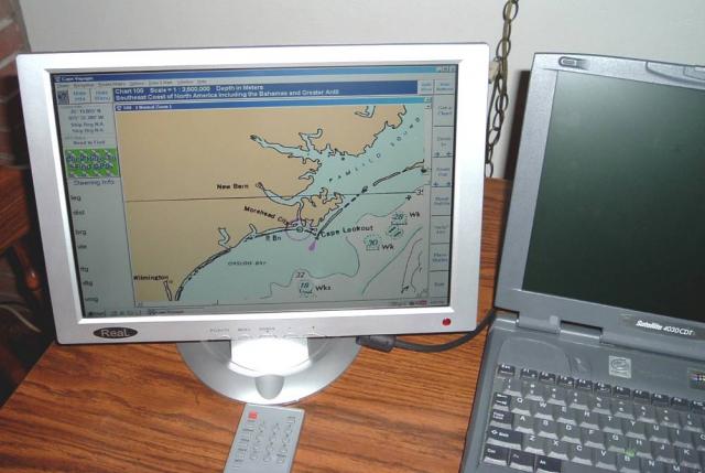

Your question about television is a good one and needs its own post I think. I paid too much for a flat panel back in their infancy. Nice for charts. Never found a way to get decent TV reception. We used a DVD player for movies, maybe twice between Erie and Tampa. Now with everything going digital I have no idea what people are doing.

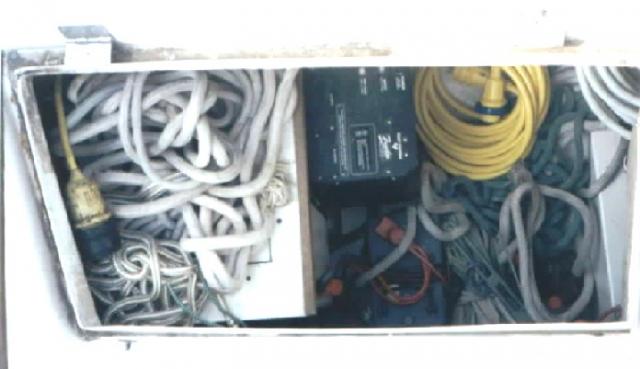

5,802
