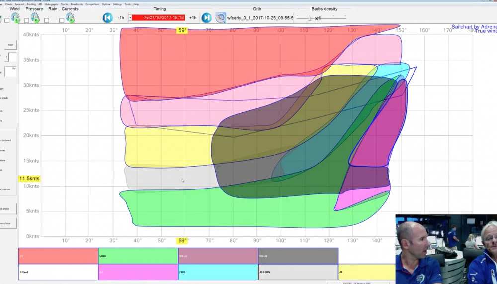

Here's a fun chart to show where it can happen. This is a Sail Chart, then shows what sails can be used in what wind speed and angles. Its actually a graphical view of VOR65 data that is fed into the weather router, so the SW can use the correct sails in its calculations. You can see the overlaps in the 90TWA ranges once the wind comes up.
8,008
I'm not used to reading charts like this but I'm interested in that all the sail combos start at a little over 30 degrees. I can't read the bottom which show which sail combinations correspond to the chart colors. But I find it interesting that all combinations provide close winded to off winded sailing at around 150 degrees. I'm used to thinking of upwind and downwind sails. But the yellow band, for example, is a very versatile set up and I would expect that to be used quite a bit. I guess the speed of the boats makes less of an upwind/downwind gradient analogous to the foiling catamarans.

In addition to this question, is that chart True Wind Angle? Can they really point to low 30's true?
Thanks, Dan
Thanks, Dan
Yes.
Well, all the jibs (J0-J3) are staysails, and the codes (FRO and MHO) sure can, thats shown on the chart. The true flying sails (Gennakers) come into play (as the chart shows) at a wider wind angle.
