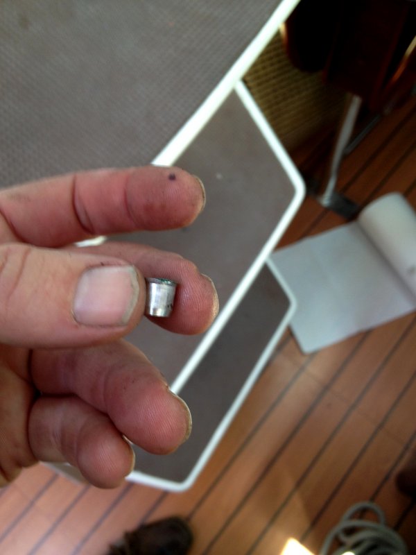

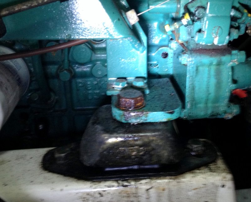

On Thursday May 12th at 12:06 PM I get a panicked string of text messages from a customer with a Beneteau 36.7. There are 7 photos of his engine with oil everywhere. Boat was launched, commissioned, sea trialed, run to temp levels checked etc. etc. and all was fine. After sailing from the boat yard to his summer mooring he fired up the engine to motor into the mooring field. It was blowing stink when he heard a screeching racket, said it sounded like a wrapped floating line on the prop, and then about 20 seconds later the engine alarm went off. He immediately shut down the engine, re-hoisted the sail, and sailed onto the mooring.
When he opened up the engine bay there was oil everywhere. The engine, for no known reason, or no good reason, spit out what is called a "casting plug" from one of the oil journals. This is NOT a freeze plug in the antifreeze circuit, it is a casting plug in the oil circuit.. This low hour engine had been impeccably maintained using not only Volvo filters but Volvo fluids as well. It was also maintained at far earlier than factory suggested intervals.
When the casting plug came out it caused the oil pump to literally pump all the oil straight out of the engine, at cruise RPM! Once the engine was out of oil, any oil lubed surface were destroyed before he could even shut down the engine. Cylinders, pistons, crank bearings, cam, valve guides etc. etc. on and on. Of course at this point he had no idea what had happened. While cleaning up the engine bay he found the casting plug. It was then we realized what had happened. It took weeks to get a hold of anyone at Volvo who would return a call or who could tell us how or why this happened. We spoke with nearly every Volvo dealer in the US and some in Canada and not a one of them had the casting plug in stock but a few had seen this happen.. The owner paid for expedited shipping from Europe, shipping being nearly 15X the cost of the part, and "Volvo expedited" still took six weeks.
Volvo response to owner:
"Not supposed to happen, and never has."
"That plug is stainless"
"Engine is probably still be fine."
The casting plug is specified as stainless steel. Into a cast iron block? Okay...
The actual plug was soft aluminum. Into a cast iron block? Okay..
The replacement "expedited" casting plug was also soft aluminum, NOT the "specified" SS nor machined from the same cast iron as the block. Heck even "low tech" reputable boiler manufacturers machine the nipples, that hold the sections together, out of cast iron so they expand and contract at the same rate..
So now, six weeks "expedited" later, we have the casting plug installed. We change oil & filter and carefully fire up the motor. The motor starts but is billowing blue smoke. Wait for it to burn off, like a worn valve guide might, nope. She continues to billow blue smoke.. The engine is not only smoking but sounds a bit off too. Compression tests reveal what is to be expected, low compression.
Owner needs a new engine. No problem this engine was still in production in 2006, less than 10 years out of production, we'll just order you a new or re-manufactured long block and you'll be on your way in a few weeks..
WRONG!!! Volvo never even offered a long block for the MD-2030 even when it was a current production model. Volvo also does not re-manufacture or know of anyone re-manufacturing these engines. Kubota & Yanmar are easy to find, rman or new Volvo MD-2030 long blocks simply don't exist. MD-2030 long block? There is no such creature.. Amazing fail on Volvo's part.... How do you build an engine and not have a long block available?
