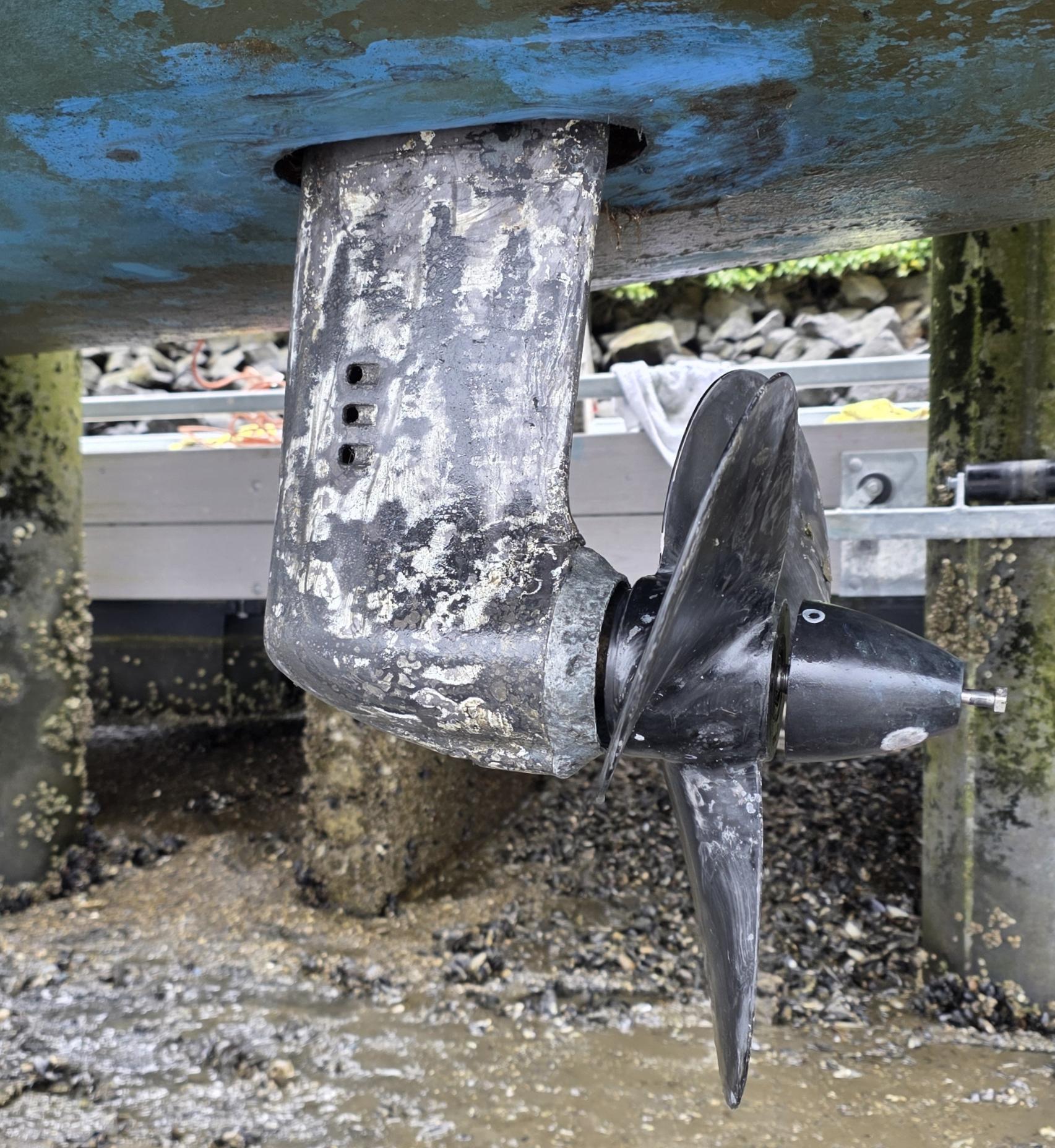

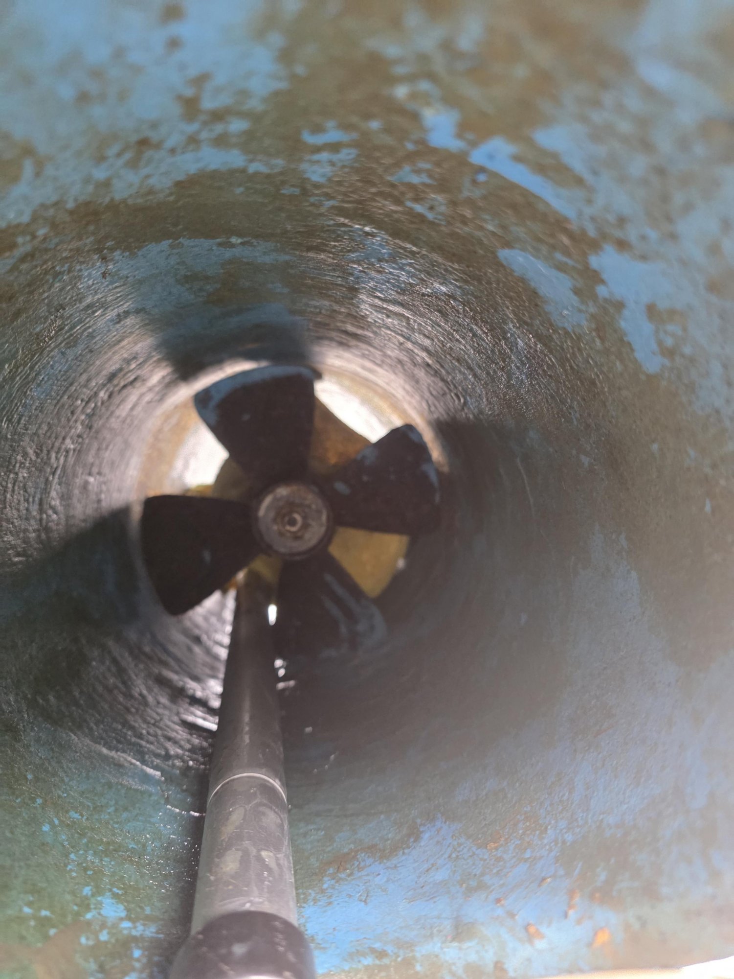

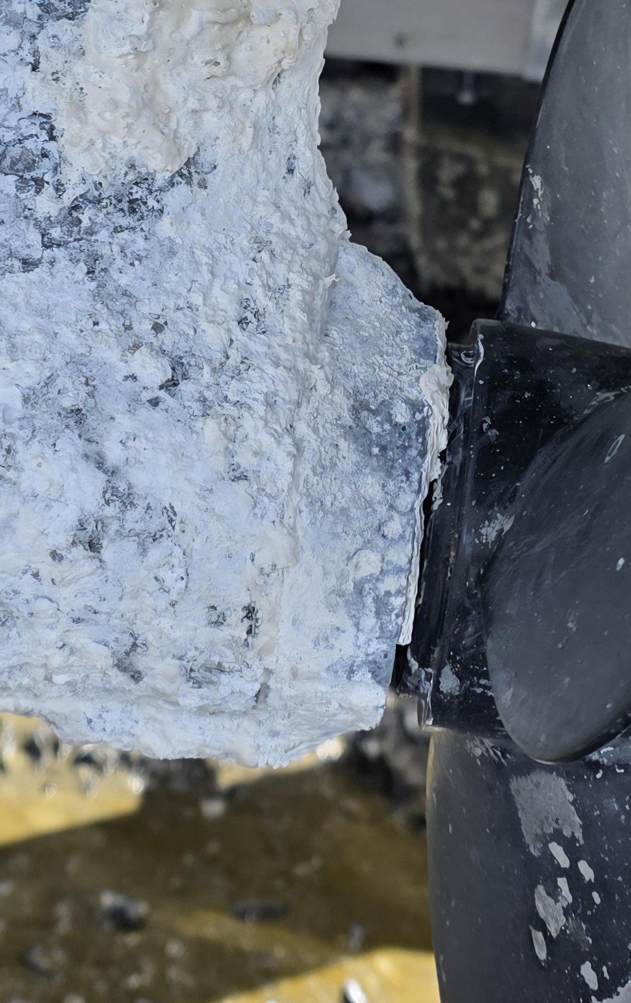

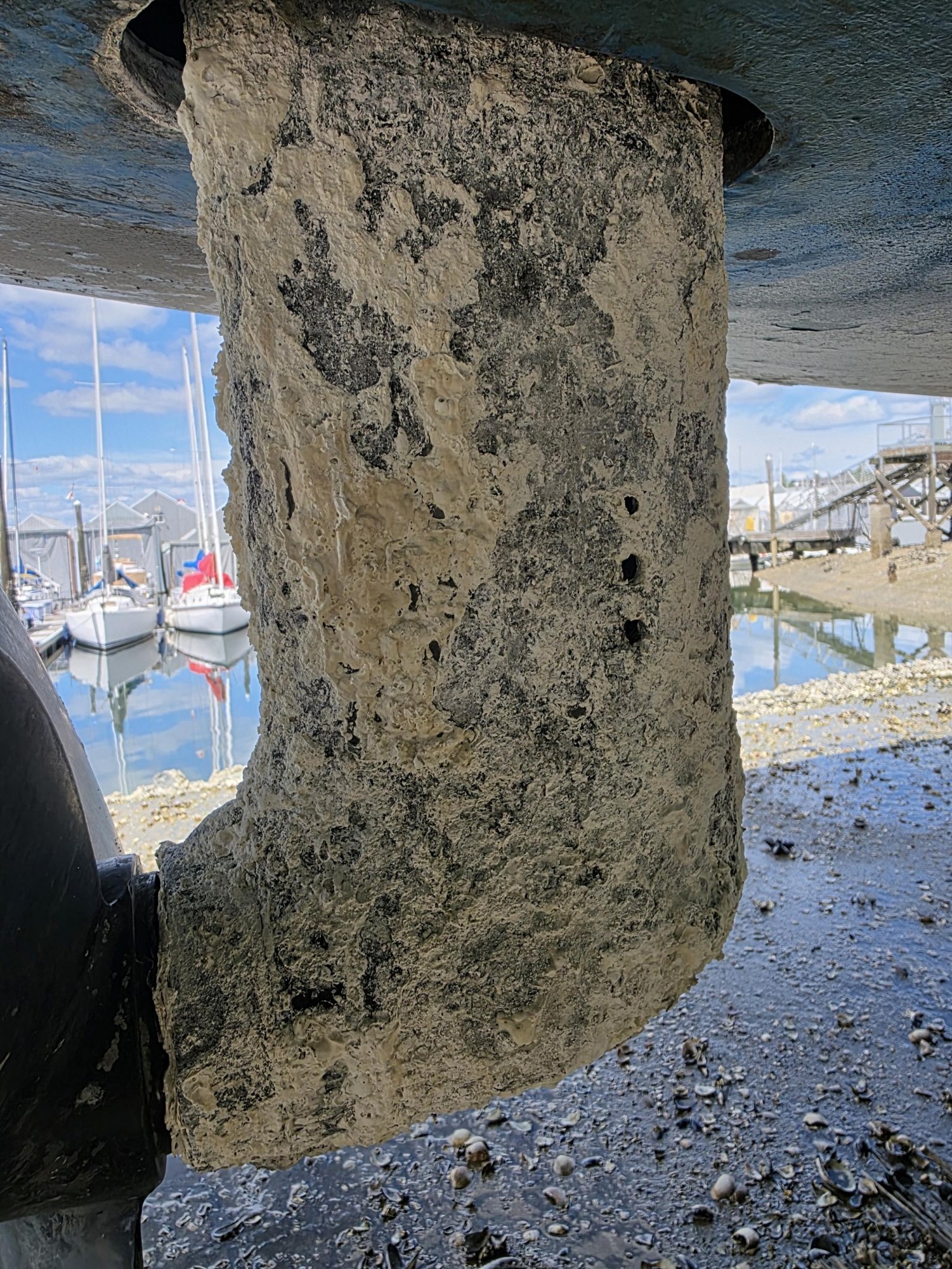

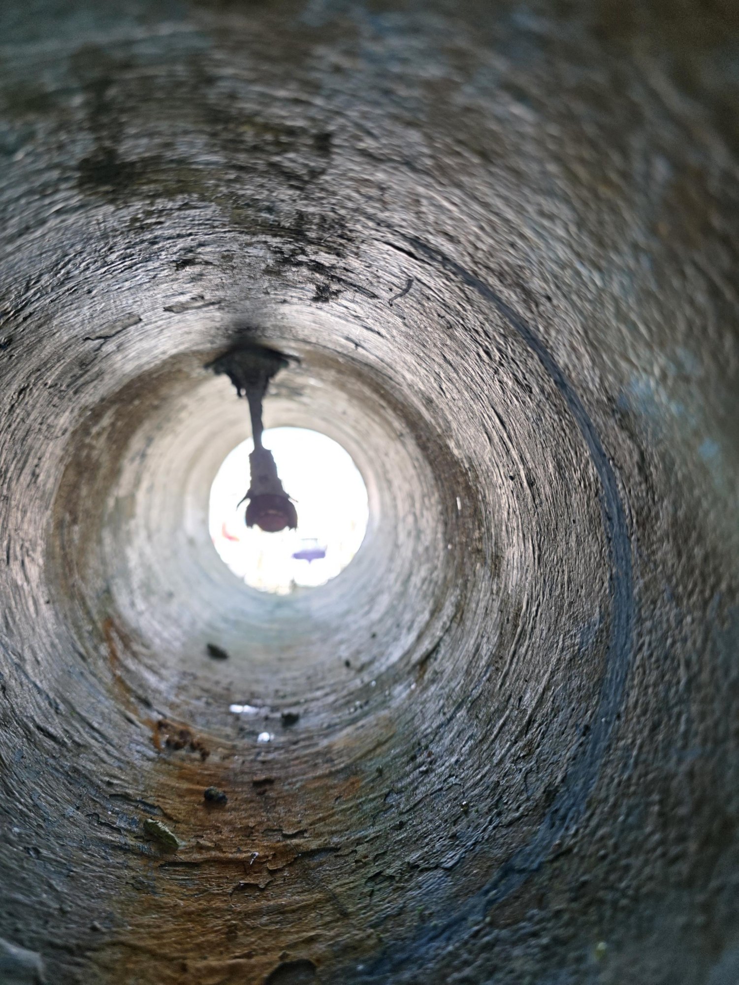

2004 Bavaria 41 with Volvo D255 and sail drive. Problem free for 10 years of saltwater ownership. Put on Grid May 19th to inspect bottom. Minimal sail drive growth and zinc appeared well connected to sail drive. Had trouble replacing bow thruster zinc so left it bare. Bow thruster has no 12v except when relay delivers 12 volts. Tried bow thruster June 2 and nothing but humming motor, no thrust. Back on grid June 3. Bow thruster visualized, support dissolved and prop lying in tunnel. Sail drive white with Al oxide corrosion. Pitting of metal notable but may be smoothed by sanding or grinding.
So what would you do? What might explain aggressive attack in two weeks in slip??. Boat tested by two engineers with silver chloride reference. All voltages ok. No explanation. Galvanic isolator installed in 2016. No ground wire current. Is Sail drive worth grinding? Insurance Geico has no mention of galvanic damage sudden or not in policy review.
What ideas here on sudden attack ( now all fine) and choice of how to handle sail drive damage?
