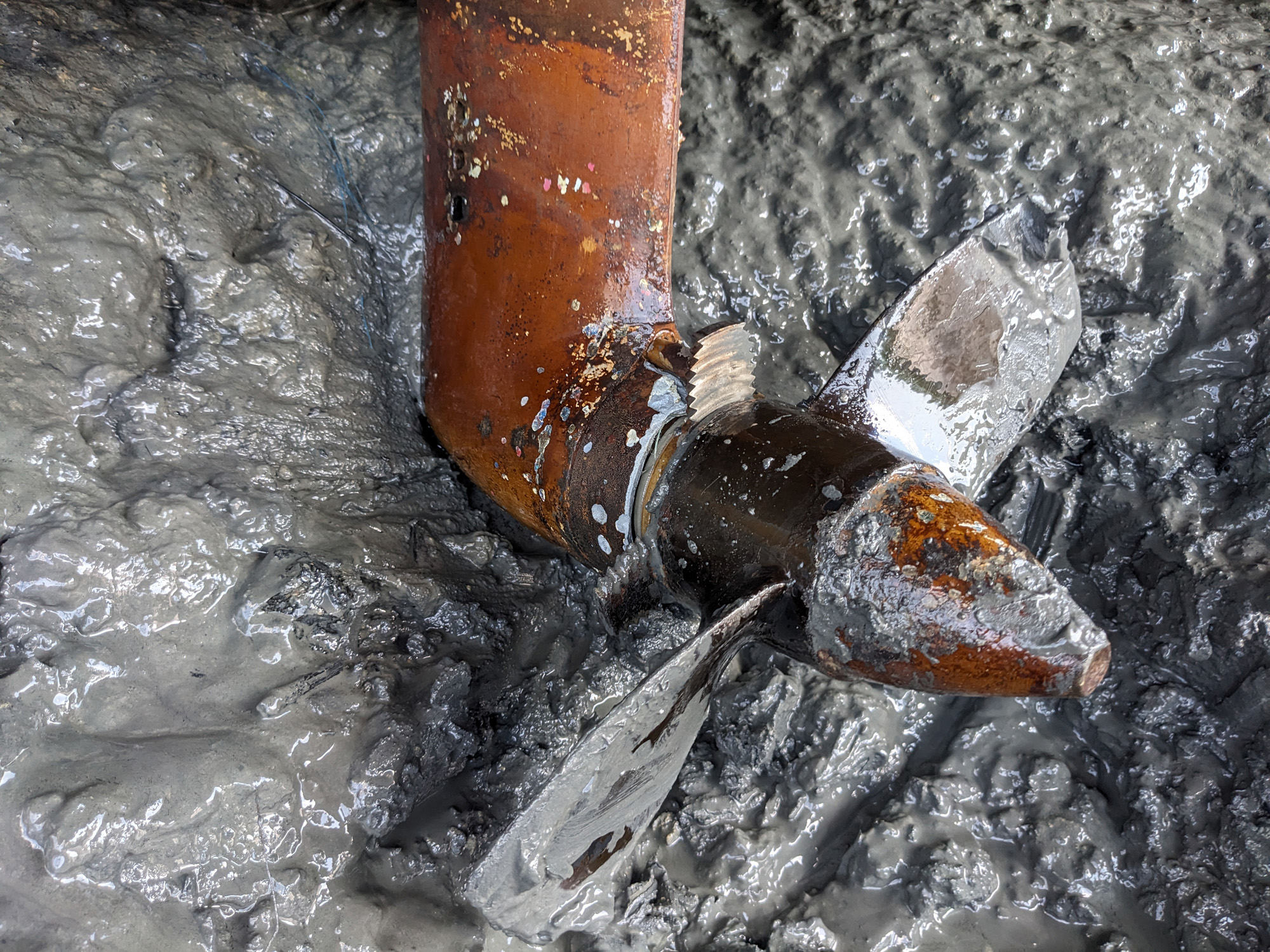

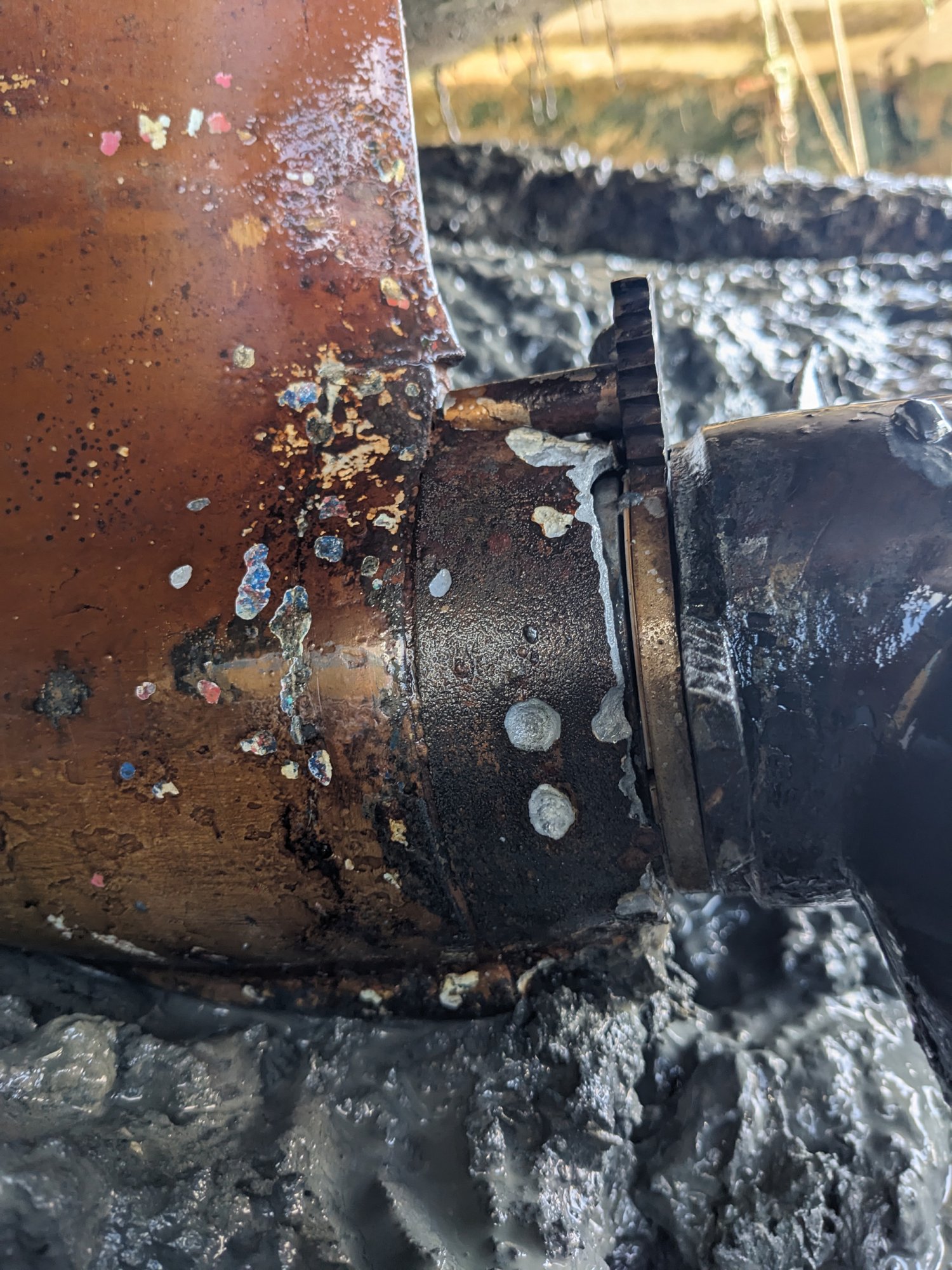

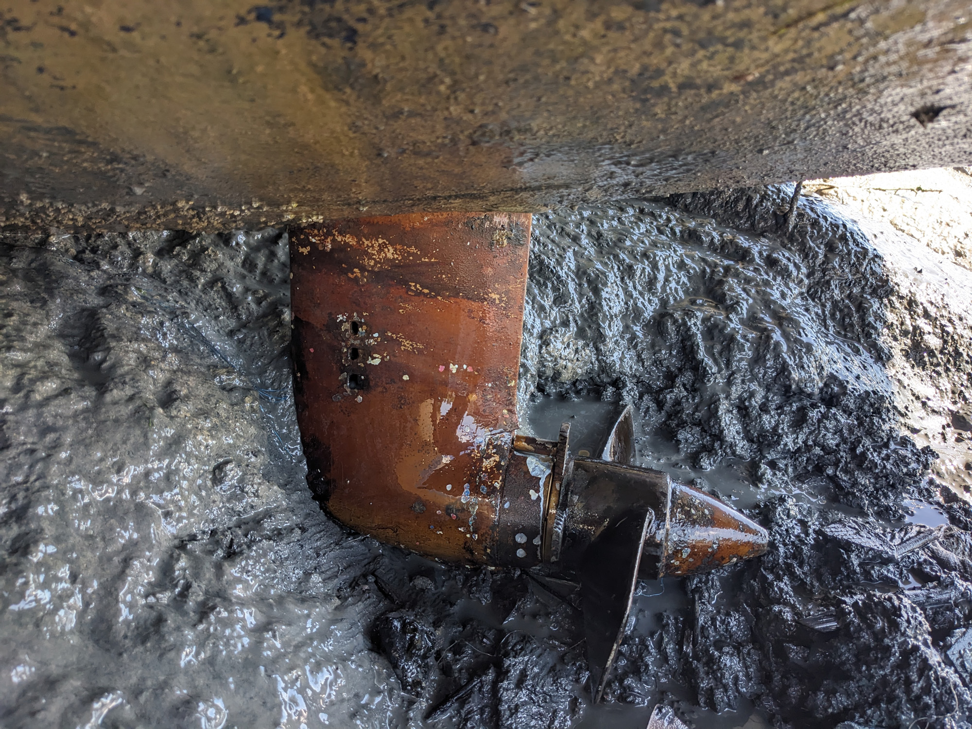

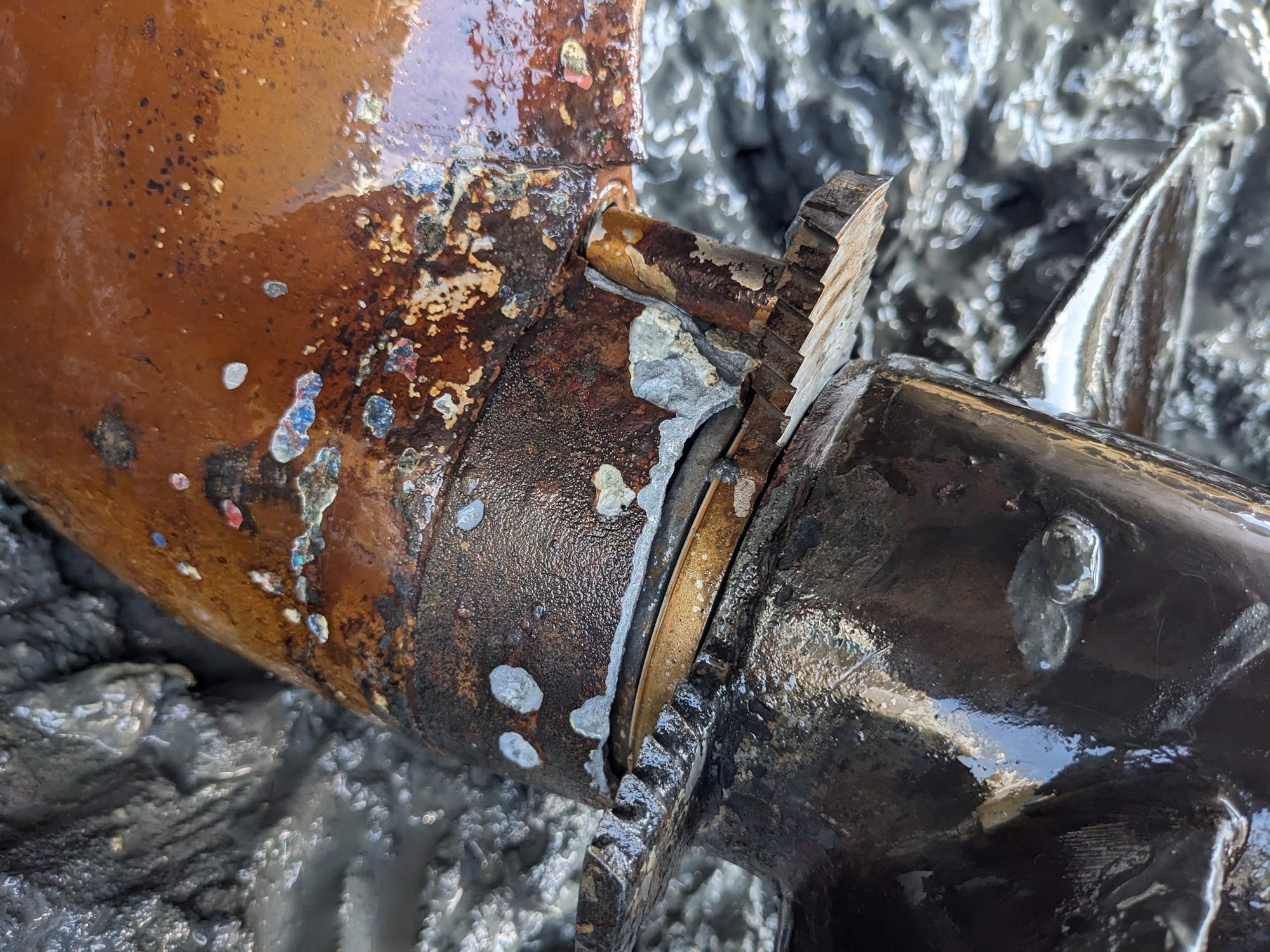

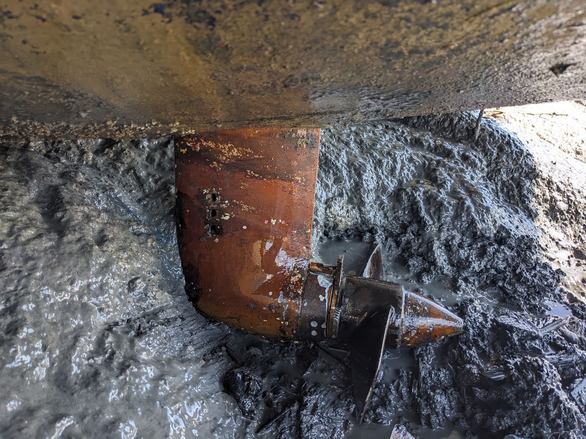

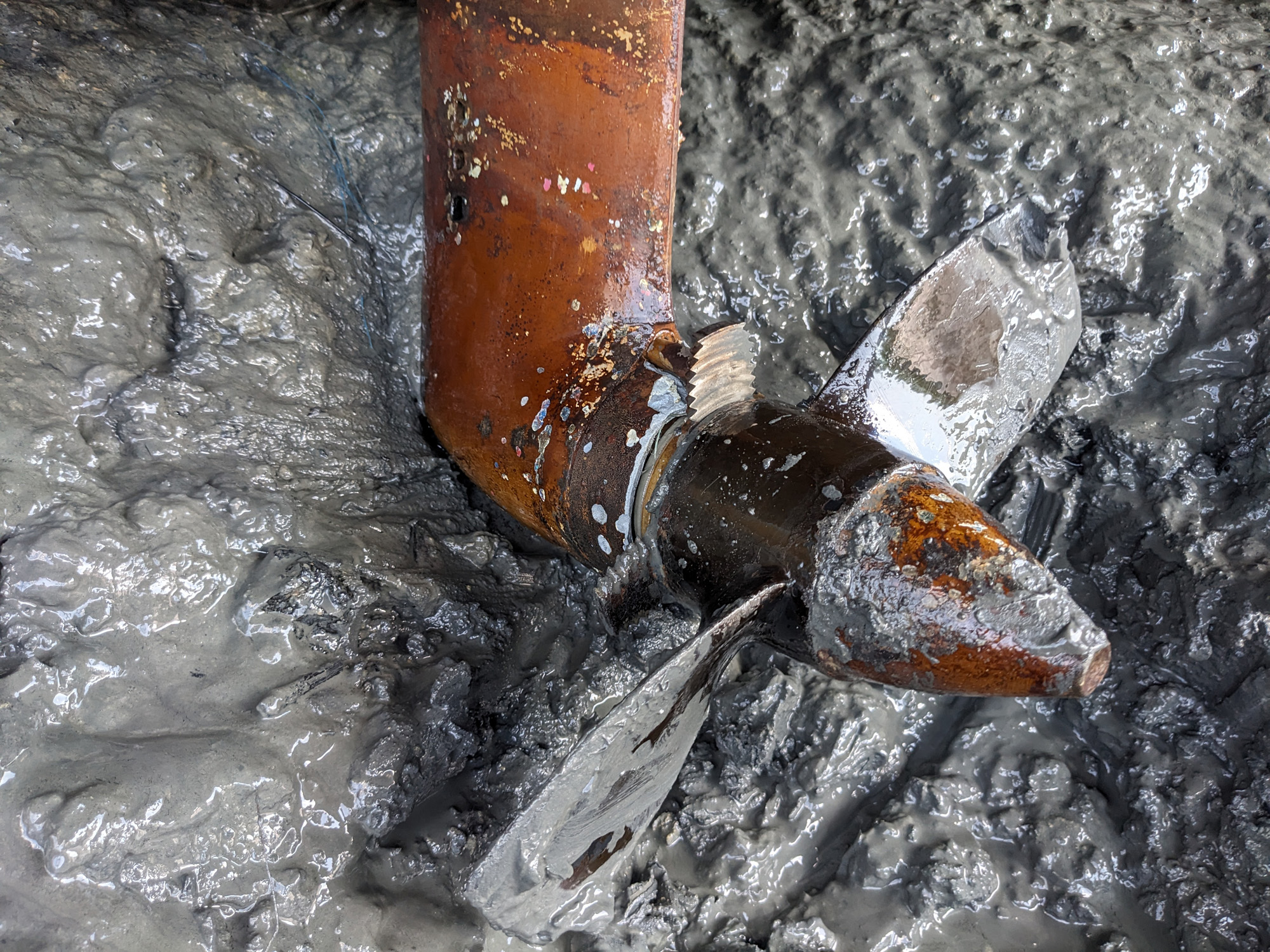

Hi there,
I am looking for some advice on an issue that has just started to happen with my Volvo Penta MD7A / 110S Sail Drive.
I’ve been regularly starting and running the engine over the winter and getting the boat ready for the summer season, and a few weeks ago I noticed a clunking sound that was coming up from, I think, the sail drive leg.

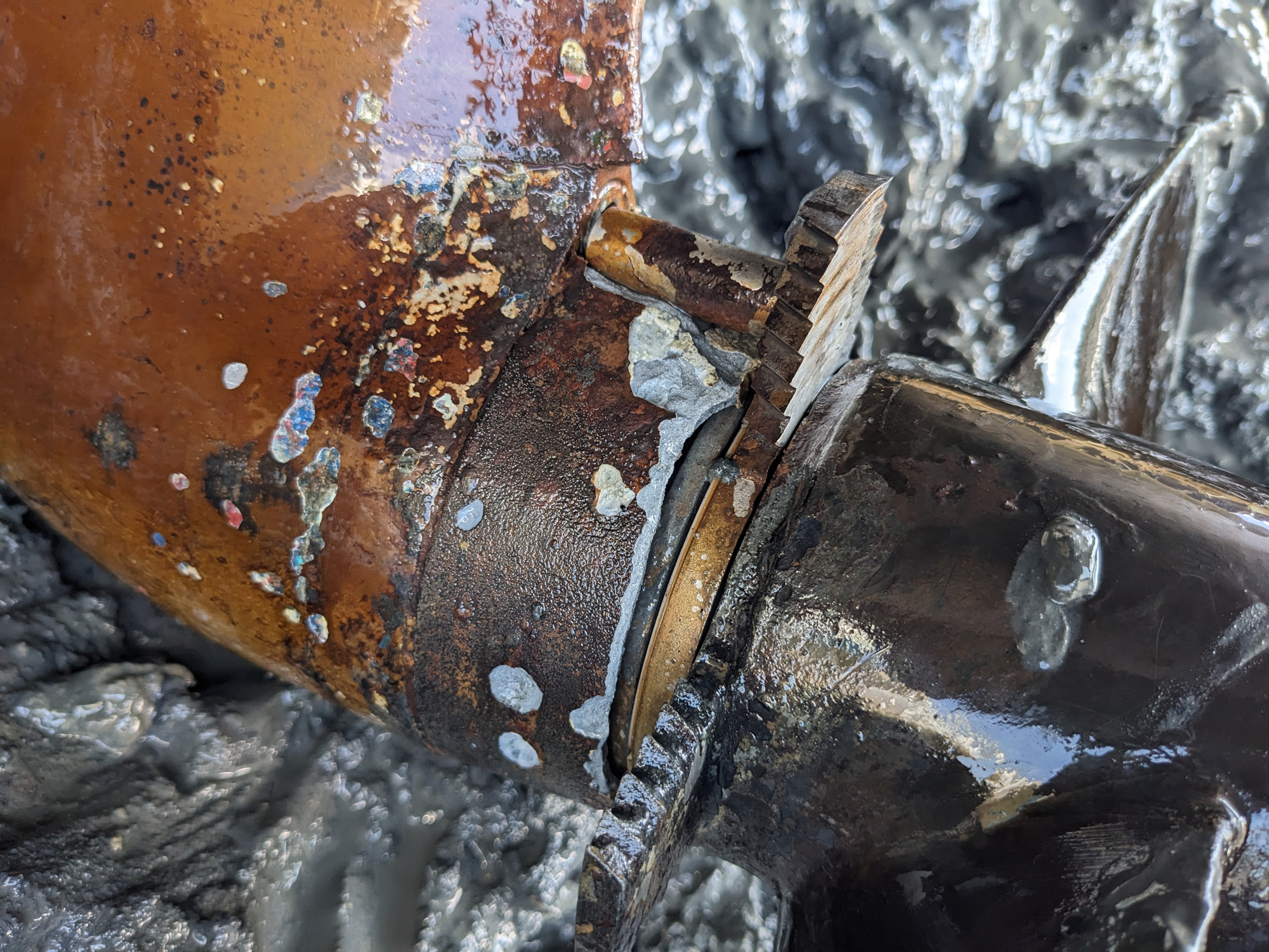

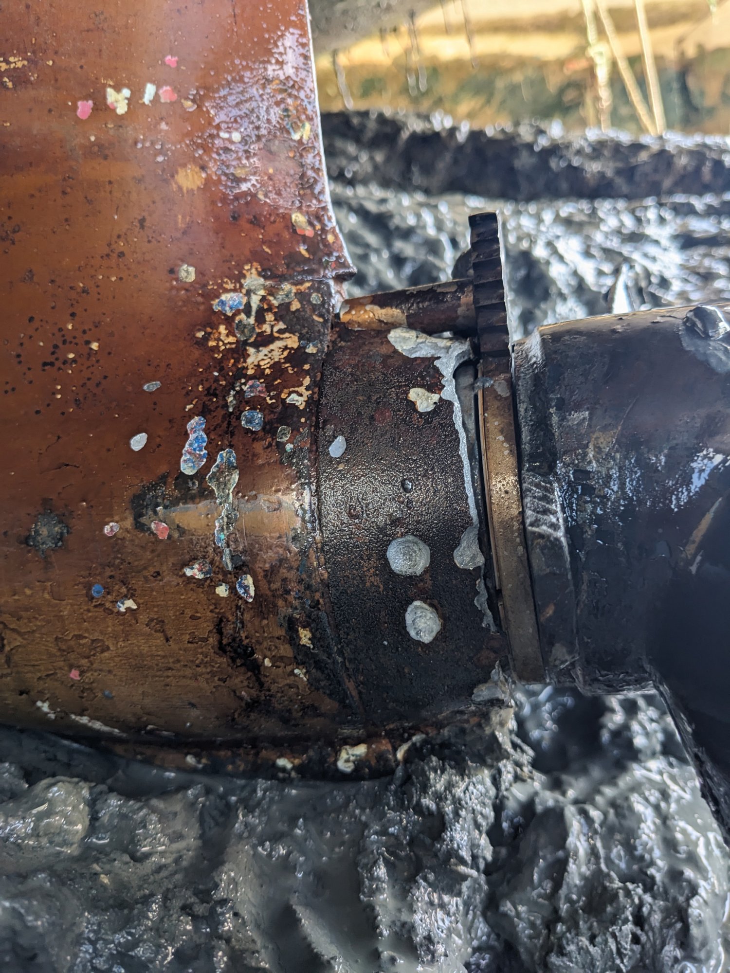

The clunking appears to only happen in forward gear; I have not yet been able to replicate it in reverse. The last time I ran it, I had it in forward gear for about 4 minutes before the clunking started happening, whereas previously it'd happened within a minute of being in gear. I thought maybe the prop or roper cutter had come loose, or maybe something was wrapped around the prop. In order to rule a few things out, I went under the boat to look (she sits in mud at low tide). Other than it looking dirty and needing a coat of paint and maybe a new anode, everything looks ok, or so I believe. I’m no expert with boats or engines, so please correct me if you see anything alarming in the attached photos or videos. When in gear, the boat does move forward, so the prop is turning okay, although it might be losing a bit of power. It's hard to tell as it’s only a 13-HP engine and tidal, so getting a true gauge is difficult. The sail drive oil is at the correct level and looks very clean. Engine oil is also at the right level and looks ok.
Here are the videos that show the engine running and the prop movement. PXL 20240512 121435312 LS - PXL 20240525 083952046 LS
I am at a bit of a loss for how to find the cause so that I can fix the issue. If she needs to come out of the water, I would ideally like to know what I am looking to fix or order beforehand. Any help would be much appreciated.
Many thanks for looking.

The collar between the line cutter and the lower unit appears to be broken. I'm not certain of its purpose, if it is a part of a seal it may be allowing the gear oil to leak out which could cause the noise you are hearing. Just a guess.

Did you check the transmission fluid? The transmission sounds dry.
I checked the dipstick for both the sail drive and engine and both look fine and are at the right levels. I did wonder if I can get a better look if I take the top of the sail drive unit off. I wasn't sure if that could cause me more problems.
