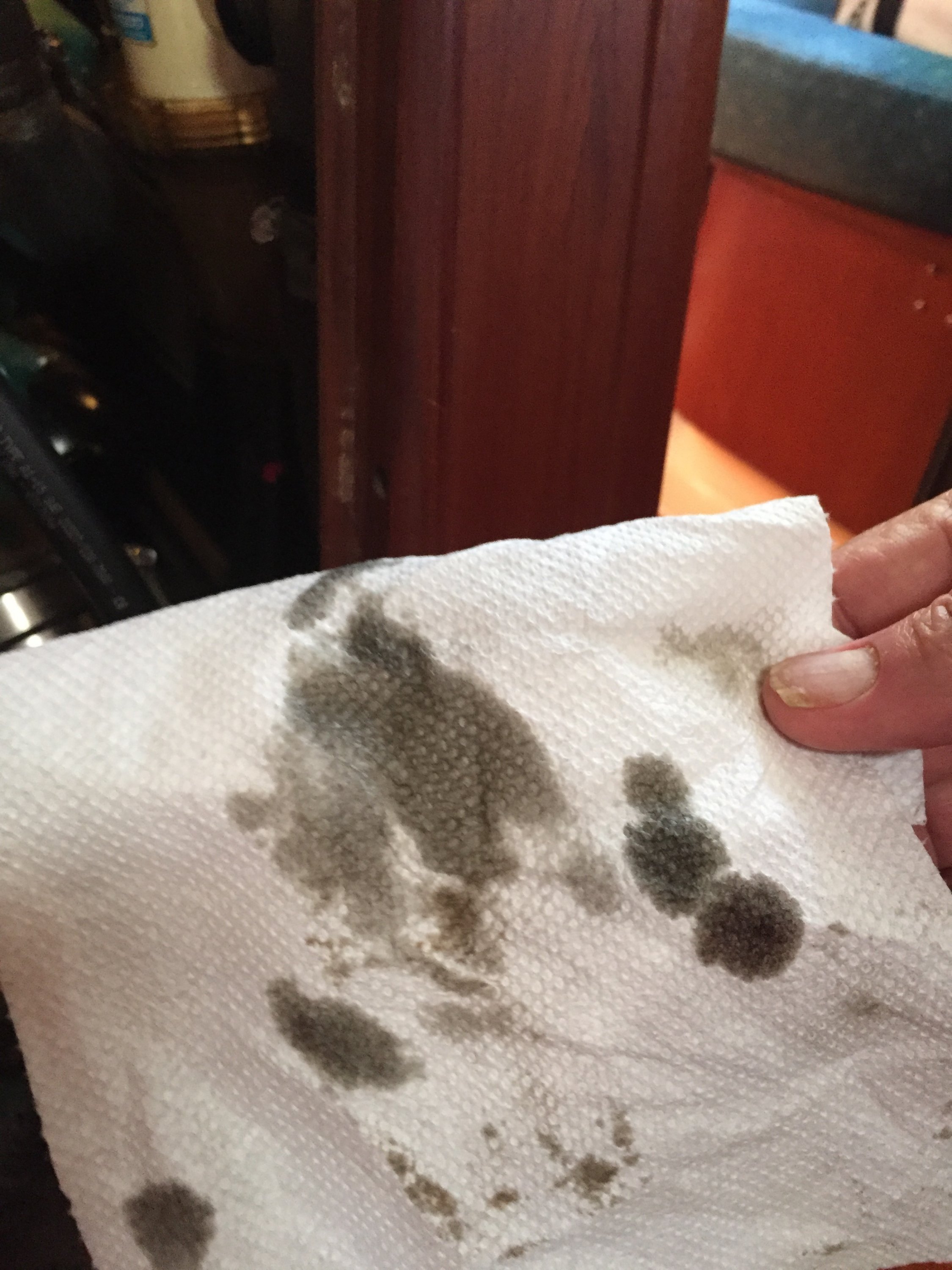

My MD22L has a reverse gear which supposedly requires just VP's own brand oil at $50 a quart!:yikes:
I check my gear oil every 3 months and for the first time found it to be "Burnt" but still had lubricity.
@Rich Stidger has the same engine and we have been chatting in a private message about the required GL5 synthetic oil required by the manual, 5/8 th of a quart.
SAE75W-90 Full Synthetic.
I proposed a more Heavy Duty oil for the higher temperature waters here on the Gulf.
Rich convinced me, no hard to do because of his top notch reputation here on SBO, to go with the manual instead of this...
http://www.truevalue.com/catalog/product.jsp?productId=41238
SAE85W-140 Full Synthetic
Any other thoughts on why not Heavy Duty?
I had mine changed in Punta Gorda 2.5 years ago. I have the remaining VP oil that looks light yellow and less lubricity than Mazola corn oil. I wonder if I been using a VP outdrive gear oil and not their inboard drive gear oil.
This has just happened with no particular strain on the gear.
However, recent max hull speeds sailing had my prop spinning very rapidly, but gear was supposedly in the Neutral.
What this might do is rotate the unengaged gears without the normal sea water oil cooler running. :confused:
Any thought on the change in oil condition?

I started the thread, wondering why my Gear Oil had quickly gone dark or "burnt" looking.
Then I pondered how much gear box Frictional heat was being added by my propeller. when spinning rapidly at near hull speeds.
I have referred to Drag buy common fluid dynamic terms.
Not meaning an boring date, inhaling a tobacco product, or the feeling I am getting about this thread switching to Helicopters.:rolleyes:
But IMHO any discussion of any thing in a thread is OK. You have control to read or not read any updates.:)
___________
I am now perfectly clear that the propeller's spinning energy driven by my boat's forward motion...
Will ADD more heat to my gear box oil than a non spinning propeller.
This is a separate thought from Speed over Ground reduction.;)
Jim...
