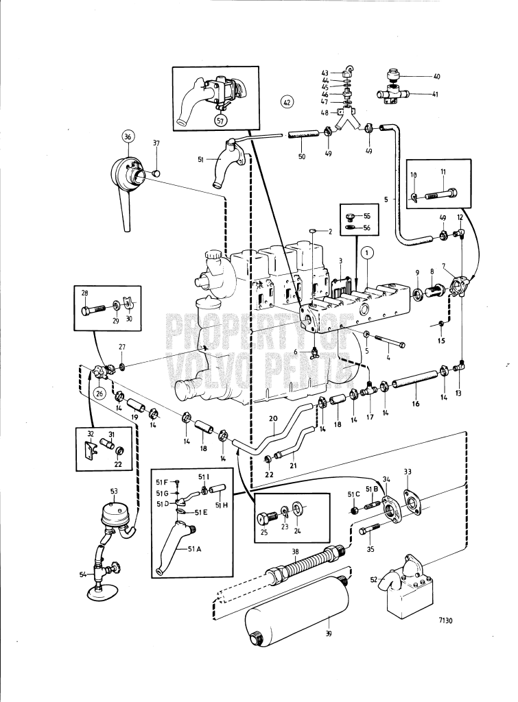

This is the most likely set up for your MD11C
To find the issue, you need to trace the water flow from part #54 to the exit of the boat thru Part #57.
Your water pump = #26
Part #1 = Engine hot AntiFreeze to cooling water heat exchanger.

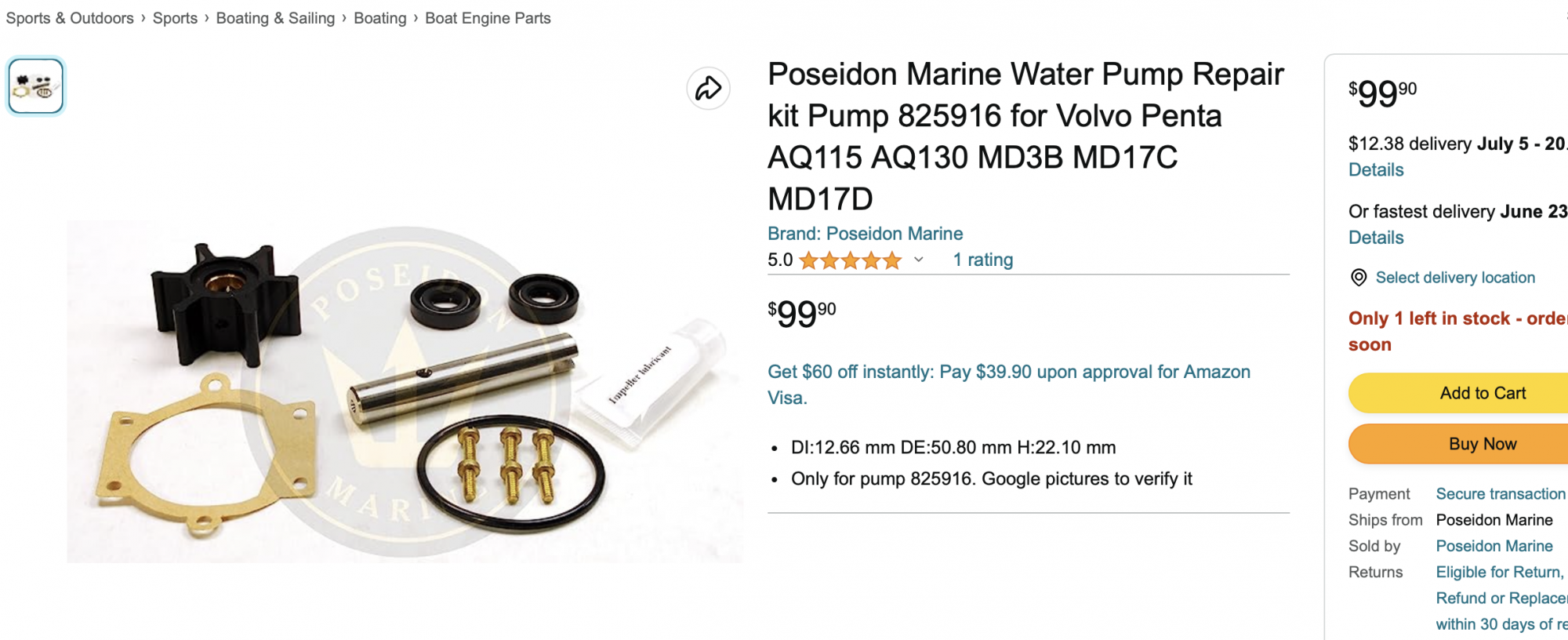

I picked [guessing] the part ID 825916 for water pump #26 and did a web search and found this.
The heat exchanger may hold a few nasty surprises.
His best guess and mine too.
The Black Star Item is the water pump impeller. If not changed often, it breaks up and restricts the Inlet to the heat exchanger.

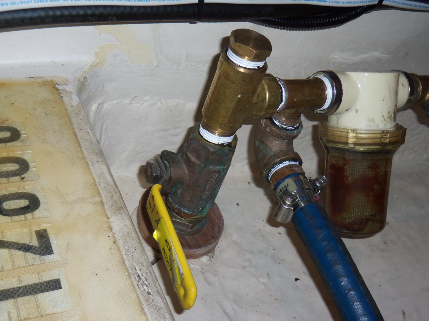

A thought for when you are hauled, see if you can alter your piping to fit this arrangement :
Very briefly : to clear your inlet, unscrew the plug, attach a clear vinyl hose and stand vertically, open the valve and rod with a 1/4" wooden dowel.
