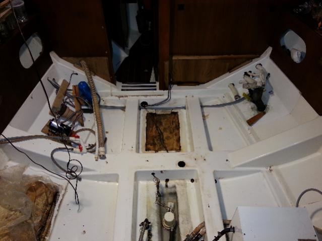

The liners have the holes drilled throughout the boat already.
Dec 2, 1997
9,011
- - LIttle Rock
Good...'cuz it didn't look like there were any in the earlier photo...and Hunter has been known to forget to put 'em in occasionally.
Btw...every one of the hose connections in this last photo should have TWO clamps, not just one...with the screws 180 degrees apart.
