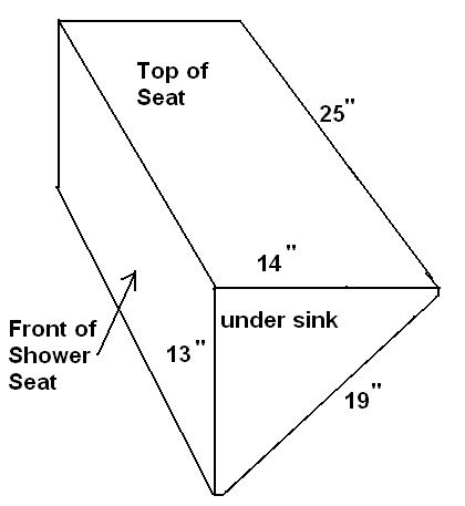

Hi Ed! ... I just ripped my holding tank open from the side under the sink. I found a one inch diameter hole in it! Instead of going with the idea of a new tank under the aft berth, I went "green" and got a composting toilet ...
The tank didn't want to budge (don't know if it's strapped in or what). So I sanitized and scrubbed it. Not as nasty as it sounds since it was bone dry and drained through the hole in the bottom. I then lined the tank with fiberglass reinforced plastic (bought a 4x8 sheet at Home Depot.) So now the tank is encased in plastic so I can't give you the exact measurements but if it's any help, I'll get the best measurements I can next time I'm down at the boat (couple of days).
UPDATE .. attached a pic with rough dimensions
