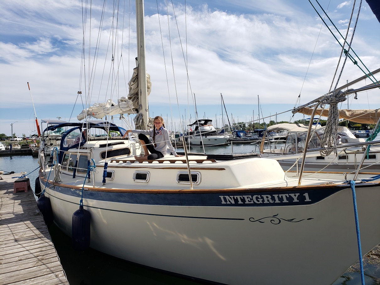

The blue stripe under the toe rail on my boat needs to be refinished. I was planning on painting but someone suggested using a vinyl wrap instead of paint. This seems to be more and more common and there are companies that wrap boats but this seems like a fairly simple surface to wrap so a potential DIY. It sounds like it is more durable than single part paints, maybe as durable as two part. It's not cheap, probably as much as a good quality two part paint. A wrap opens up some more possibilities for colors and textures as well.
Does anyone have experience with boat, or car, wraps and how well they hold up to the environment?

I want to re-finish the wide blue stripe which is about 6 inches. The hard part will be colour matching the cove stripe under it.
24,772
DArcy. The crew aboard looks about as happy about the boat as Dad is thoughtful about the color of the stripe.
If an exact color match is the control then choosing the wrap method seems to drive the need to wrap both stripes. Not sure how that works.
Or the old school paint method will address the issue. Perhaps your crew will discover painting talents perfected on the boat.
Another but likely shorter term solution might be a vinyl stripe similar to the material used for boat names. It would likely need multiple crew members working together to apply such a long stripe. Cost for the material is lower just not sure they manufacture such long stripes.
