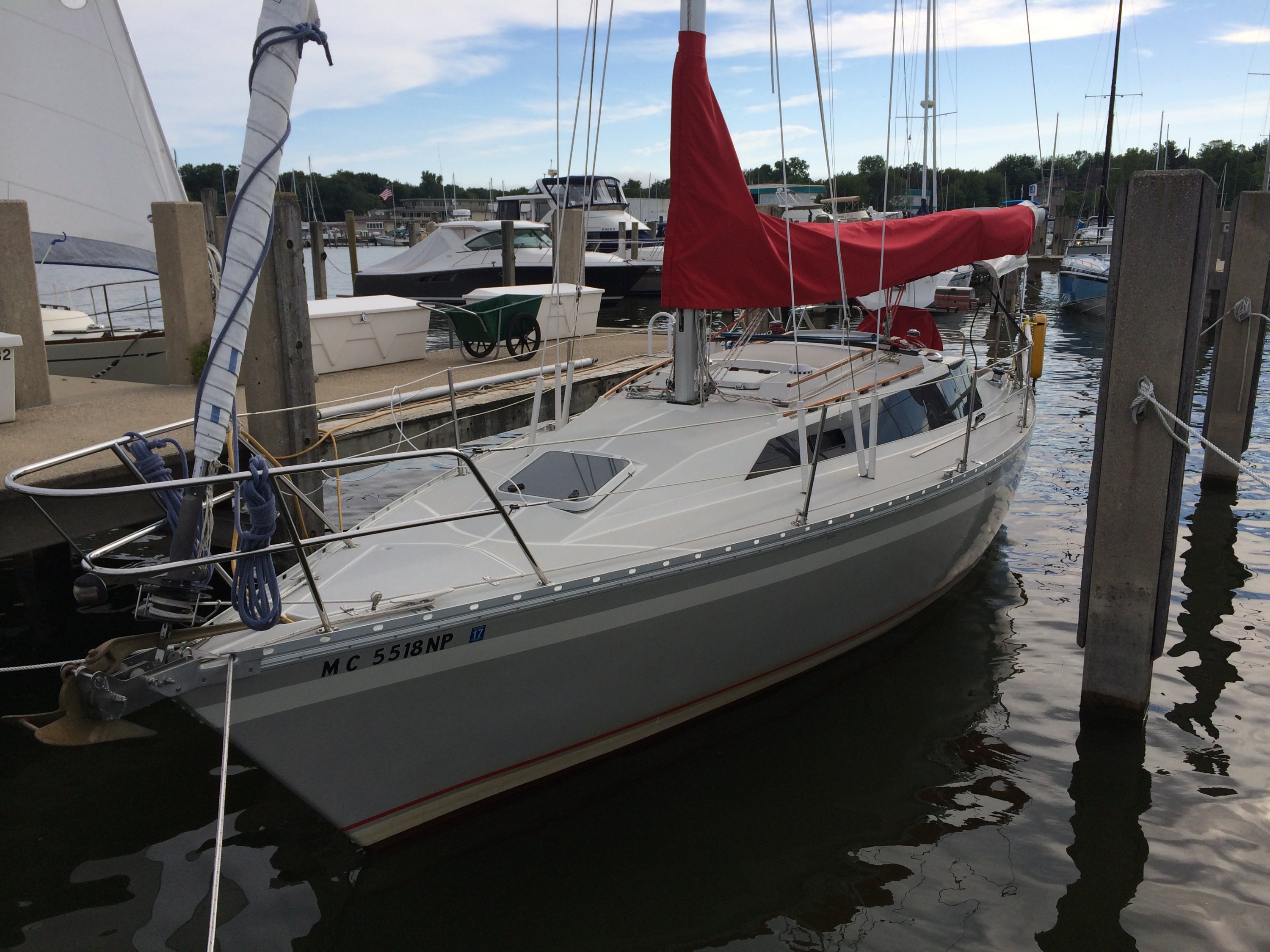

My genoa and its sheets rub on the shrouds when tacking so I put those split vinyl tubes over the shrouds to protect the sail. I'm now worrying this will trap water and cause corrosion. Anyone have experience with this?

I've owned a Hobie cat and a 14 foot double ended sailboat but this O'Day 28 is the first real sailboat I've owned. My first few sails revealed the knots used to tie the sheets to the genoa were hanging up on the shrouds when I tack. I tried to solve this by splicing eyes in the sheet and using dyneema shackles, which I've been using for 2 years now. That's why I tried the vinyl covers, not for chafe prevention as much as for easing the slide across by the sail while tacking. The thought about corrosion just happened to occur recently but I think I'll leave the covers on for the season and see what I find when I pull the boat this fall.
