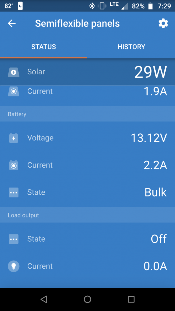

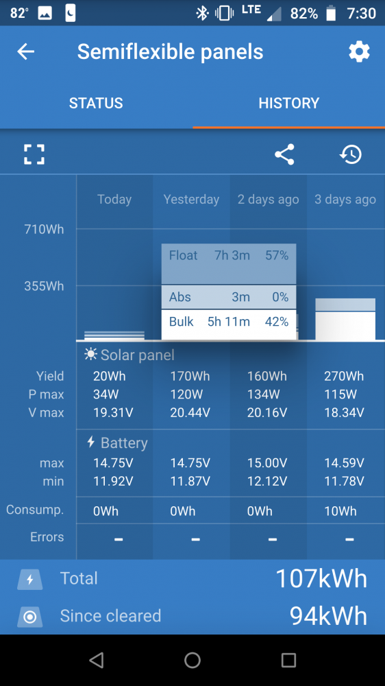

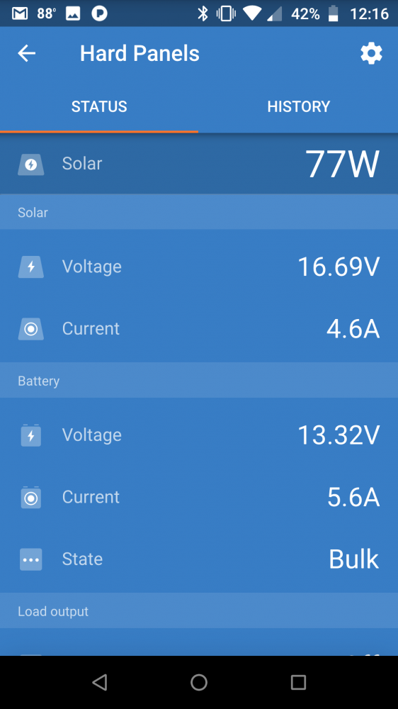

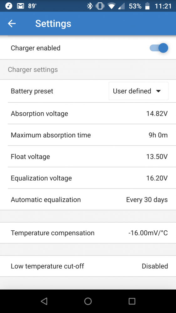

Here is a little background of my array and batteries. I have 4 Trojan T-105RE batteries in series, parallel for a 450 Ah bank. I have two arrays of panels. The first is the "Hard Panel" array consisting of 200 watts of hard panels wired in parallel to a BlueSolar 100/15 controller. The second is the "Semiflex Panel" array consisting of 300 watts of cheap, Chinese semiflexible panels also hooked up to a second BlueSolar 100/15 controller. Both controllers are programmed the same and below is a screen shot of the programming. Both controllers are connected to the same ANL fuse at the charge distribution buss next to the batteries.

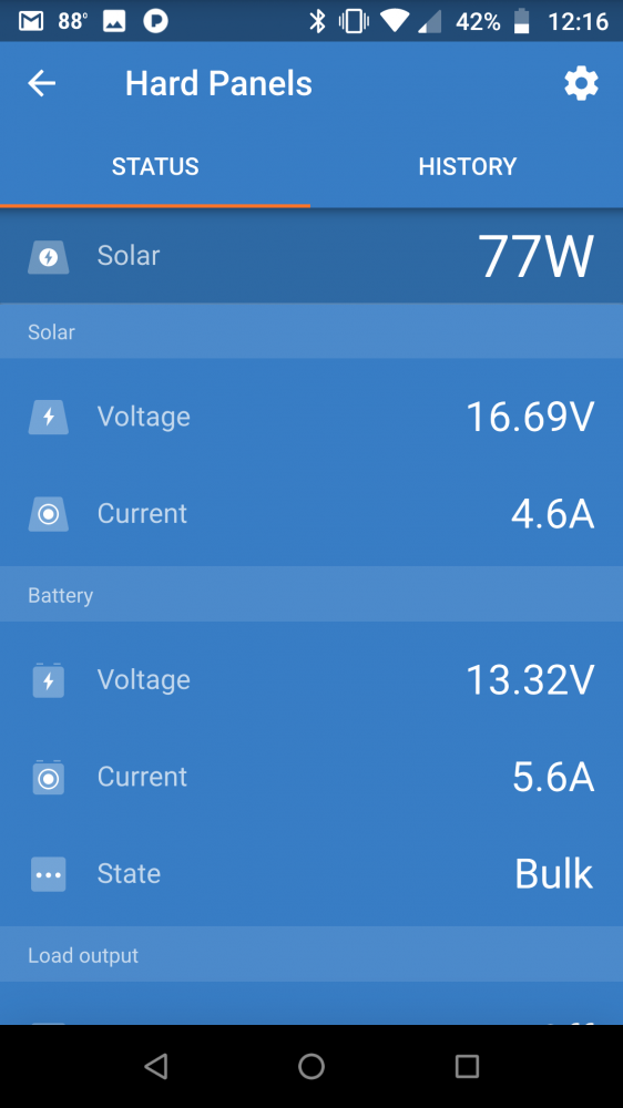

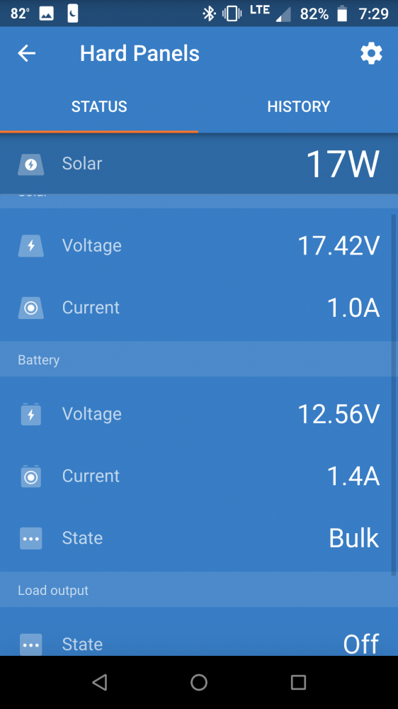

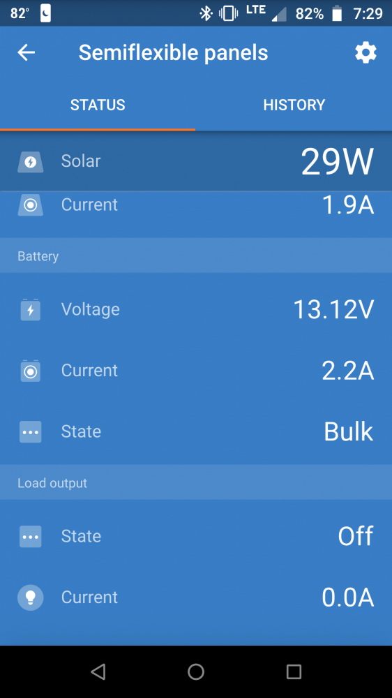

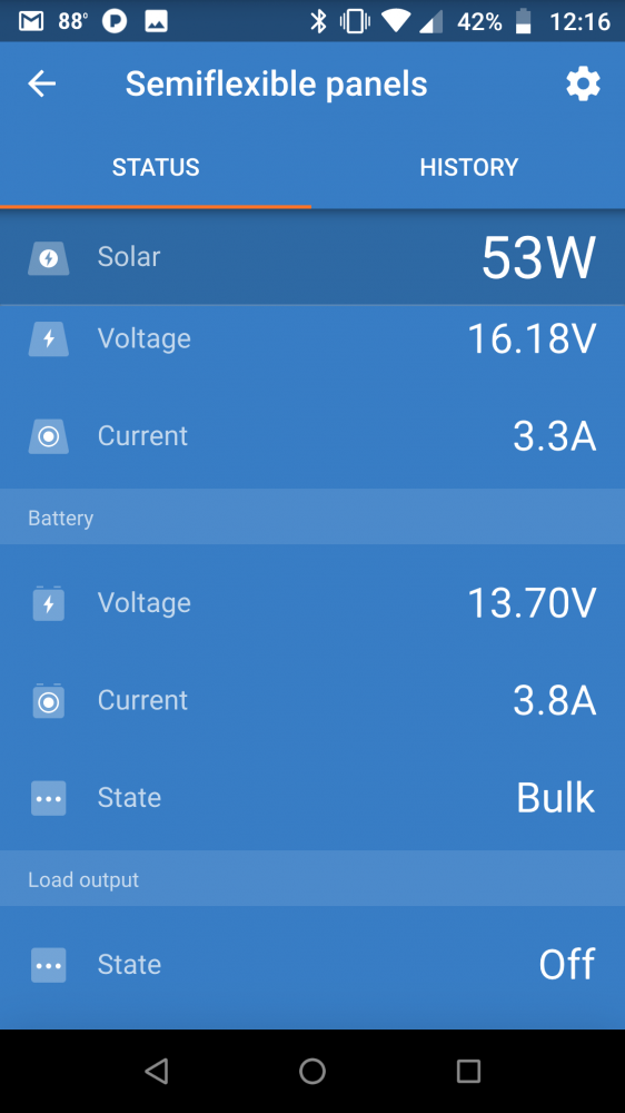

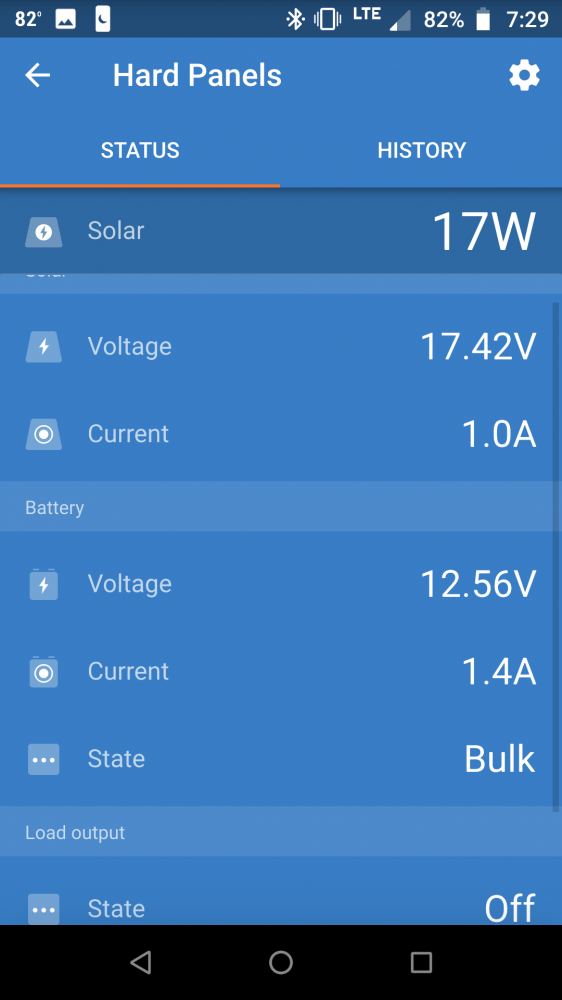

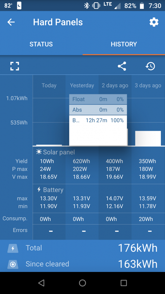

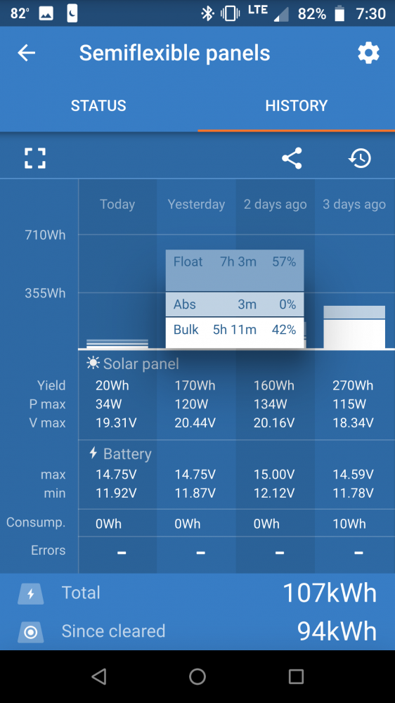

Below are a couple of screen shots of the each controller taken at the same time. You can see that the Semiflexible panels controller is reading about 0.4 volts higher than the Hard panels controller. And this difference seems to increase the higher the voltage gets. This results in the controller for the semiflexible panels spending most of the day in float and not actually charging the batteries. I have tried disconnecting both controllers from both the battery bank and the panels and then reconnecting them but this hasn't changed the problem.
