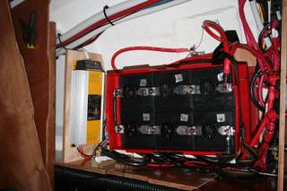

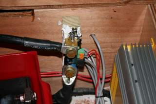

I installed the 2 bank Victron monitor in my last boat (Beneteau 343). I put the shunt in the same compartment as the house battery. (In the pic it is on the wooden bulkhead forward of the yellow Xantrex charger.) Note that the top of the battery box is off in the pic - the battery was a 325 amp-hr lead-acid battery by Rolls. I secured the box with webbing that was passed through a couple of plastic pieces lagged to the floor below the battery.
I had a 1/0 cable made to run from the shunt to the battery switch. There is also a 16/18 gauge wire that runs from the positive battery terminal to the shunt - this is only about 6 feet long and has an in-line fuse of an amp or less. I think the length of this wire is the limiting factor in where you locate the shunt (distance wise from the battery).
Be careful when securing the shunt to the boat. I over-torqued it & cracked the plastic mount. As you can see from the pic I gooped on some 4200 as a band-aid.

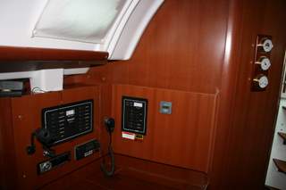

The gauge goes in easily though . . .
