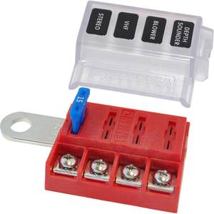

After surveying the result of years of small wires and little in-line fuses fighting for room at our battery Pos. terminals, this spring I changed to a new Blue Seas terminal block connection scheme.
This cleaned up the mess a lot (!) and puts the fuses very close to the post. We have small wires going to the original analog meter, an older AH meter, and a new Balmar Smartgauge.

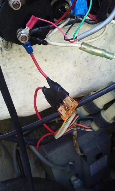

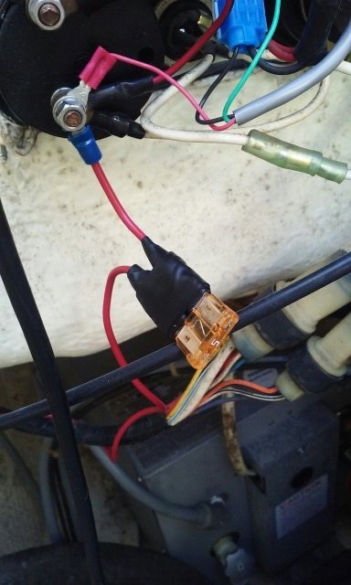

Make your own fuse holder. I used 2 Spade lug connectors some black tape and then inserted a fuse and take it again to keep the spacing correct.
