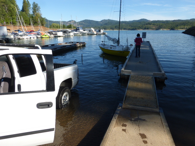

I would not want to rely on a Countryman to launch and retrieve a Vic 18. Even though the std trailer has a long tung, and tilts, and the boat launches and retrieves very easily, that little Mini would be floating away with the boat. I assume you have the 2wd version? traction would also be a big concern IMO. I use a 4wd Dodge, so it's very easy for me, but a Mini?….. Naaaa.
It's a great little boat, but ya need a bit more vehicle than a Mini to tow it.

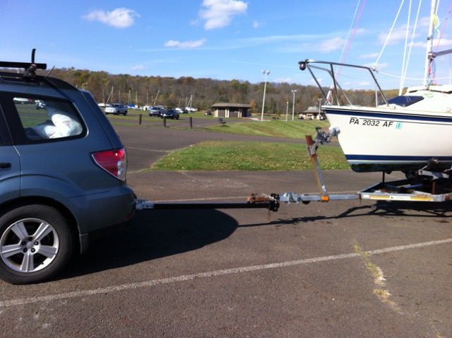

As for launch retrieval, my 192 is stub keel. Sits pretty high on trailer. I decided to have a metal-working friend help me fab an 8' extension. Works really well to float the boat on and off at my primary ramp, and keeps my tires dry. It's a lake, so the ramp is really good traction, not like a slimy tidal ramp. This season, I had my parents help me launch. Gave them each a dock line, said "I'm going to back down, and it will float right off." I backed, the boat's momentum started a bit of float, they pulled a bit when I said, then I pulled the trailer right out, parked, stowed the extension, and was back down at the dock before the powerboat next to me was done pulling out launching their boat. (I assume they had some backing issues.)
At haulout last year, the guys on the dock didn't know with my extension I didn't need to back the wheels into the water, so they told me to keep going. I noticed how far in I was, and then pulled forward some so the wheels were right at water's edge. They were still able to float onto the trailer, and I was again quick to pull out. I have very low boards alongside the keel rollers. My big innovation last year for haulout was to paint the tops of the boards fluorescent yellow. The haulout helpers said you could easily see the boards under the water, and they positioned the boat centered on the rollers, and centered side to side within a 1/2", far better than I have ever centered the boat before. That fluorsecent paint is one of my best ideas yet! :D

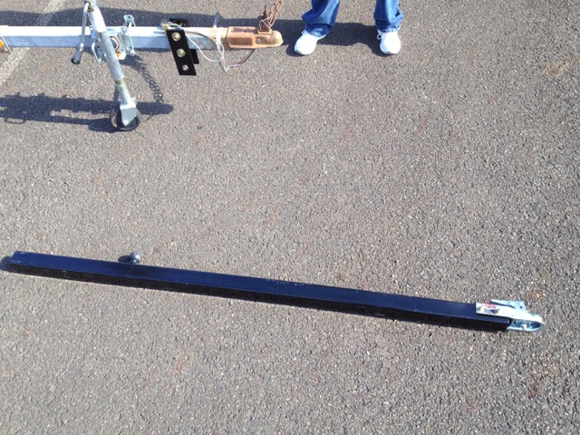

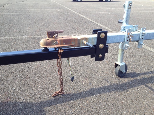

Pieper, my extension is removable. It has a coupler on the end, and at the other end there is a ball mounted maybe 18" in from the end, and tabs on either side of the end that extend up. To install, fit the end tabs up from under the existing tongue. Fix in place with a pin through the tabs, just above the tongue. Then fit the ball into the existing tongue coupler. Now out at the end of the extension, put the extension's coupler onto the vehicle's ball.
My buddy welded another ball to the trailer, and made like a tray. I store the extension on the trailer, with the coupler connected to the ball, laying in the tray and strapped to the tray. The wall thickness of the extension is WAAAAAYYY thicker than it needs to be, that thing is heavy and BEEFY. Probably could have done just as well with aluminum box, but, well...
I have a small trailer for a Force 5. The PO apparently had more time than I don't know, and has made this 125 lb. boat's trailer into a tank. He apparently added tons of unnecessary stuff. He said he couldn't see backing it with his Toyota RAV4, so he bolted on a pivoting tongue extension which gained him 2' or so, and folds out of the way. Some folks use such an extension to fit into the garage; he did it just for a longer tongue. All I can say is it added even more weight to the trailer. That stupid thing tows HEAVIER than my previous Harpoon, which weighed like 600 pounds all up! I can't stand when I have to mow under the damn thing, because it's heavier to roll than my 192 trailer!

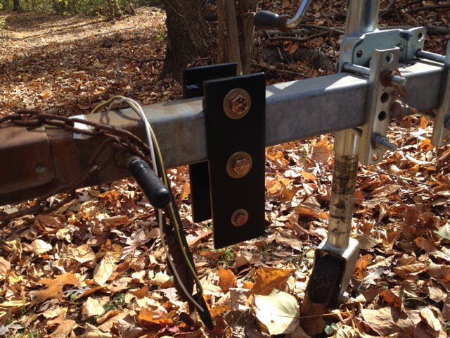

Here are pics of my extension. Note I did not put the fastening tabs on the end of the extension. My beefy overkill bracket is bolted to the trailer tongue. This is not nearly as elegant as some simple tabs welded to the end of the extension, with holes bored, and a simple T-pin through the holes. However, mine works as intended, sooooo... Also, we had to put some thin spacers on the brackets such that they bolt onto the tongue wider than the tongue. Otherwise, the extension wouldn't fit, because it is the same OD as the tongue.
