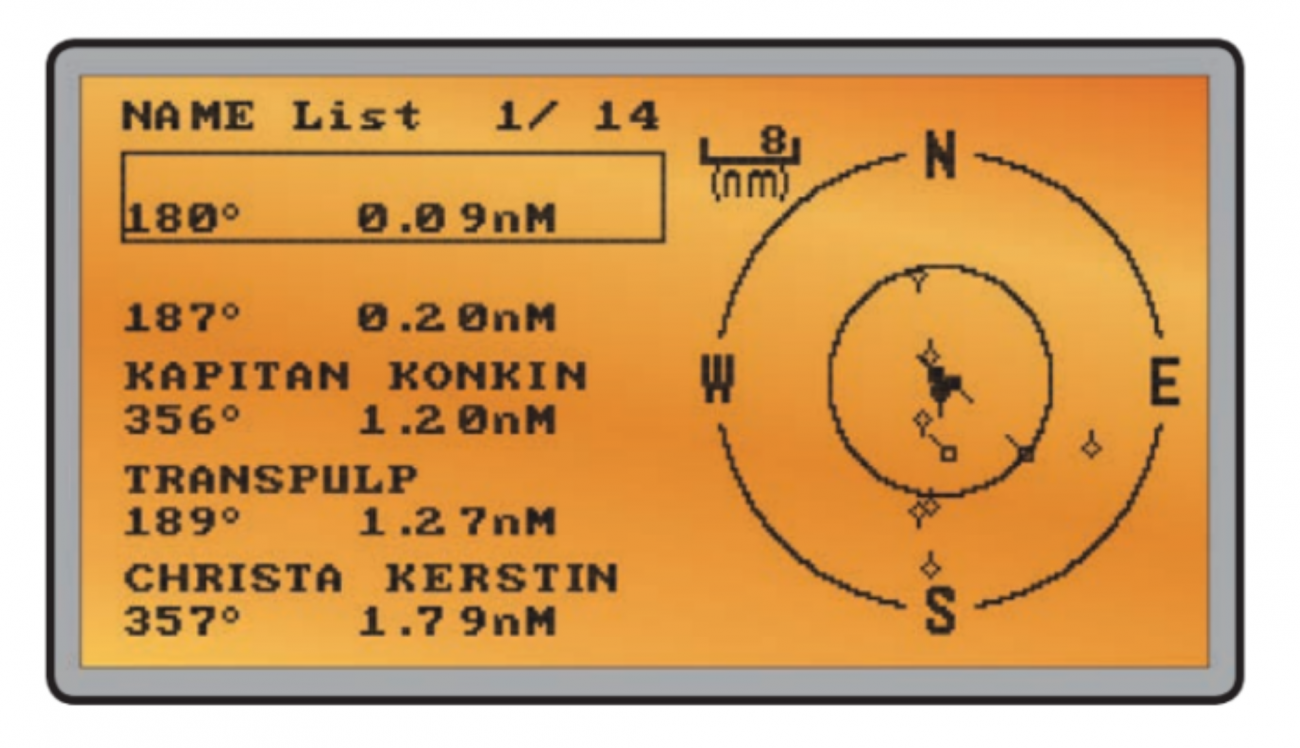

Ken, IIRC the screen size is an issue that needs to be addressed. A Vesper has a huge screen, very readable. I've also thought about your idea, but where I'd want that combo unit is in the cockpit, not down below where my base VHF unit is located, I use a handheld in the cockpit.
Thanks, Dave for that link. Please note that none of those photos shows what the display would look like with AIS info on it. Pretty hard to read, I'd guess.

It isn't as bad as you would think. It's just a circle with proximity dots on it and you pull them up to determine the target. You can also pull up a list and adjust the range. I pump the output into a chart plotter which is obviously easier to scan, but this works OK unless you are in very conjested areas with a lot of traffic. Still works OK but messy.

But screen size is only an issue with combined VHF / AIS receivers, which exists Rick D points out. The transmit part, which hasn't been successfully integrated, doesn't really need a screen.
This is what the screen on Simrad's combined VHF / AIS receiver looks like - not great but it'll do in a pinch if you can't get to your plotter.
