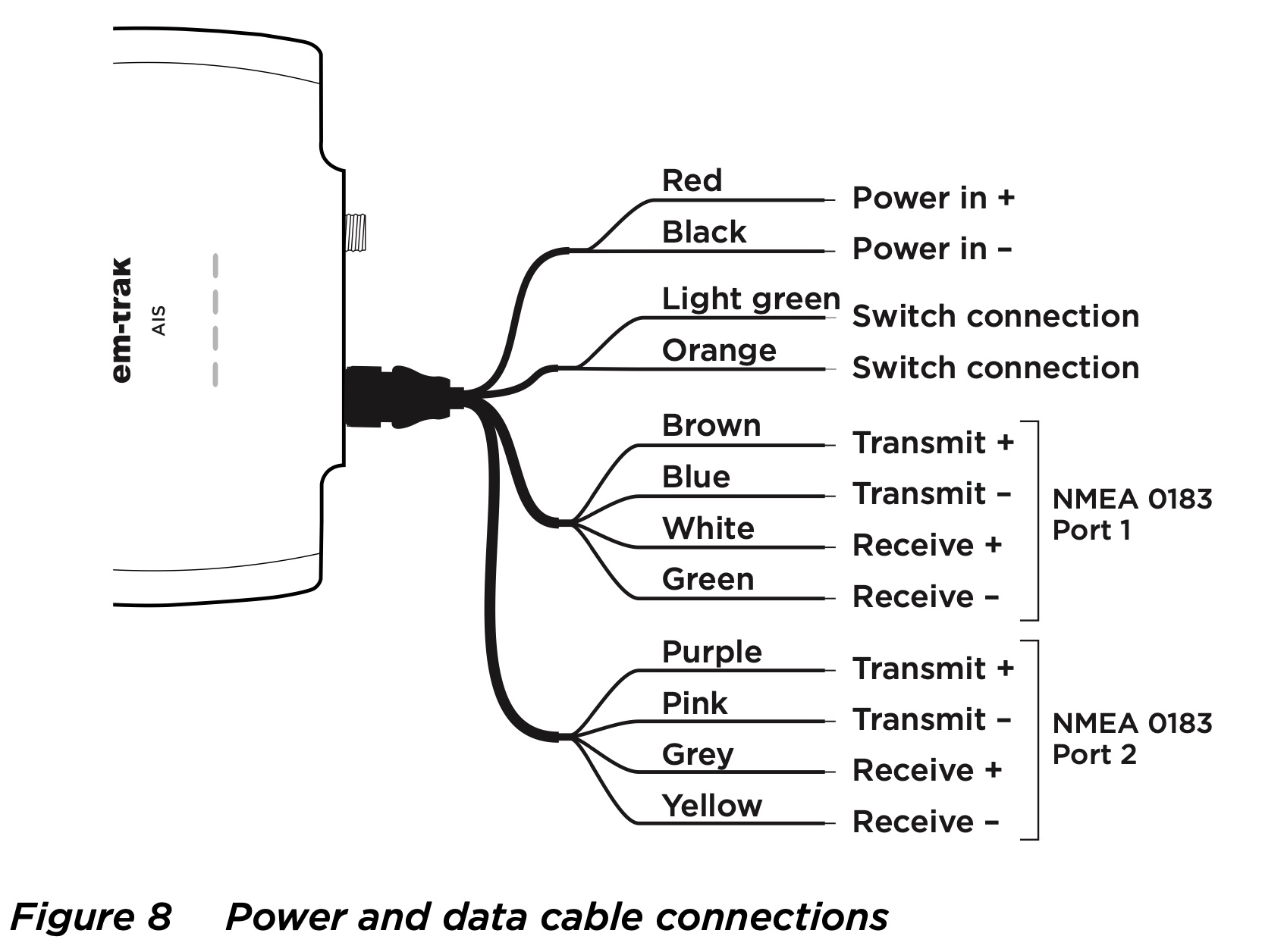

I too am thinking of adding AIS wifi transponder. I was looking at the EmTrak unit (with built in splitter), also on the Milltech site. Anyone have thoughts on this one?
Also, will these units take 0183 data wired in separately from different transducers? Or do i need to buy a multiplexer before feeding data into the AIS wifi network?

Rodd your answer to the 0183 data is maybe...
The EM Trak unit you are considering has 2 ports for 0183 data.
You can attach two "transducers/sensors" producing 0183 data to the unit. This info can be displayed on the chart plotter as shown in the diagram from the EM Track manual.
