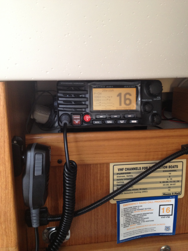

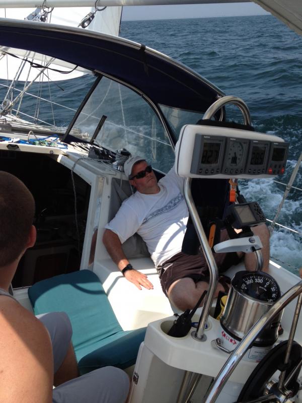

Anyone have their VHF radios mounted at the pedestal. Just bought the SH 2150 and was considering mounting it in the cockpit since it has the AIS system, fog horn and hailer and it would be probably more useful at the helm. My radio is on the nav station (probably like most of yours) and I keep a portable radio at the helm. Here is my current configuration.

I have a Standard Horizon down below with a wired remote microphone in the cockpit. Love it and the batteries are never dead.

I considered that. Is it permanently wired or do you plug it in every time you go out? I want to avoid having a wire in the cockpit.

Wired into a plug ...
that comes out in the NavPod. Every time I go out I just bring it up from below and plug it in. Only problem I have had is one time the Admiral sort of managed to plug it in and, ahem, did not quite get it quite aligned correctly. Not sure how that happened :confused: but I was able to get the pins straightened out. Definitely proved that the whole set up is pretty robust and somewhat admiral proof. :D

Similar to rpwila, I have a Standard Horizon GX 2150 mounted below with a fully functioning Remote Access Mic in the cockpit. I usually leave the RAM connected and only remove it for long term storage. On the GX 2150 the RAM has a small screen that displays the AIS and ind the RAM controls all functions of the radio. I should also add that wiring the radio's AIS into the chart plotter was very simple.

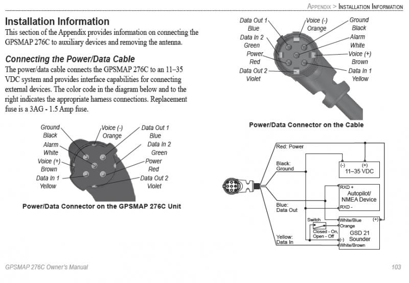

Installed the radio yesterday and will be working on the remote mic project over the winter. Didn't realize my chartplotter isn't compatible. Guess ill have to suck it up and buy a new one!

... Didn't realize my chartplotter isn't compatible. ...
What do you mean. Doesn't the radio accept nmea 0183? What are the symptoms? On mine it would not work, would not work:confused:, would not work:confused:, and then out of desperation/frustration :cussing: I added a second ground at the base radio off the buss bar there (I had tied the ground in at the wheel to the GPS) and it worked like magic. :dance:

It's a Garmin 276c. Apparently it won't work with that series, so the paperwork says. Checked with the specs on Garmin and it says no also.

From the 276 manual
Page 88
How Can Garmin Help You with DSC?
To receive distress calls or position reports, you must have a DSCequipped
chartplotter as well as a VHF radio with DSC support.
During normal, non-emergency position report communication,
Channel 70 (156.525 MHz) has been set aside as the VHF/DSC
digital call channel.
For a distress call, press the MayDay button on the VHF radio. The
call transmits on an emergency channel with the MMSI number
attached to the call, if the receiver has DSC support. Any DSCequipped
mariner (on sea or land) within range can receive the call.
When the GPSMAP 276C is connected to a VHF with DSC support,
the GPS unit shows a call list, log, and a directory. Basic wiring
is required for the Garmin unit and VHF radio to send and receive
NMEA data from each other.
So, you want to connect the blue and black wires to the back of your radio (see also the attached diagram). I also attached the diagram from the SH 2150 manual. Pages 15-20 in the SH 2150 manual explain it and in the Garmin manual pages 88, 103 and 104.
All that being said, my experience with the newer Garmins has been less than stellar and for me I would not have one.
