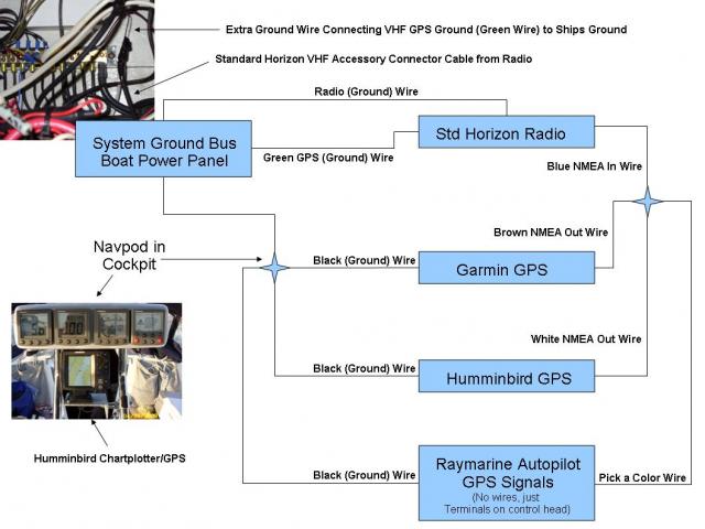

I posted this when I was trying to get it to work on the 310 forum, but I finally got it all working. :dance::dance::dance: First let me thank the tech support at Standard Horizon (Devin Massens)
who after a couple of emails and phone calls helped me figure out the problem. I now have my Garmin GPSMap 176 and my Humminbird 785C2 sending GPS data to my Standard Horizon VHF radio. I am still not sure if my Raymarine S1 Autopilot sees the GPS, but I think it does (need some more boat time to test).
First off none of these guys have very good documentation, and when it was not working there was no indication why. I believe the end result was that when I added the extra ground connection on the signal connector out of the radio direct to the ships ground panel it all started working. This was one of several things Devin and I talked about (did I have a good ground).

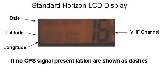

In the end it was very simple to do and once it worked it was very obvious. I added a picture of the VHF front panel although it is a pretty crappy picture, but I think you get the picture. As noted in the picture, if you do not have GPS data the areas on the left of the display are dashes where the time and latitude and longitude data should be. It was all pretty frustrating up to that point as I could see the NMEA sentences with a meter from the Garmin and Humminbird outputs, but the radio was acting like nothing was there.
This enables the DSC feature in the radio with the red panic button so if I ever need help it sends a digital DSC message to the Coast Guard with my coordinates as well as my MMSID. Hope this helps. Ray
