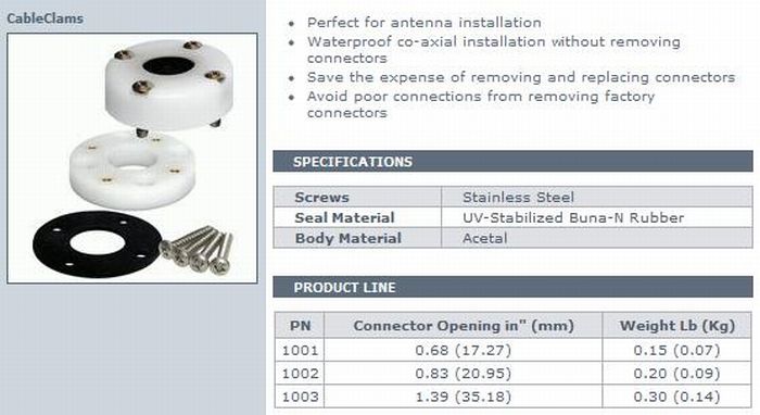

Of get one of these and keep the connection below deck where it will not have any corrosion or moisture issues.
That would require replacing the coax in the mast also as it would not reach that far. That's a project that I do not have time for this season (plus I stored her mast up this year).
