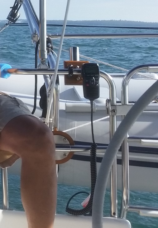

Honestly, I think I read @AaronD 's write-up before I did mine, but the instructions are pretty clear. Installation is plug-and-play with no splicing needed for my installation, if you run it in the right direction and remember to put the stuff on before fitting together. On my Cat 36, I could not figure a place on the binnacle to mount it that kept the curly wire off the deck but was still a couple feet away from the magnetic compass. I had just pulled an old GPS antenna off the stern coming, so I enlarged that hole and installed there, mounting the mike holder on the stern rail. It took some boat yoga to run the wires up front. They give you about 20-feet of wire with the mike, so usually not a problem, but you can buy an extension cord as well. Plug one end into the back of most SH radios, and the other end into the bottom/back of the mike mount which was mounted over the hole with a bead of LifeCaulk to avoid leaks. The mike unplugs from a 9-pin connector, and you should have the radio powered down before connecting or disconnecting it. Best photo I can find of location:
Thank you so much! If I have the right radio, this will be the best solution for me for the short term (and a handheld).
