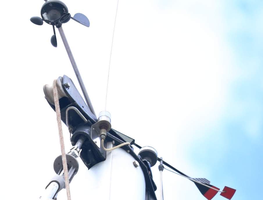

I think that this is typical of many boats…at least my old O’Day 322
You can see the coax and the antennae on the side of the mast.
