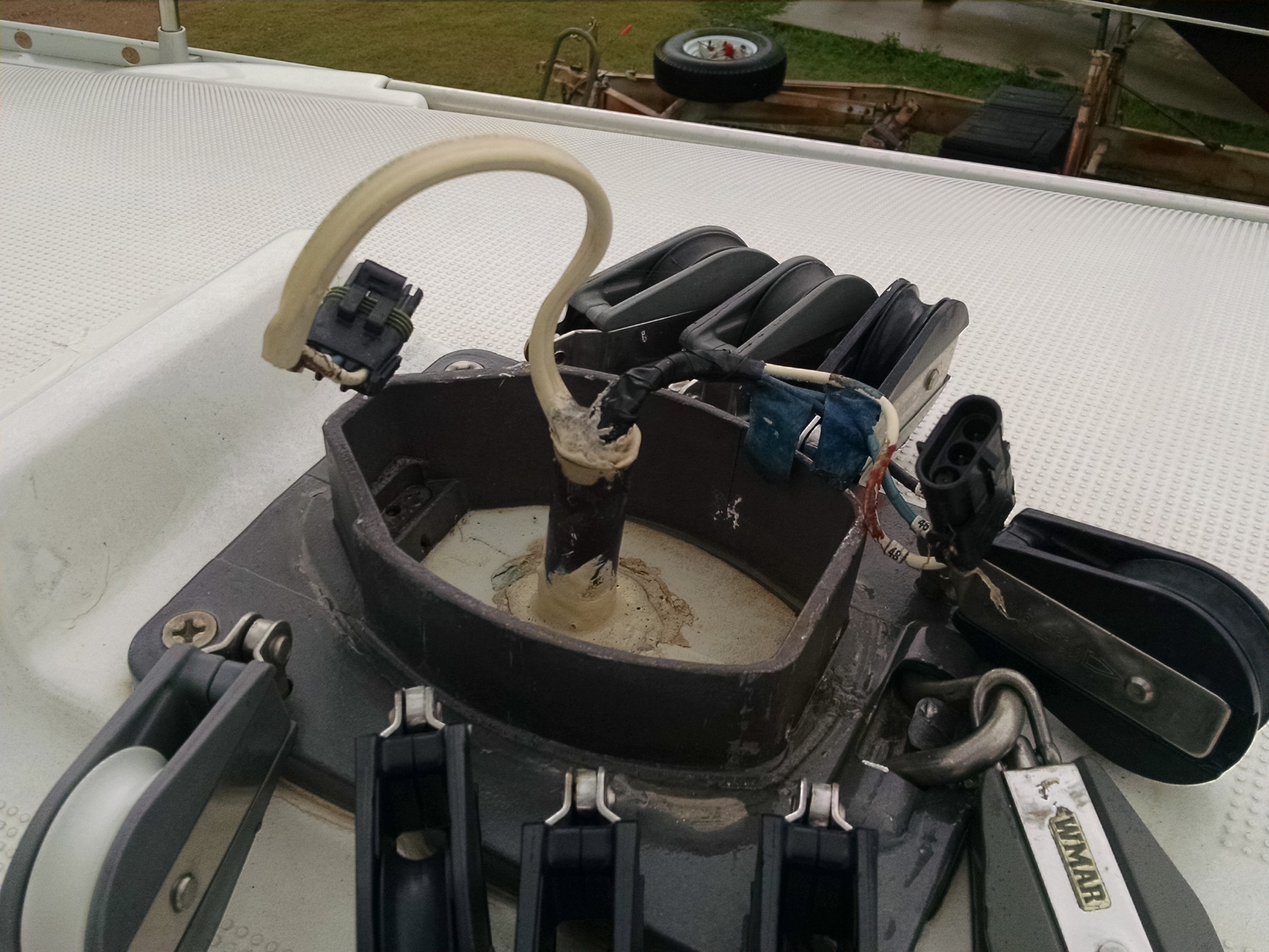

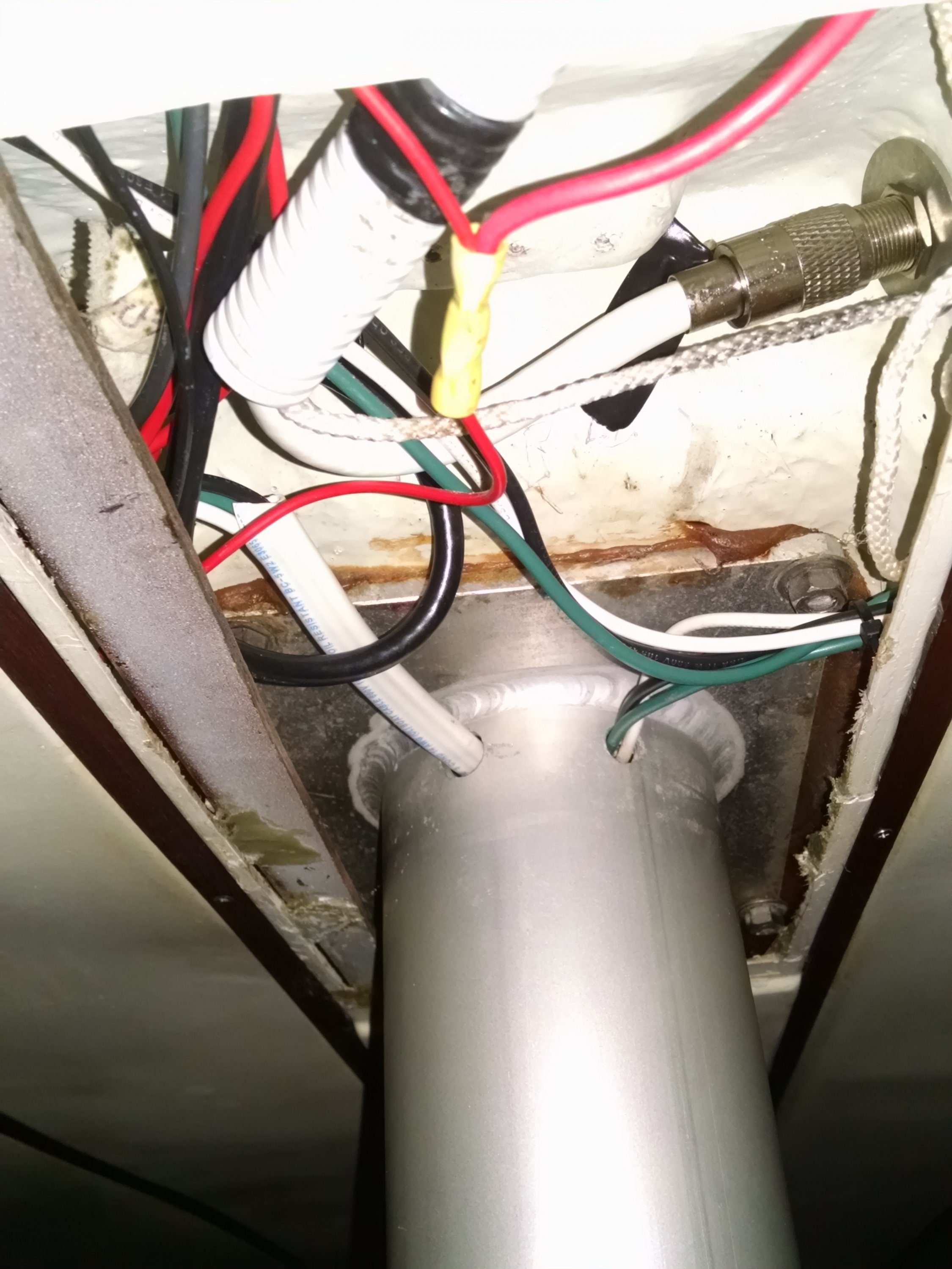

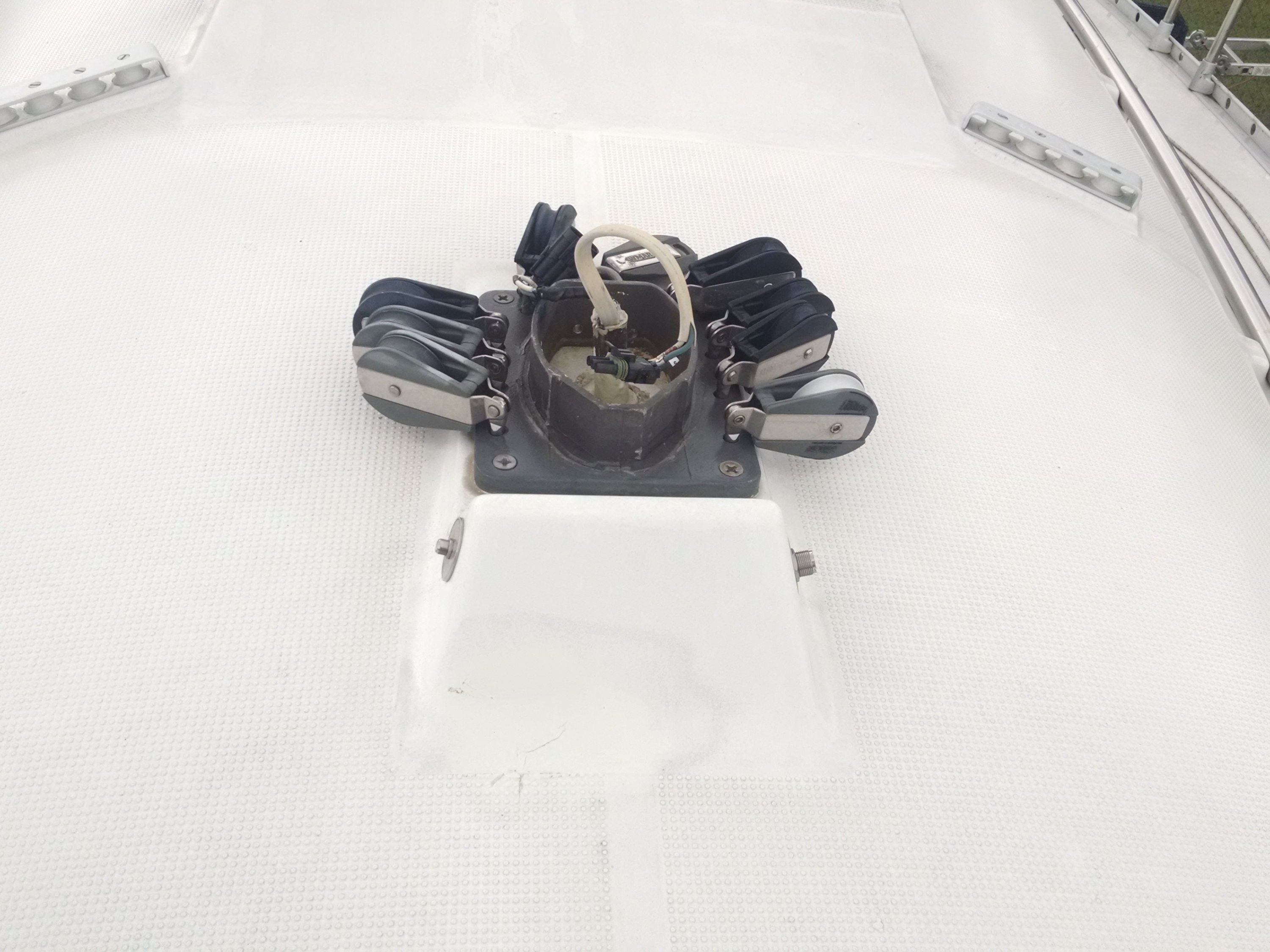

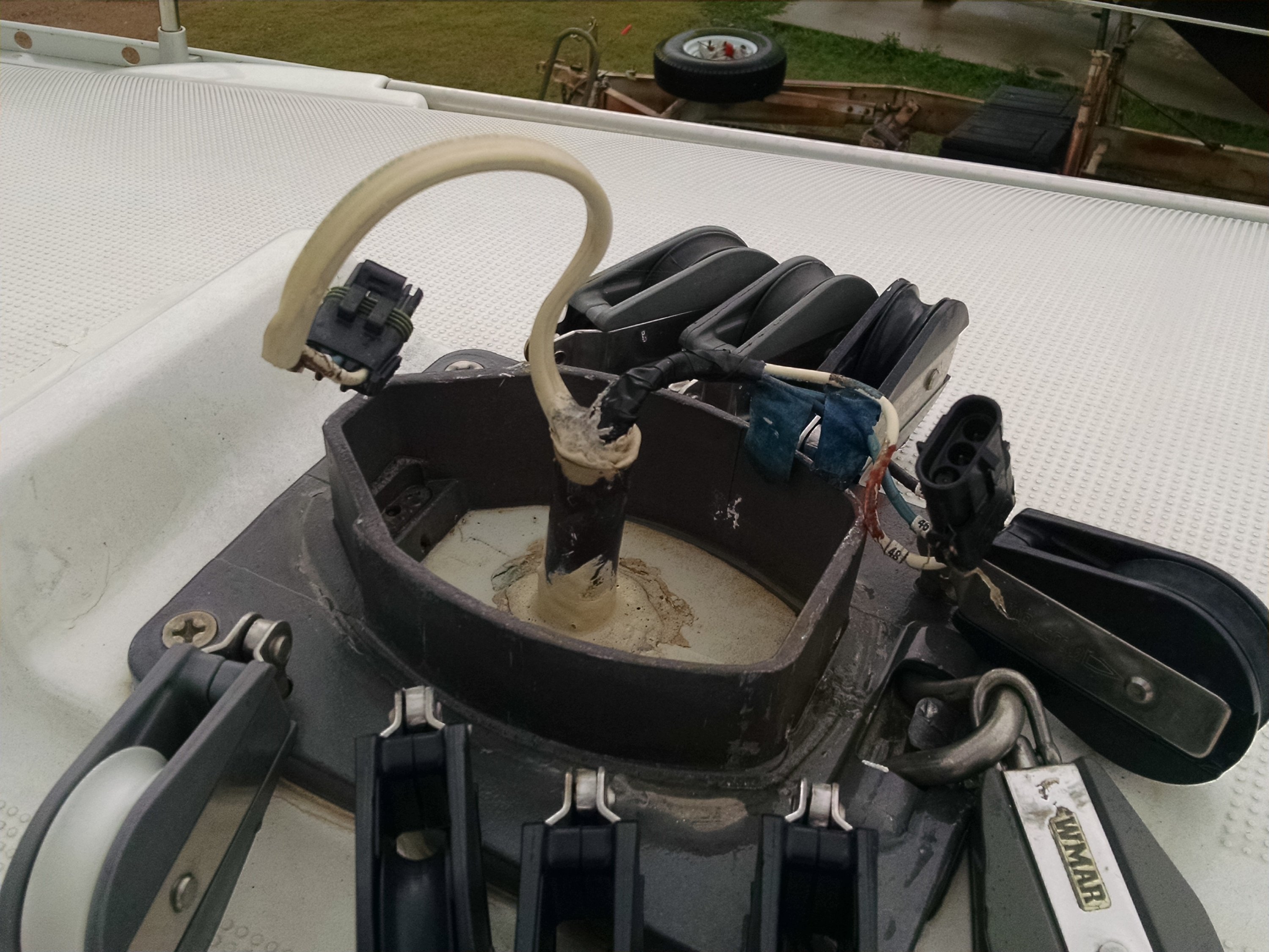

Mast Base Wiring Cleaned Up IMG_20160624_085520072.jpg Mast Wiring Internal After IMG_20161114_202831533.jpg Mast Base Water Preventer and wiring IMG_20160624_073655515.jpg When I rewired my mast, I set it up like this, see the pics. All the wiring comes up through the mast support at the top above the headliner and up through a pipe. The pipe is sufficiently tall that water in the step will run over the top of the step before it can enter the pipe should there be any leak in the seal. The pipe was epoxied in place and sealed after the wires were fed up through it. The connectors I used for the wiring are waterproof "Weather Packs" and as you can see one set of wires at the base has a male connector and the other has a female. In that way, there is no opportunity to connect one plug to the wrong mate. On the VHF (big cable) and the TV (small cable) I sort of stayed with the OEM setup and routed them through the bump-out in front of the mast (originally all the wiring was fed through grommeted fittings through the bump-out - bad plan IMO as connectors were a PITA to feed through them). Only problem with the way I have the VHF and TV cables coming out of the deck is that they tend to get in the way of the jib sheets. If I had to do over, I would find a way to feed them up through the mast step similar to what I did with the lighting circuits - difficulty is they have to be able to be screwed on to the connector inside and out. I suppose a short stub of cable with connectors on each end (one inside the boat and one outside could accomplish that.
