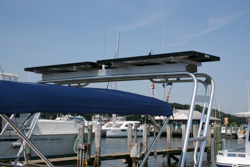

AIS Antenna
FWIW - I installed a dedicated AIS antenna between the solar panels on my arch. (See pic) The service manager at my Beneteau dealer had told me that there might be interruptions in either the VHF or the AIS reception when using a splitter on the masthead VHF cable.
I don't remember if the antenna was Shakespeare's special AIS version, I tend to think it was not. I did use the LMR400 low loss coax cable.
I keep the AIS alarm on silent because it does get annoying.
