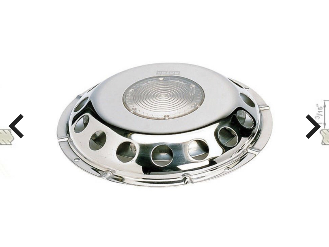

Aloha Everyone,

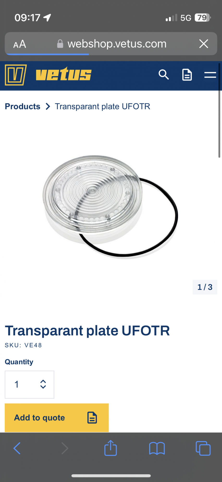

I accidentally stepped on and broke the very brittle and yellowed plastic part of my vetus UFO vent on the fore deck of my 1985 Hunter 34.
I was able to to find a local Vetus dealer who ordered me a replacement part, SKU VE48.
On the Vetus website it showed a picture of VE48 including the o ring, apparently they are different parts and do not come together.
The original or ring broke as I was removing the old plastic. The dealer cannot find the o ring and cannot get an answer from Vetus.
-Does anyone happen to know the SKU for the O-Ring?

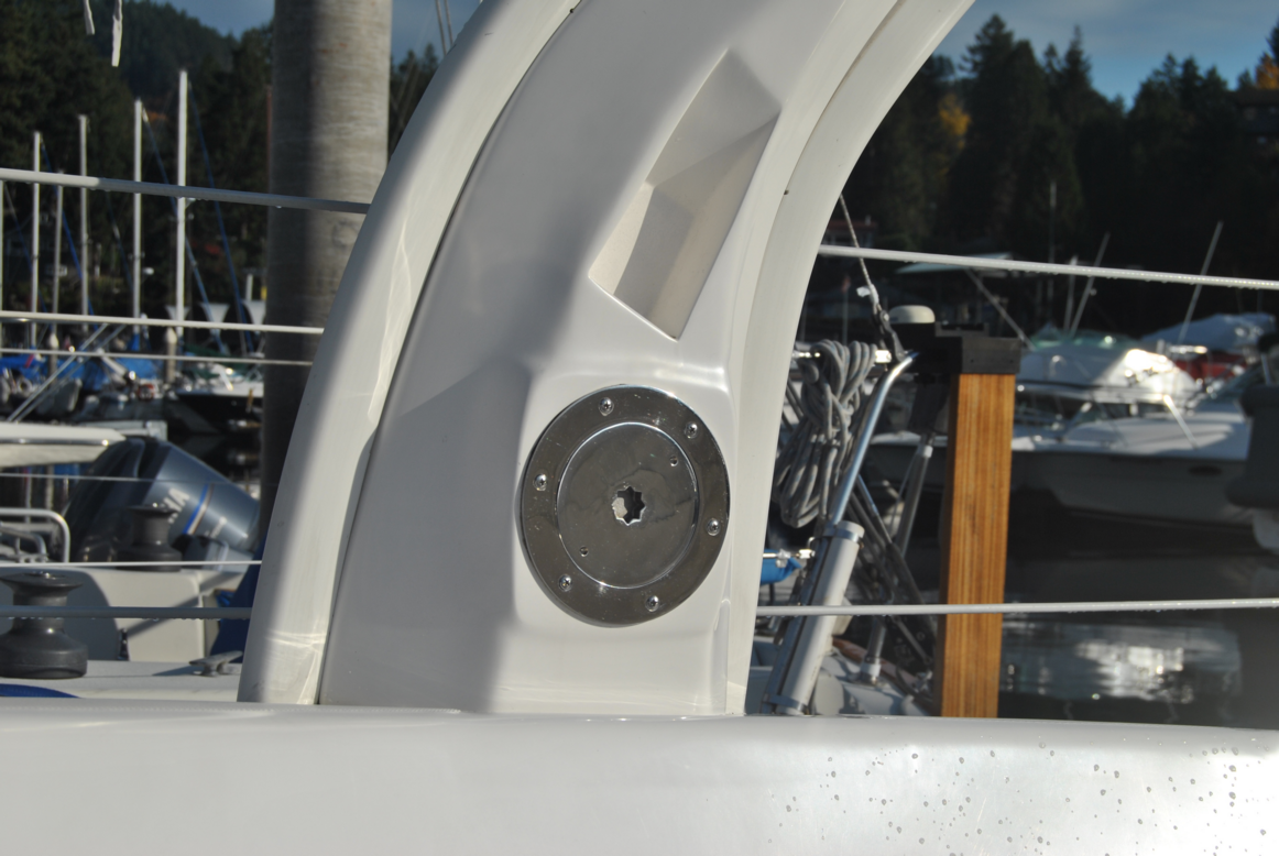

But getting on to the "O" ring, making one is really quite easy. I was stuck for replacing the ones in my deck plates which are about 5" dia. and do not exist anywhere.
So, made some.
1. Measure the material diameter of your existing "O" ring.
2. Order up the material of the same dia. from Amazon.
3. Measure the circumference from the old ring.
4. Cut the ends as square as you can.
5. Join the ends with "Crazy Glue" and let sit for 24 hours just to be sure.
You will never see a stronger joint on such a tiny surface area. Trying to tear the joint apart will rip your hands to rat:poop:. If not, you didn't use genuine "Crazy Glue."

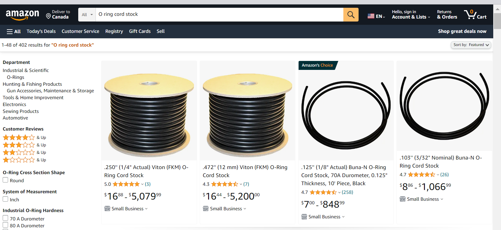

Ralph, would you mind posting a link to the material you bought off amazon? Im having trouble finding it.
Thanks,
chris
Jan 4, 2006
7,450
Further on Spaenaur, their catalogue is now in electronic form for only 242MB at 1717 pages. There goes another Sunday afternoon.
Jan 4, 2006
7,450

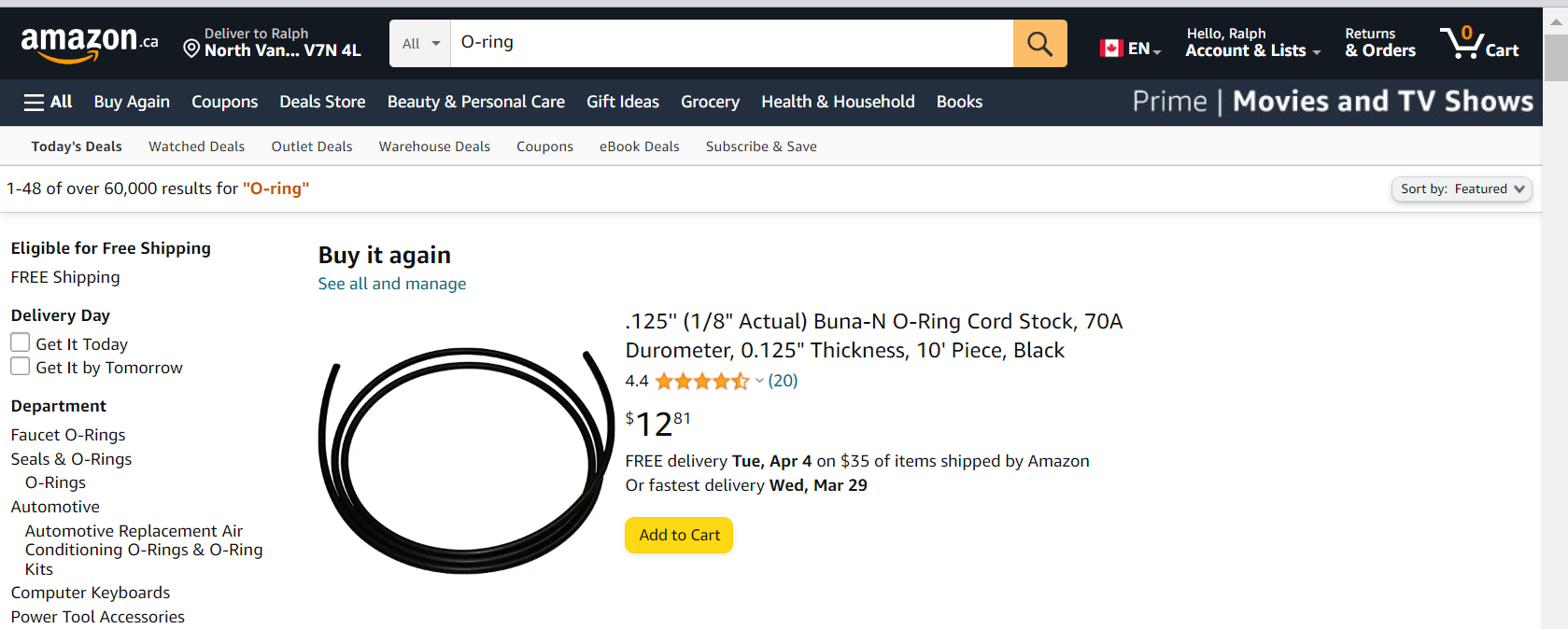

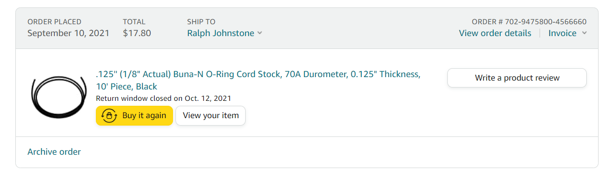

OMG, did I ever get hosed on that one. But, it was for the boat and I had to have it :
This is it on Amazon.ca :
Buna-N material in 10 ft. lengths didn't jump out at me on Amazon.com so you may have some searching to do.
Whatever you do, DO NOT have anything shipped across the border. I recently had to order some high class sanitary hose from Defender Industries as it's not sold here in the colonies. The order was about $100.00 US and the shipping and border charges added up to $95.00 US. But it was for the boat, so I guess it's OK.
