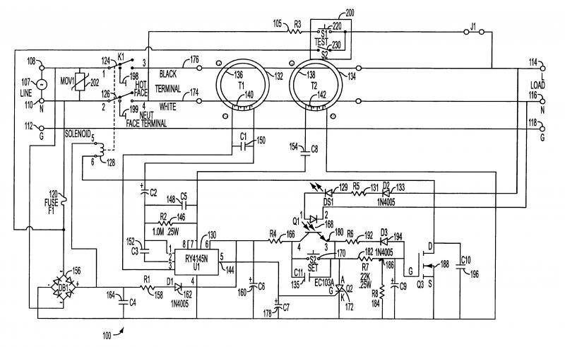

Also.. nit picking a little here but GFCI circuits generally fail either on all the time or off all the time. I attached a typical circuit, it uses a relay to connect the line in and line out. The relay and circuit can fail either on all the time or off all the time. There is no mechanism for the hot to short to ground (almost, there is a MOV on the input and these can look like a low impedance if the device is involved in a ightning strike)
