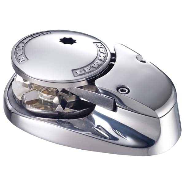

I finally got around to taking a picture of the anchor locker. What do you think of a vertical windlass like this:
mounted towards the front of the locker extending through the hatch.
If I have it mounted so that it protrude through the hatch, and I remove the board that is crossing from side to side, it should allow the chain to drop into the deepest part of the locker. I would need to move or abandon the below deck cleat.

@pateco Chip the chain strips going forward. It makes a 180 around the windlass gypsy. So you might want to build it into the locker on back side not the front. I would look at a few installs in your marina to get an idea what others have done.
I understand that if you can install the motor in a dry space you will have less corrosion over the years. I am looking at positioning my windlass with the motor over the V berth behind the hatch to the anchor locker.
The chain drop will be in the anchor locker in front of the bulkhead into the anchor locker.
The problem with putting it at the rear, is that the chain/rode would have to cross the hatch on the way to the windlass, making it impossible to open the hatch and clear any jam while recovering the anchor. I suppose I could keep the hatch open for dropping and recovery activities. Additionally, I have no interior access to the anchor locker, and a smooth gelcoat headliner in the V-berth. Below is a picture of someone else's H31 V-berth to show the underside of the anchor locker.
