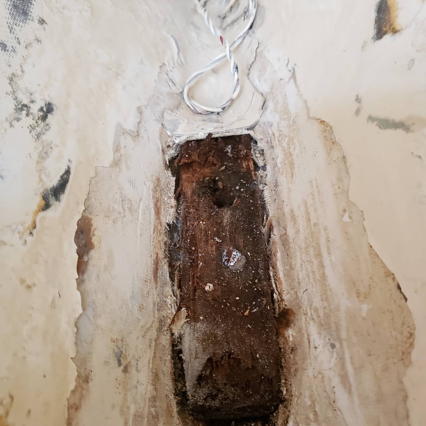

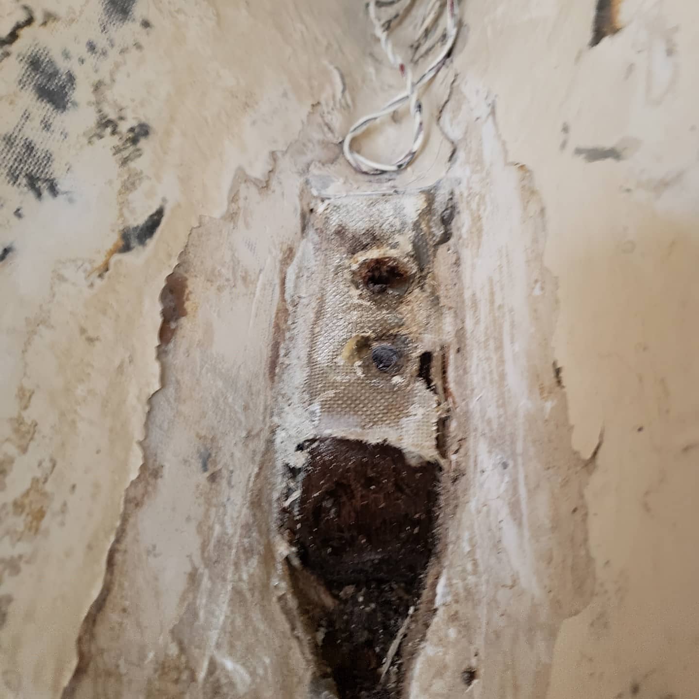

I'm actually glad that my boat needs this much work, I see it as an opportunity to improve my skills and actually know what's going on with things, instead of just trusting that it was done right before. You might want to check your bow eye and backing block, too. Mine had spent several decades getting wet and turning into a wooden sponge. Replaced with new plastic one from Catalina Direct from the C22, much more secure.
