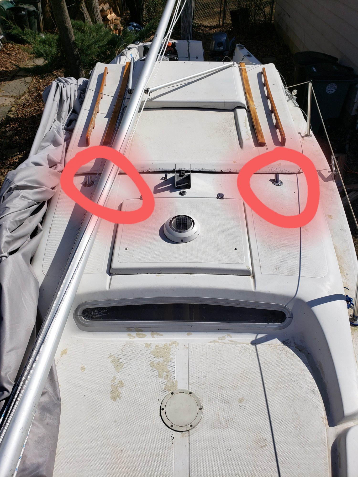

The pop top is missing it's supports and hardware. Previous owner removed them and drilled big holes in the pop top and to bolt it to the main cabin roof. What do I need to make the thing pop again? I have not found any good source of close up photos for the supports or how they were attached. There is nothing left of the old hardware.

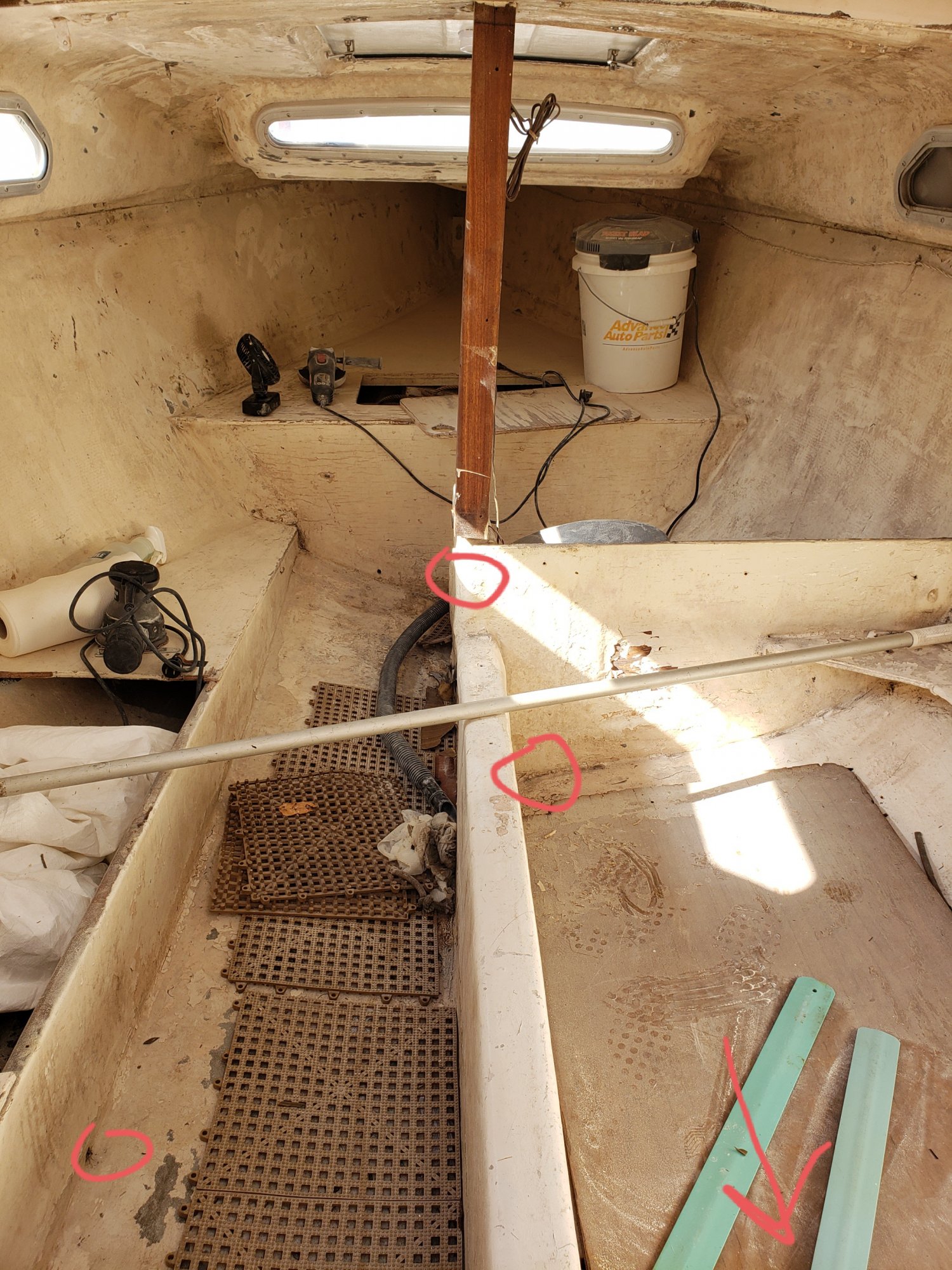

2. I do have limber holes, but "consistency in manufacturing" must have been a foreign concept at MacGregor Yachts (I was doing some sanding over the weekend, and found a number of voids) . Possible yours were covered up by a PO, or maybe you never had them. Attached a photo indicating approximate locations of mine, note that nothing goes through the keel trunk so if you WERE to install a bilge pump, it would probably have to have port+starboard intakes?

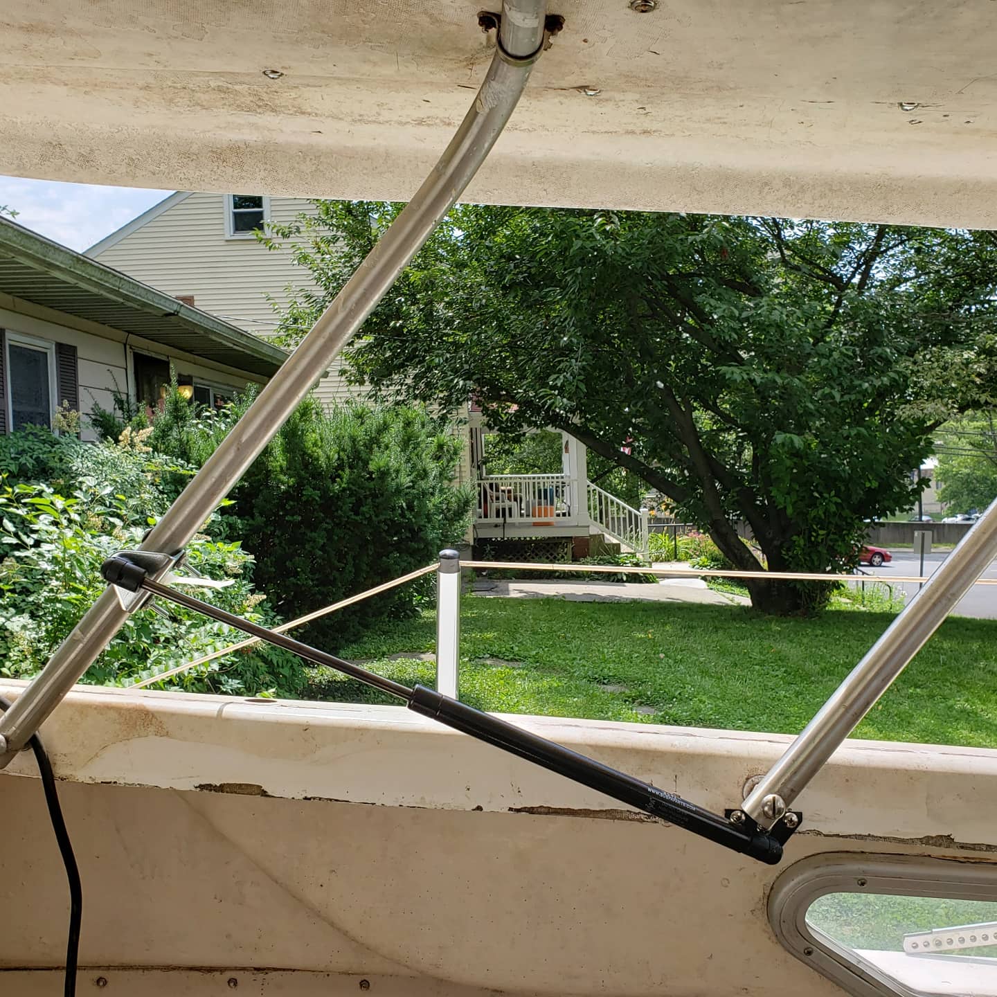

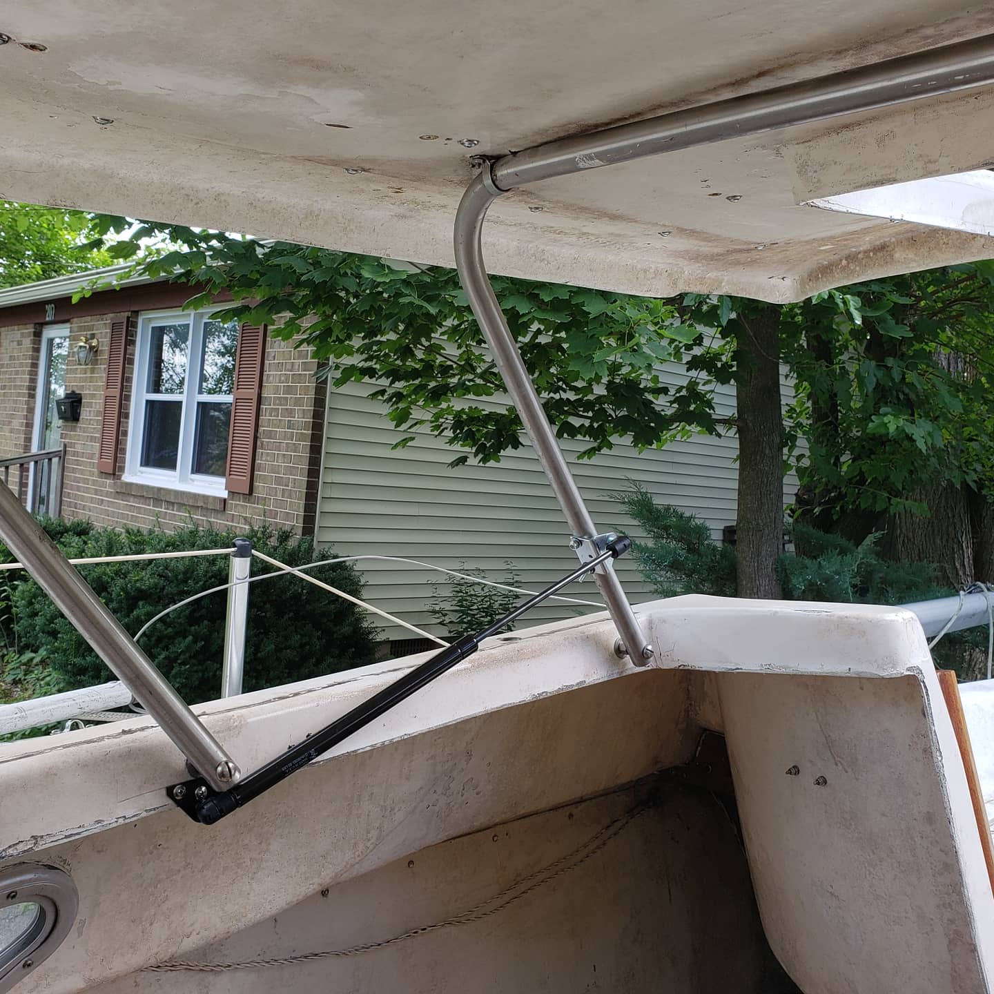

5. I'm also including a couple photos of my pop top, it's possible that the big bolt holes are not from the PO, but the factory means of locking the pop top down. They're terrible. I plan to fill mine in, and hopefully replace with a latch mechanism. Enough problems with rain ingress as it is, not sure who said "Hey, let's drill a bunch of gigantic extra holes in the deck!" There should be a couple of brackets on your deck for the support struts that hold the pop top in the "up" position. If you plan on using it, the gas strut mod is a must.

Thanks so much for the photos and info! I will have to look and see if I have the holes from the poptop frame attachment next time I make the 70 mile trip to work on "Bottoms Up". I suspect the PO may have the frame pieces in his boat house and just not know it. He bought the house and the boat came with it as well as some wind surfers and other assorted things in the boat house.
When he gets back home I will ask him if I can rummage through the boat house looking for the frame pieces.
I was wondering why there were fittings for posts at a 45 degree angle on the cabin top. How is that supposed to work with the top?
Yes if I get the poptop popping I will do the gas strut mod.
