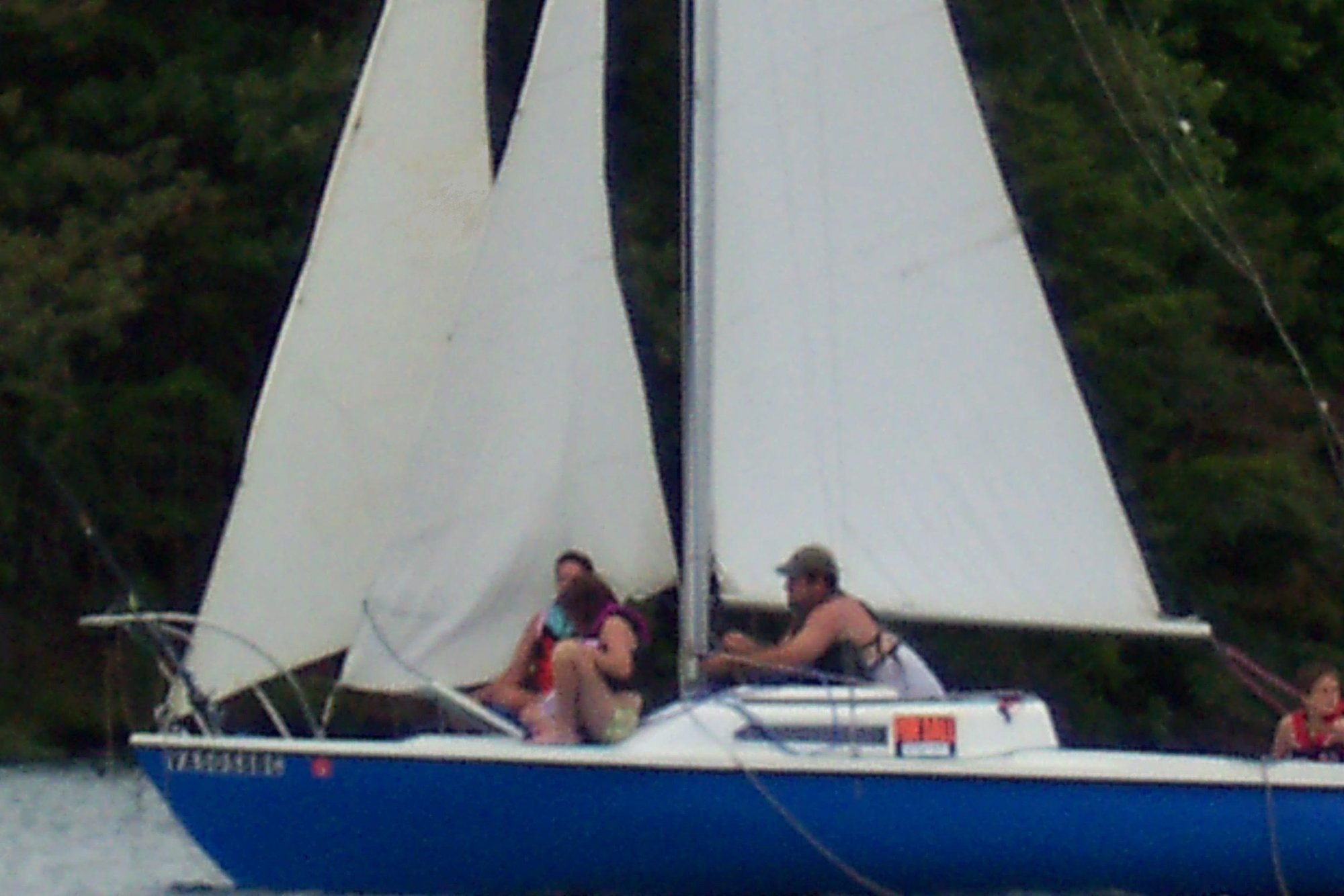

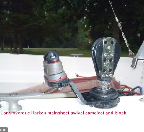

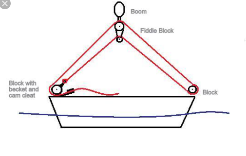

That looks like what I think the traveler should look like! So, some boats lack a backstay by design, not because I lost it on the highway? That is good to know! I wish the cabin height was taller (low overheads and my forehead always seem to meet), as that little boat is like an indy car in light breeze. Love the size of the C22, but that V is easier to single hand. Thanks for the help!
13,052
I have owned two Mac V21's and a Mac V22. All three had a back stay. However, the backstay was loose (slack). It only really ever came into play when running. The back stay also only went to one side. If I remember correctly the chain plate for the back stay was on the starboard corner of the transom. You can see the stay in this picture. I had rigged mine as a clipper but that is not standard. Dave is correct about the traveler system for the main sheet. And the Mac 21 does not have spreaders.
