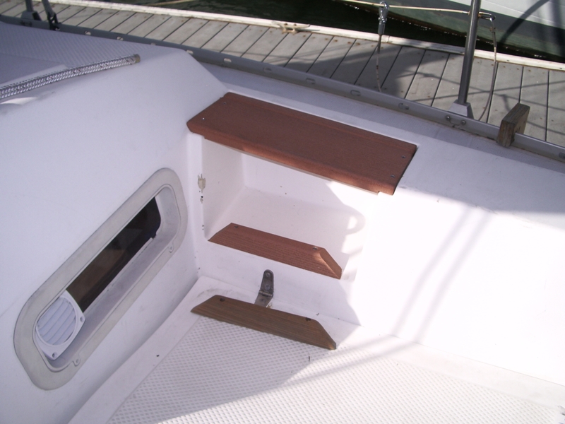

Some good additional ideas have been posted on the topic. Here are a couple of pictures that I have that show my experimental set-up (sort of). They were taken of other projects, so they don't completely focus on the engine exhaust. I used a 4" to 3" aluminum elbow reducer from the hardware store at the Beckson port on the engine box. Just spread the tangs on the 4" side and it wedges right in. Then with 3" dryer ducting I came straight up to the opening port by the icebox. I cut a piece of 1/8" plexiglass to fit exactly in the port and drilled a three inch hole in it. That let me leave the port open all the time and remove the screen so I could poke a louvered flush hose vent inside and connect the dryer duct to it. Down in the engine compartment I was able to just wedge a square computer fan into the foam sound insulation right in front of the Beckson opening. Wiring was really crude...two clip leads; one to the back side of the battery selector switch and the other right to the heat exchanger drain petcock. So when hooked up the fan runs all the time. I do un-hook it when we are anchored or sailing, but when motoring and back at the dock under battery charger, it runs pretty much all the time. The real obvious improvement is that the inside of the boat smells a lot better. There is no hint of diesel odor or just that hot engine smell that we could detect before. During the winter, when I have to pull the vent back inside to close the port so the rain doesn't come inside, we have noticed that the boat starts to take on a stuffy smell. This even though we leave the hatch over the shower cracked all the time and I have two fans inside the dorade vent box with a small solar panel on the deck in that wierd compartment forward of the vents.

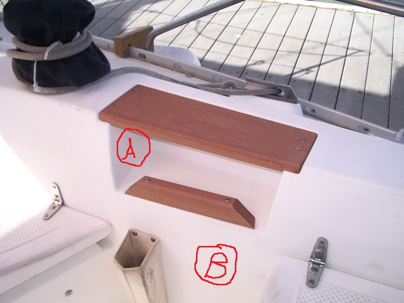

All in all it think the engine blower is a good addition and have been agonizing over the placement of a more permanent location for the exhaust as well. I have considered the coaming on the outside of the stern as near to the center as possible. The problem is not being able to loop the ducting upwards right at the vent. I really like that clamshell that Dave showed and thought about putting it inside the forward end of the aft starboard coaming cubby hole (A in the photo). Again it wouldn't loop up much, but would be protected. When I wash the boat I might need to be careful and not blast the water in there. Dan suggests putting it on the locker on that side. Since all my extra lines hang on the inside then the the next closest for me is the side of the cockpit (spot B). Then I could loop it on the other side. My only concern in the cockpit like that is that is where the dog stays and I don't know if there are any exhaust byproducts that wouldn't be good for her.

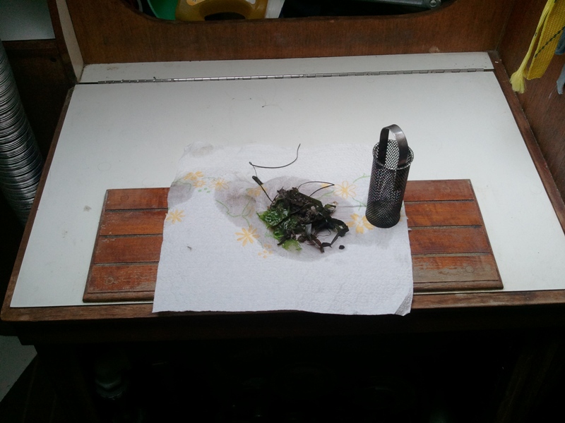

I didn't take a pix of the dead baby catfish that I took out of my A/C raw water coolant strainer this fall. Not as colorful as your detris and stank!

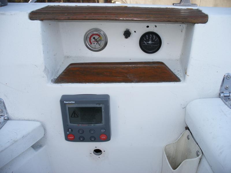

Attached pix of what I already have installed at your points "A" and "B", and may have some room in the "B" area for a vent outlet. The hole below the Autpilot control head is now filled with an LED utility light to light the footwell at night in port.

the gauges are for the filter vacuum and the fuel tank level, and the other thing is the autopilot control head. The are actually viewed facing starboard.
The engine panel is on the port side, set into the aft end of the cockpit locker. I still have to bend over for a peek at the tach to see more accurately what the RPM reading is.

I like the location of the two gauges on your boat. Fuel level..what's that? Isn't that when you run completely out after forgetting that you filled up last year and not this year? Its only happened 3 times! So, in my picture, location B was where your autopilot control is and location A is on the forward surface of the cubby (90 degrees to where your gauges are located). That way you could direct the heat from the engine room and those gauges would never fog up.
And you are right about that stank. We've solved all the stank issues on that boat over the years. Some try and sneak back aboard but we catchem.
