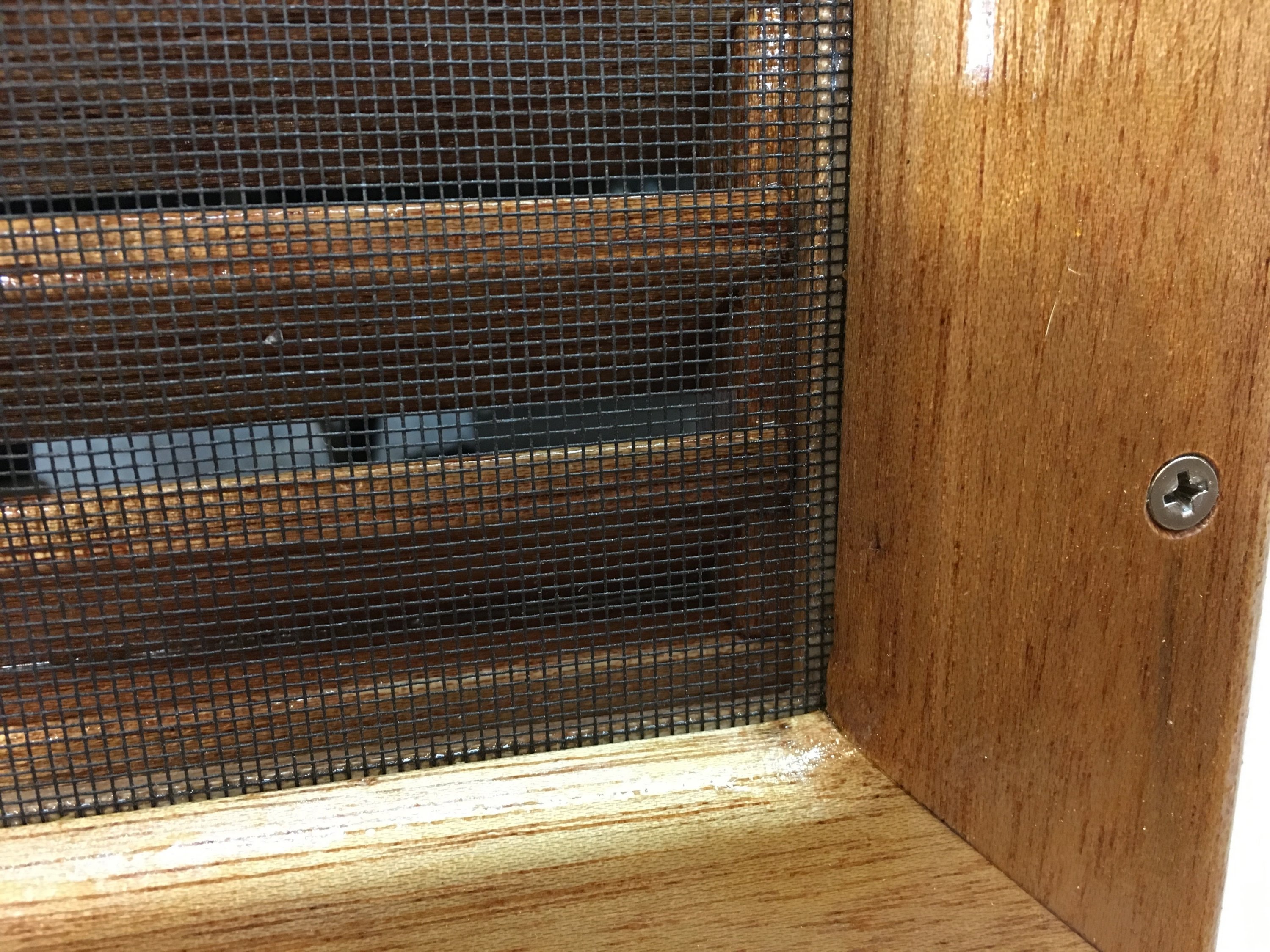

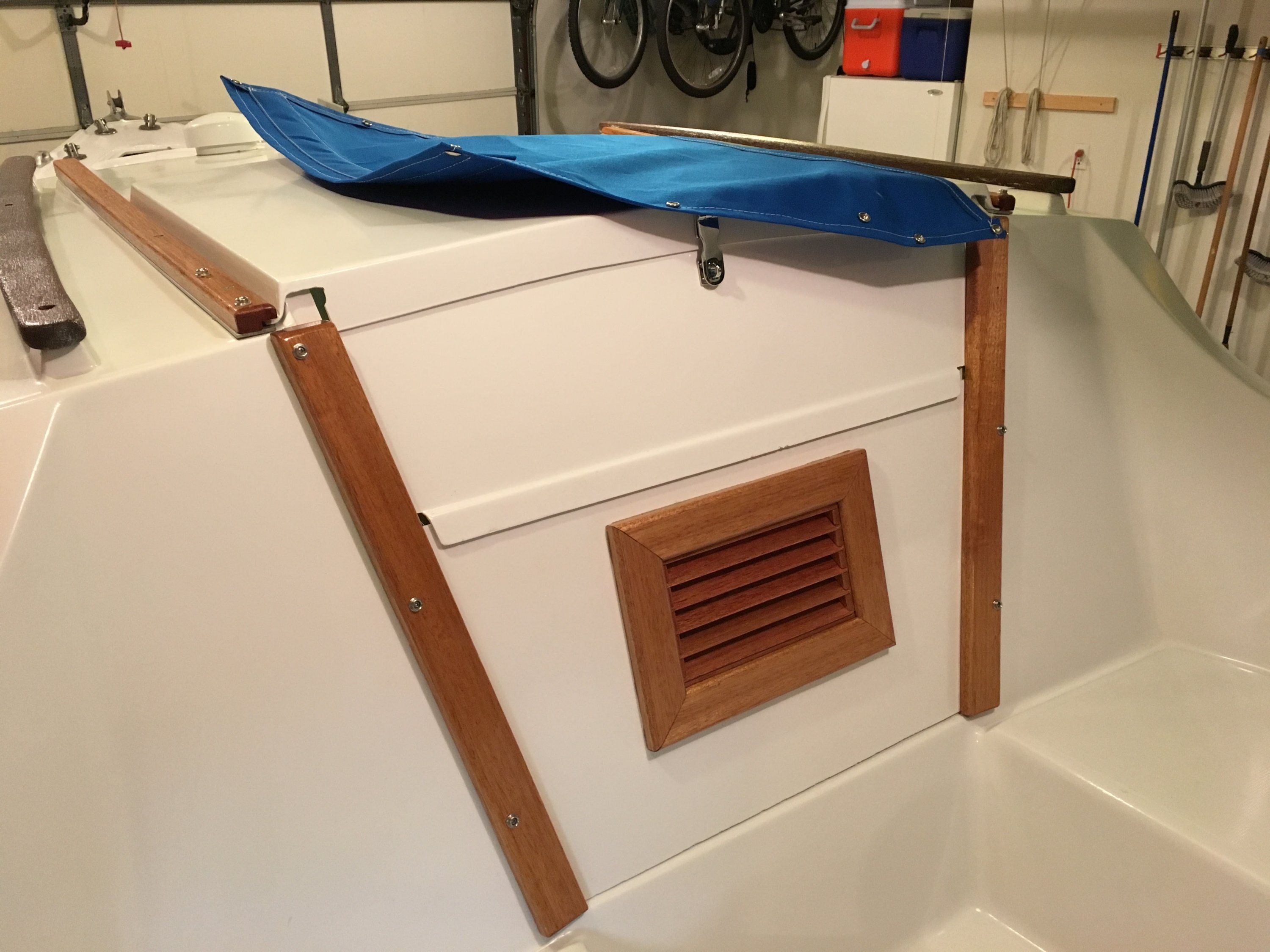

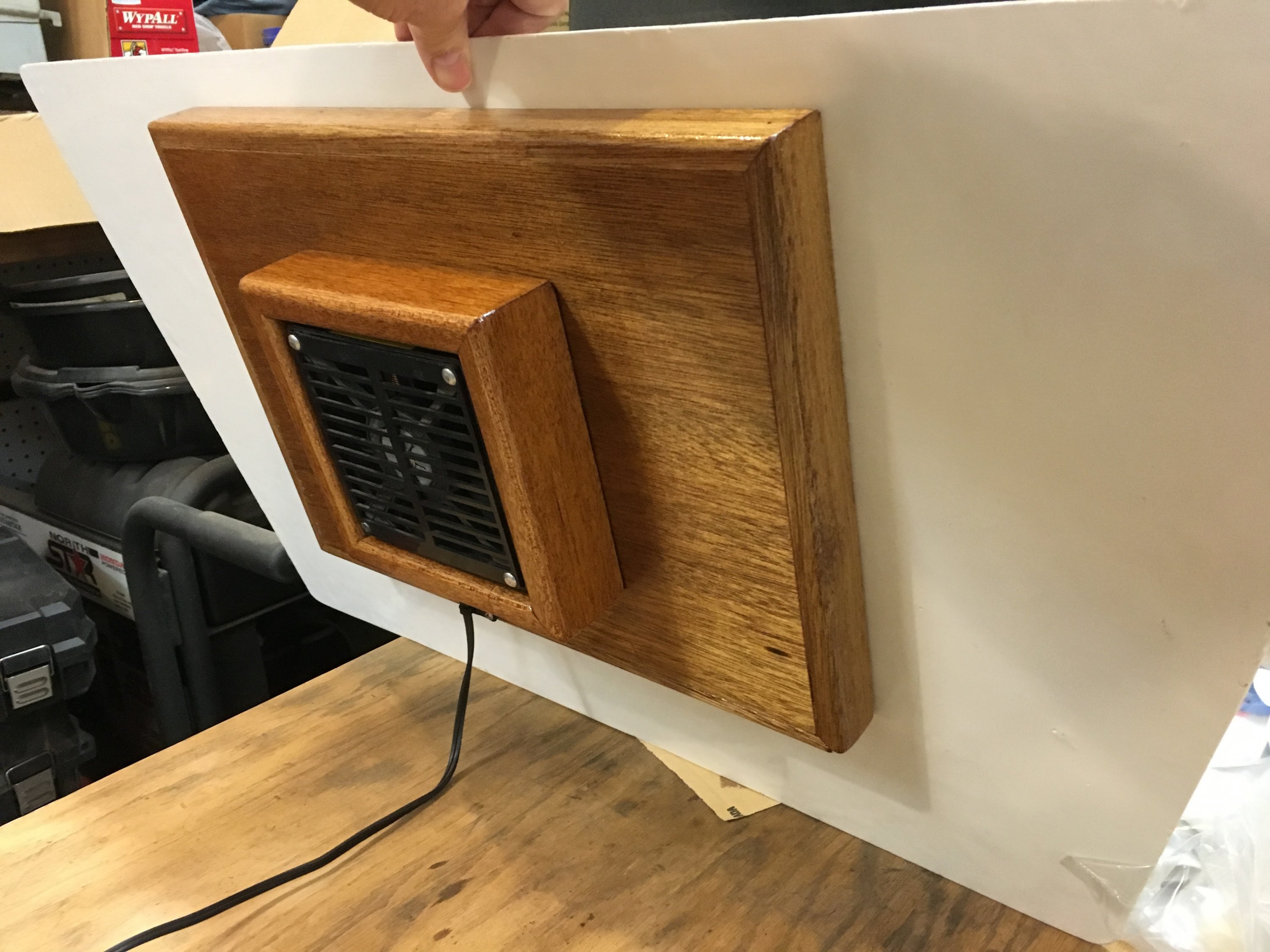

I did have a powered vent system in my last boat. It was a 110V computer fan that was really quiet. It drew air in through a vent in the companion way washboards and blew it out through a dorade on the deck. The trick is to have a screen on the intake so it doesn't suck bugs in! Don't forget, you will need to make the screen very easy to clean because it will suck in all kinds of airborne fuzzies and pollen as well.
I was worried about pulling cold damp air into the boat when evening came around, so I simply connected the fan to a timer and ran it from just after sunset till just before sundown.
It worked excellent.
