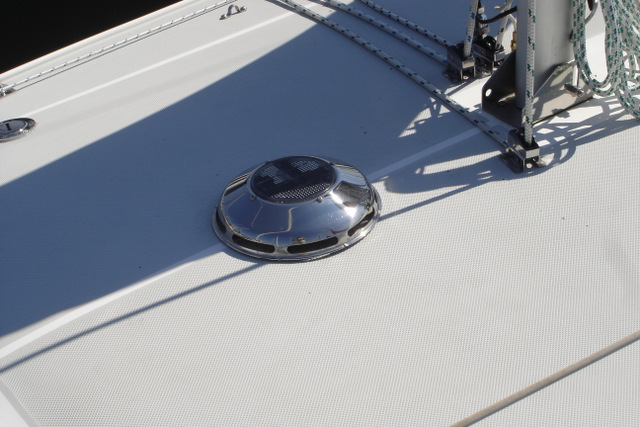

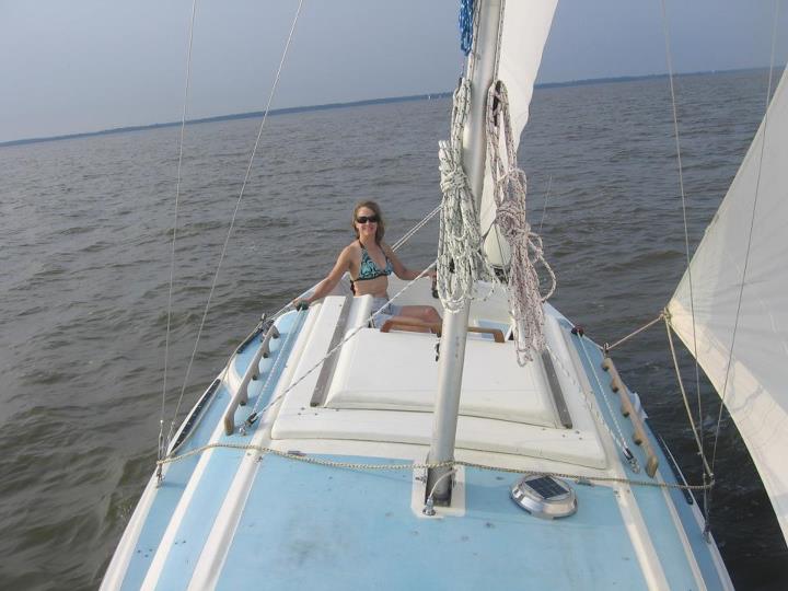

Could just install one of those solar vents directly over the head. I do all my mast work on the starboard side, thats why mine is on the port side, and I didn't want a tripping hazard there. Another option (when not under sail) is to put a battery operated fan in the forward hatchway. WM sells a fan (H20 Cool brand, large 8d-cell one) that fits nicely and securely between the hatch and the deck (the feet on the bottom fit in the drain gutter around the hatch).
