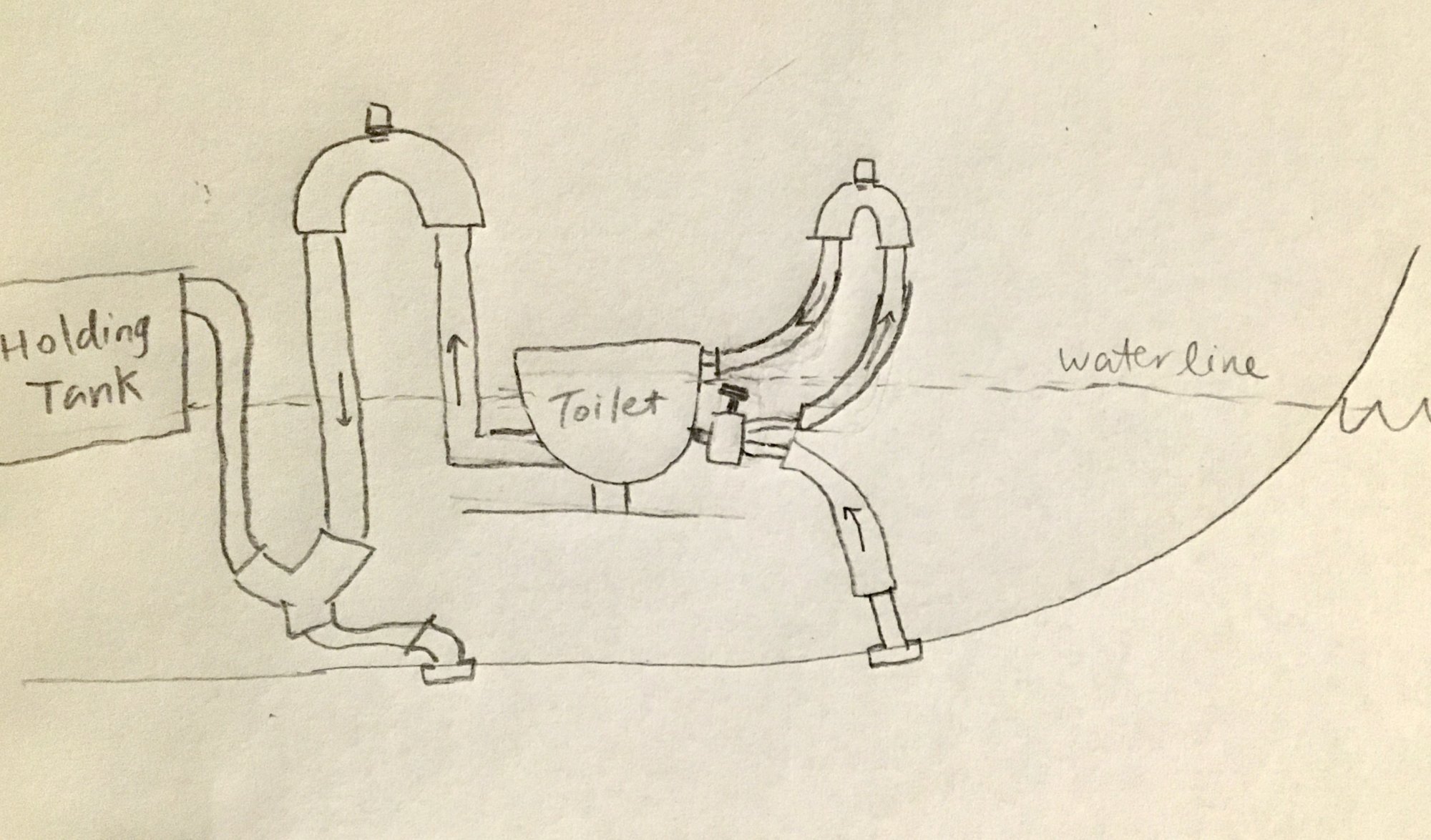

Hello,
I am installing vented loops into my flush water intake and discharge lines. I bought these loops, which come with air valves attached: intake / discharge. I am finding that they squirt water as I attempt to flush the toilet, and I am not sure if it is because they are faulty (they're brand new!), or if there is some other problem with my system. The vented loop on the intake side is between the pump and the bowl, and the vented loop on the discharge side is between the bowl and the Y-valve that splits between the holding tank and the thru-hull. Here is a schematic of the system. One thing that I didn't quite get right in the drawing is that the holding tank is quite high - the inlet to the holding tank might be as high as or higher than the top of the vented loop. I am not sure if that is important.
Thanks in advance for any advice!
Emma

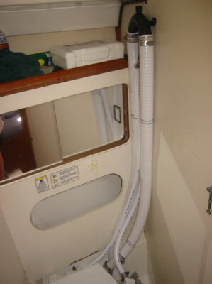

However, though it prob'ly isn't the reason they're squirting, you've also put the loops way too low. They need to be at least 6-8" above waterline AT MAX HEEL, not just when the boat's at rest...which on most sailboats including yours, puts 'em 2-3 FEET above the bowl (See attached photo). That would put the loop in the toilet discharge line above the top of the tank, giving you a downhill run from the loop directly to the tank inlet fitting--or to a y-valve that lets you choose between flushing into the tank or directly overboard...the lines coming off the y-valve should go straight to their destinations--tank and thru-hull...no deep dips in 'em.

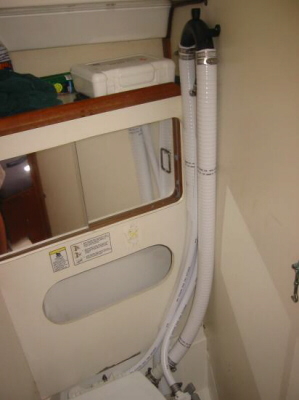

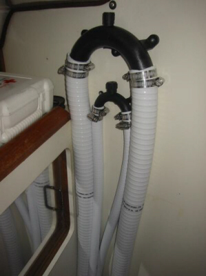

The waterline changes as the boat heels...so it gets higher, the further you're heeled, whether on purpose or due to wind and water conditions. The best place to mount the vented loops is directly--or slightly to one side in either direction--above the toilet. This photo should give you a better idea of how high above the bowl it needs to be.
I hope someone else who knows how to graph the waterline and max heel of the typical 29' sailboat will jump in here with it...;cuz that'll make easy for you see why you can't put vented loops low in the boat.
I wouldn't be too quick to assume that your air valves are defective...let's see if moving the loops to their correct locations in the boat will solve the squirting problem.
--Peggie
