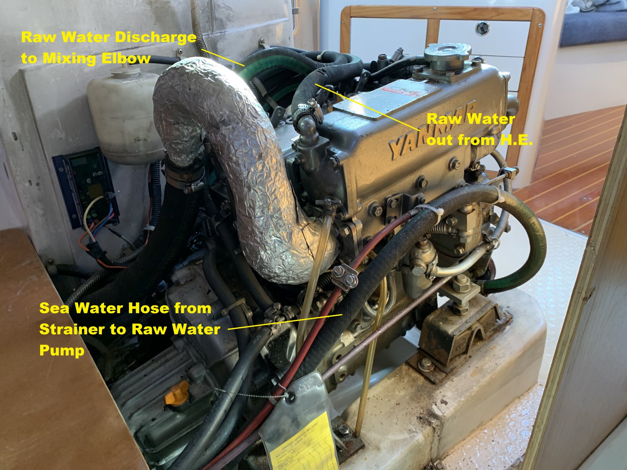

The high point vent, with siphon break, should be installed on the discharge of the sea water pump, and before the heat exchanger.
When you stop your engine, water can still flow into the open valve on one engine cylinder.
Not to worry about the exhaust, unless you are in heavy seas and the muffler water sloshes backwards.
That siphon break is needed, if your fresh water pumps bypasses or is worn.
Jim...
PS: Water pump pressure closes the siphon break valve, then opens when no pump pressure.

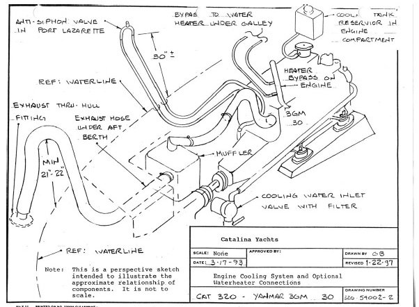

Just to be clear, I did not say that the lack of a anti-siphon break in the raw water hose could sink the boat. I said that having one could save your boat in an extreme situation. Ok, it could save your engine ... mea culpa. I normally wouldn't find it necessary to defend this minor point, but your histrionics seemed to warrant it. ;)
If you need my definition for the point of discharge for the raw water hose (after the anti-siphon break), I define it as the joint at the mixing elbow, which is definitely well above water level. You seem to be relying on the hand-drawn sketch in the manual for your information. You should realize that it is just a schematic and it really does fail to show the origin and termination of the raw water hose. It only accurately portrays the location of the anti-siphon vent. Here are the actual connections:
The raw water pump feeds HE in a direct feed. (Just to show how confusing all the commentary can be, @JamesG161 seemed to indicate that the anti-siphon should be between the pump and the HE.) After circulating thru the HE, the hose exits the top and winds 11' over to the port lazerette before returning another 11' back to the mixing elbow. Both connections are well above water line, contrary to the poor schematic that seems not able to define the ends of the hose. Of course, it would be a closed system all the way from the sea water thru hull to the mixing elbow and there could be the potential for a siphon, I suppose, if the boat were heeling to such a great extent that the mixing elbow was below seawater level, but I really believe this could only be a very rare occasion.
So, the cost of the hose and anti-siphon (I'm installing new) is a little less than $200. The labor is a little intensive, given the location of the vent. Yanmar says that you only need about a 12" length of hose to make the direct connection. I concede against common sense and will install the anti-siphon. :biggrin:
Perhaps I didn't need to open this thread. I certainly know how a siphon works and I know when an anti-siphon vent is absolutely needed. Many of these devices are installed, it seems, as a precaution against certain rare occurrences. Certainly, many folks have testified that they don't have one in this circumstance and they never knew they needed one. I'll give you a hint ... they don't, necessarily. I asked the question to find out if there are any clear answers. It turns out that there really aren't. It seems that there are just a lot of strong opinions and most seem to be completely impervious to actual science and to nuance.

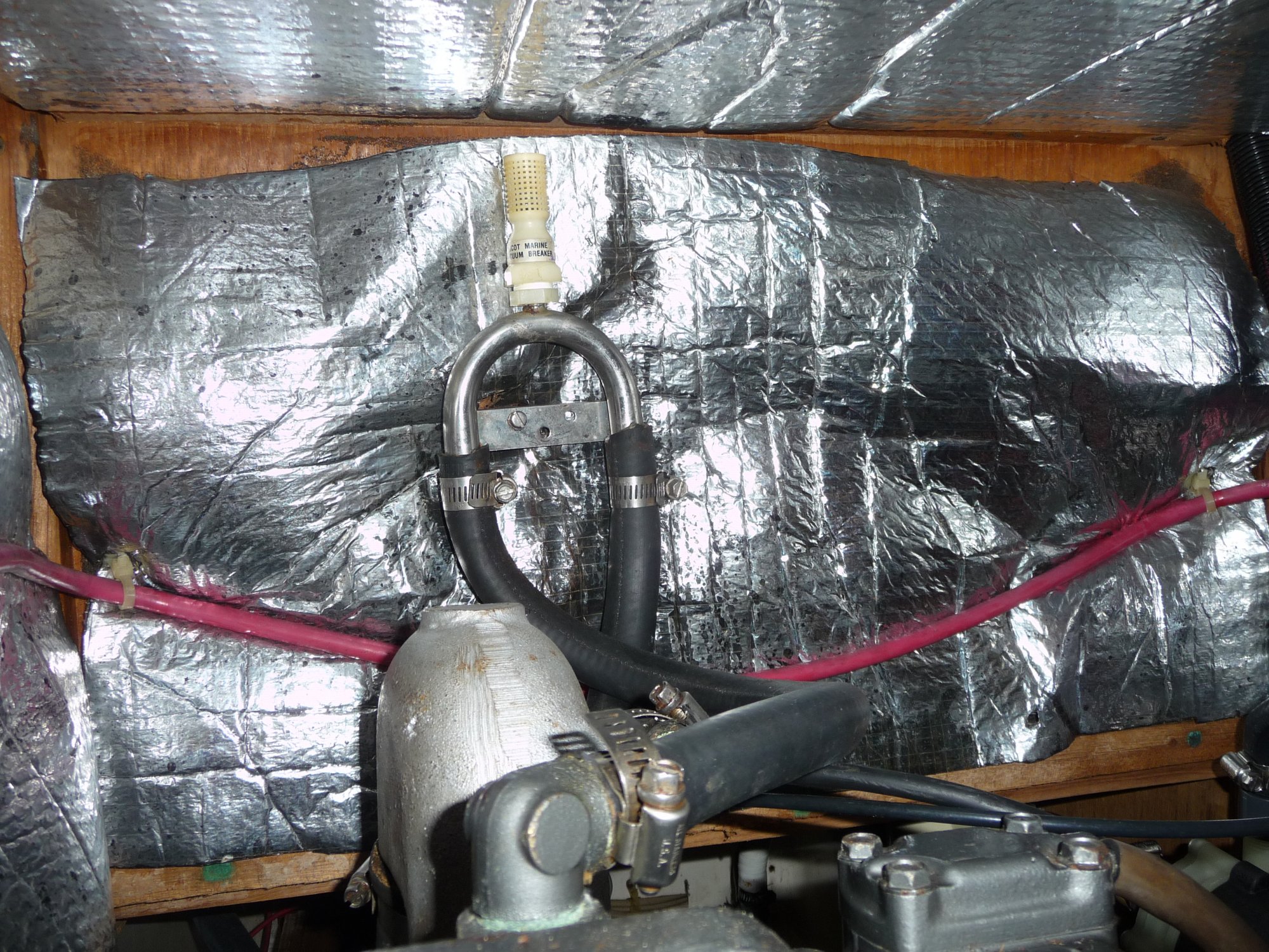

Here is what it looks like on the H-34 .. same engine configuration.. Vented loop is between the heatex and the exhaust ell injection.. It is slightly lower than the top of the big loop (not vented) in the exhaust hose after the muffler and before the thru-hull..
That was ideal spot, but your HE is more accessible than a few engines.
The siphon break is needed, even if it is down stream of the HE.
Here is the kicker...
That siphon break valve is pressure to close, thus more pressure nearer to the pump.
You need to maintain that valve too. So it must be a spot easily accessed.
I guess, if you see a leak on that valve [engine running], you might be seeing a restriction on the HE, or wearing water pump.
Down stream of HE is ok.;)
Jim...
PS: The height of the siphon break is not critical , as long as it is above the engine and boat water line.
