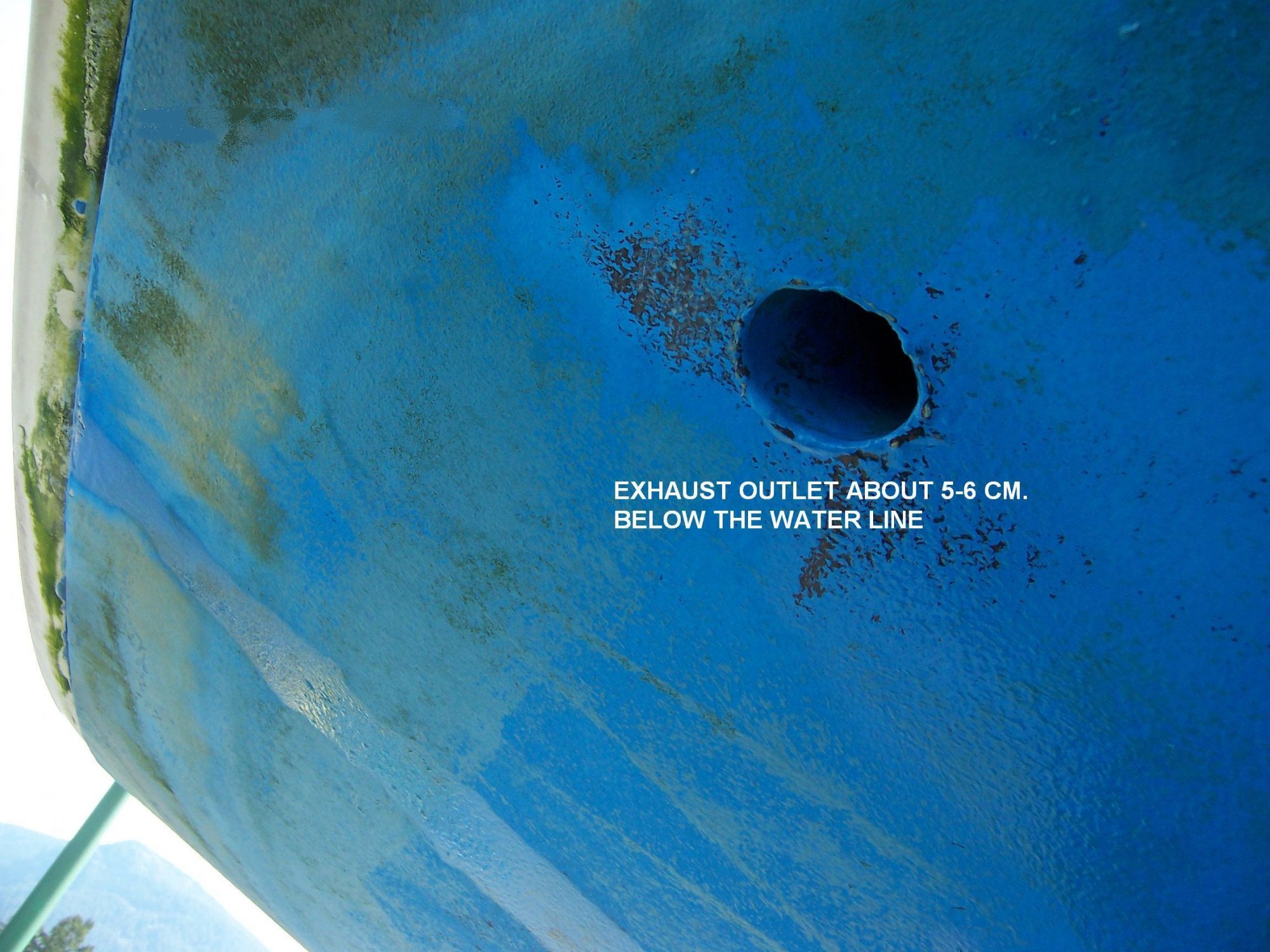

In our boat the exhaust hose is looped upward from its exit from the water-lift muffler. The top of the upward part probably adds a couple of feet to the total run. That does bring it up to just under the lip of the cockpit seat locker. I believe that this is needed to prevent possible back flow from the stern-mounted exhaust fitting. I have seen other boats with a similar hose routing scheme.
An approximation of the height, knowing the outside waterline would put this at least 2 feet above the DWL.
Running down 5' seas in the open ocean we have submerged the exhaust exit for short periods of time, altho the engine was not running at the time. Probably good to know that a surging bunch of water will not flood the muffler and then the engine.
(Some cruisers have traditionally installed a seacock at the exhaust outlet on their transom just to prevent such a catastrophe, albeit with a notice posted by the key to open this valve before starting the engine....)
