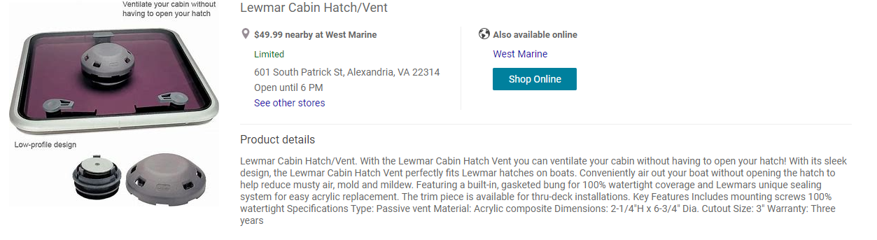

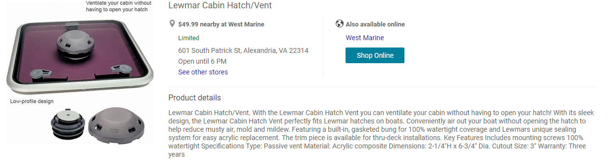

Here's one alternative that I've purchased (at a steep discount on a West Marine sale table) but haven't installed yet. It requires you to cut a circular hole in your hatch to install, and is passive, but appears to be safe from green water over the hatch (and even if not the water intake would be very minimal). I haven't talked to anyone who has actually used this, but I do see them as standard equipment on newer boats:

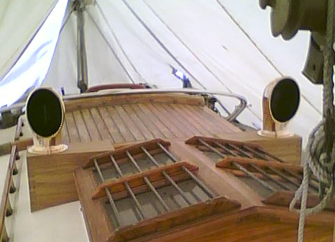

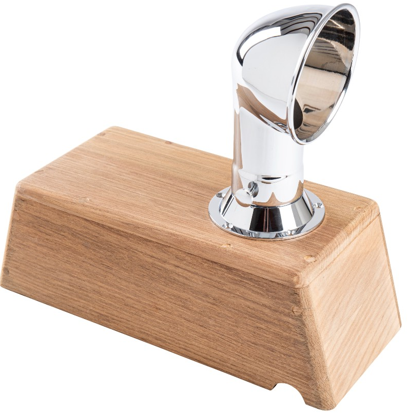

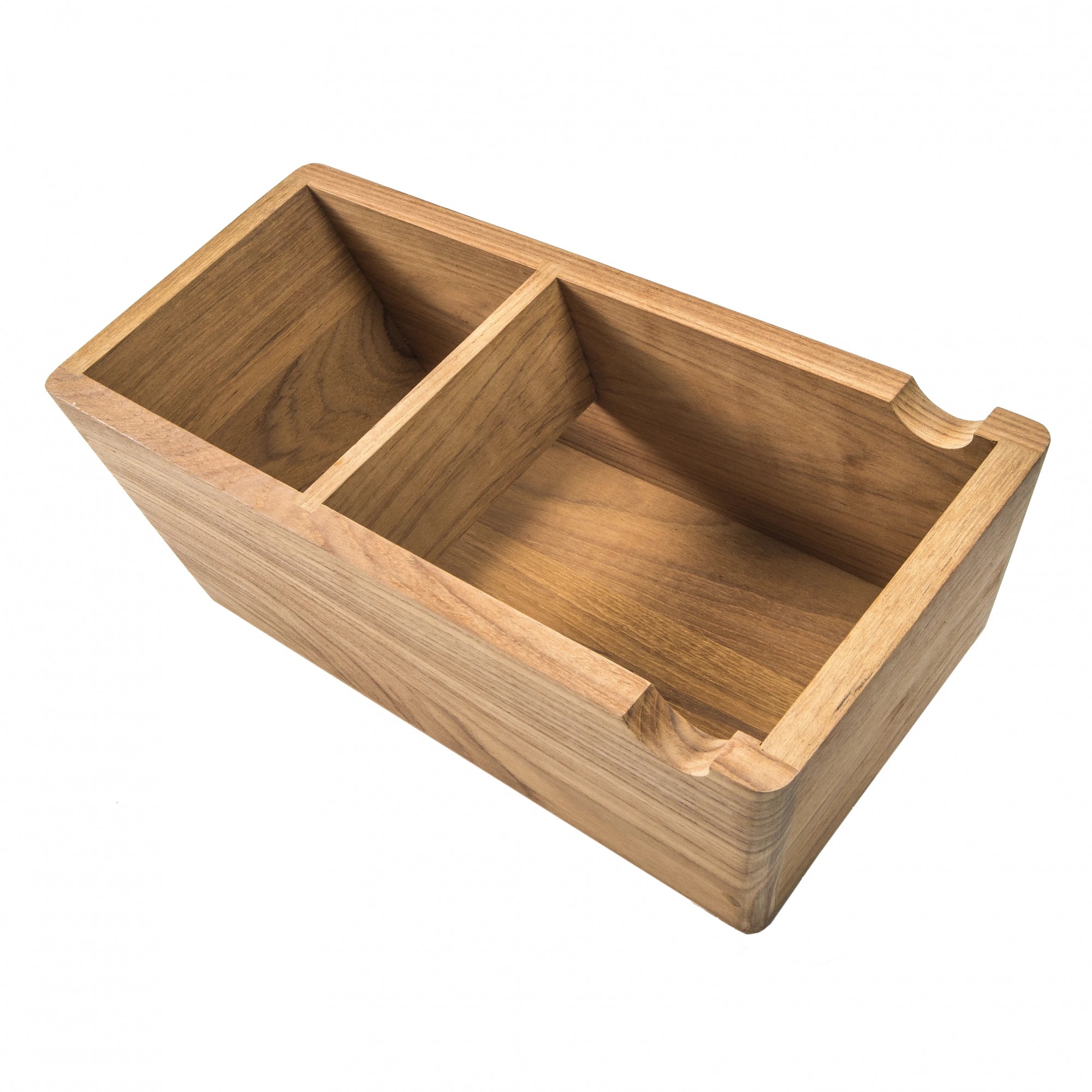

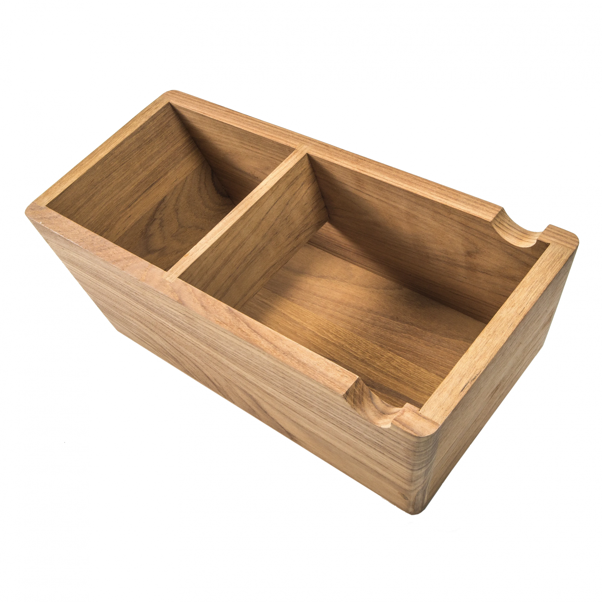

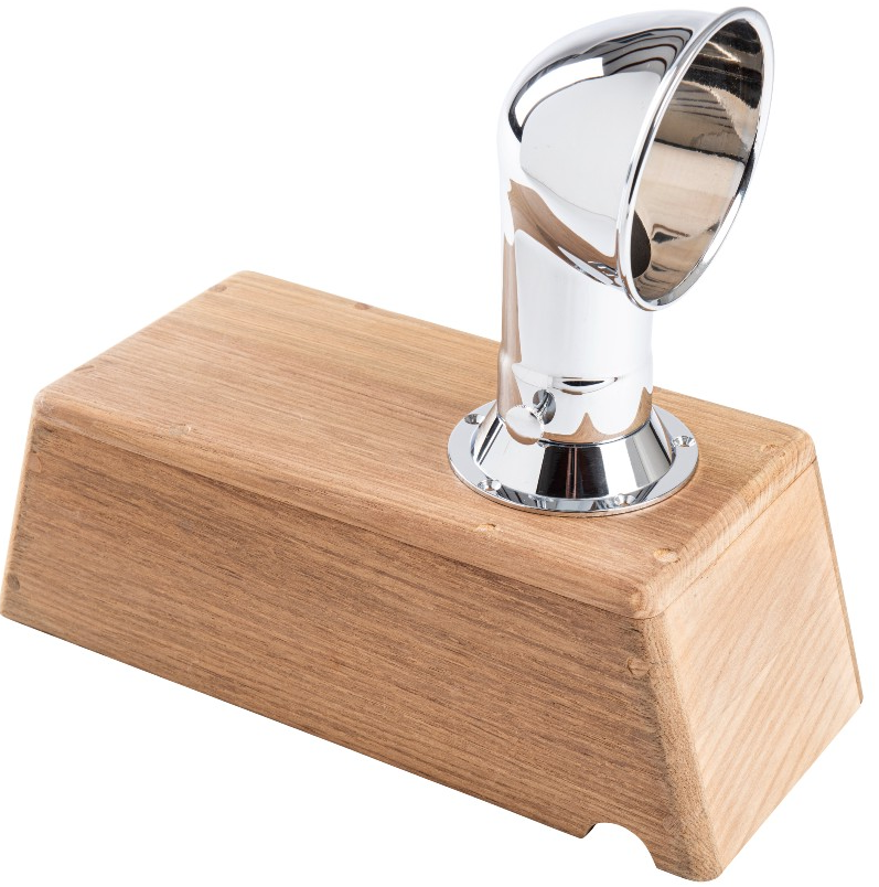

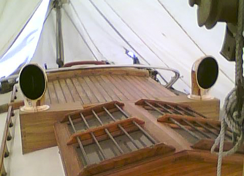

I think a dorade box is essentially the boat equivalent to what you had on your RV

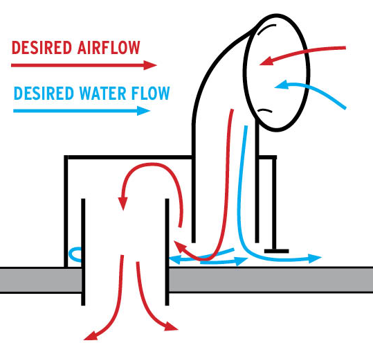

If a wave does crash over and into the opening, presumably, it can't reach the vent hole.... and then the water can drain out the weep hole.

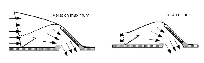

The airflow diagram has an error in it. If you point the opening aft, then then the air will flow over the back side of the cowel (as shown) but that will create a vacuum that pulls air out of the boat instead of pushing it into the boat as shown here.
View attachment 206323View attachment 206324View attachment 206325View attachment 206327
and here I thought those were wiring conduits for solar panels ;-)
I don't have any of those installed on my cabin, so it would have to be a retrofit. I like the idea though, and I could potentially install a fan at the interior. I wonder if I could put one in at least the rear hatch, or if I would come to regret it.

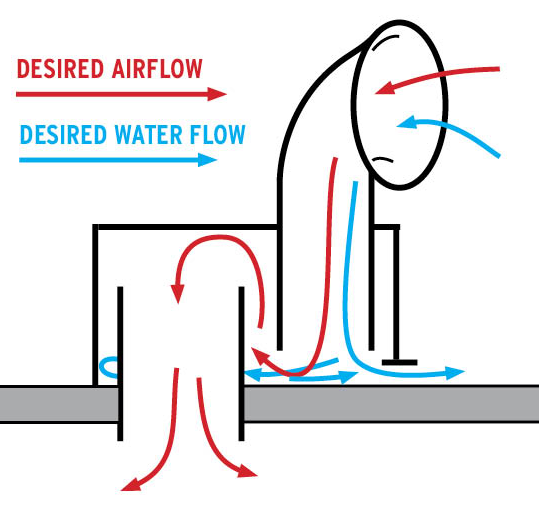

Okay so the schamatic diagram was bugging me so I edited it.
Here is how it should actually be set up.
Unless you are on a run, the wind should be coming over the cowel vent and not scooped into it. This will cause a vacuum on the backside and that will pull air out of the cabin. Breaking waves will also likely come from forward and the backside of the cowel will prevent the majority of the water from entering the box. What little does then drains out the weep hole and never enters your cabin (in theory)

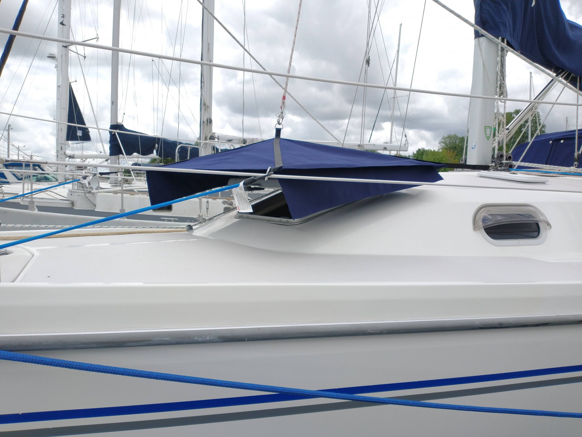

I have a water proof cover that covers front hatch and goes forward of hatch about 2 or 3 feet which
let’s air in and rain out and we sleep at night with no worry about rain while sleeping and keeps hot sun and heat out for us here in Florida
Homemade, or did you buy it?

Would love to see a photo Seadaddler. I have a bunch of leftover Sunbrella from a lee cloth project and I'm trying to figure out what to do with it.
