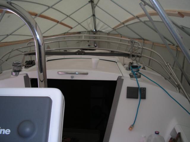

Now that the oil is changed the water and toilet winterized and the boat is under canvas is it OK to leave the hatches open to improve ventilation. Last season I didn't cover the boat and come spring there were mold spots all over the cabin. Today I visited the boat and saw quite a bit of condensation inside. It has been raining the last few days but the topside was dry. I left the hatch open. I know you can use some type of desiccant to absorb moisture which I need to do. When your boat is wrapped do you close the companionway and windows or do you leave them open to improve ventilation?

I assume these solar vents are permanently mounted into a hatch. Ross, yours in a cowl. If your boat is wrapped how does the sun run the fan?

Your panel is obviously outside your cover. I googled the Nicro fan Mainesail was taliking about and it looks like one that would be mounted directly to a hatch. Great idea but I'm under a canvas. I would need to find a way to mount a panel outside the canvas. I have a "to do list" a mile long unfortunately money and spare time are limited. This year I shot my ward on a custom canvas cover that I hope to get 10-15 years out of. I love the idea of a permanent solar vent. I hated sleeping on the boat when my pillows are damp! Humidity up here can be opressive.

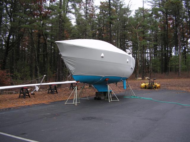

Sorry, we shrink wrap with white shrink material and it lets enough light through so the Nicro works.. I'd guess with a dark colored canvas it would not work or be marginal at best..

You could ask a sailmaker to install a vinyl or isinglass window over the vent locations...so they'd get enough light to operate for at least part of the day.

I have a small 5 watt solar panel I will mount outside and try running a 12 volt fan. I think the green cover is too dark to permit a solar panel to work from the inside. Any reason why I couldn't leave the companionway doors off?

I would worry about theft... and also if the cover doesn't seal to the hull tightly, you may get wildlife inside the cabin... that could be very bad. :)
