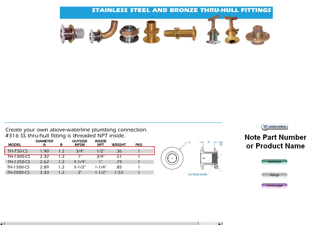

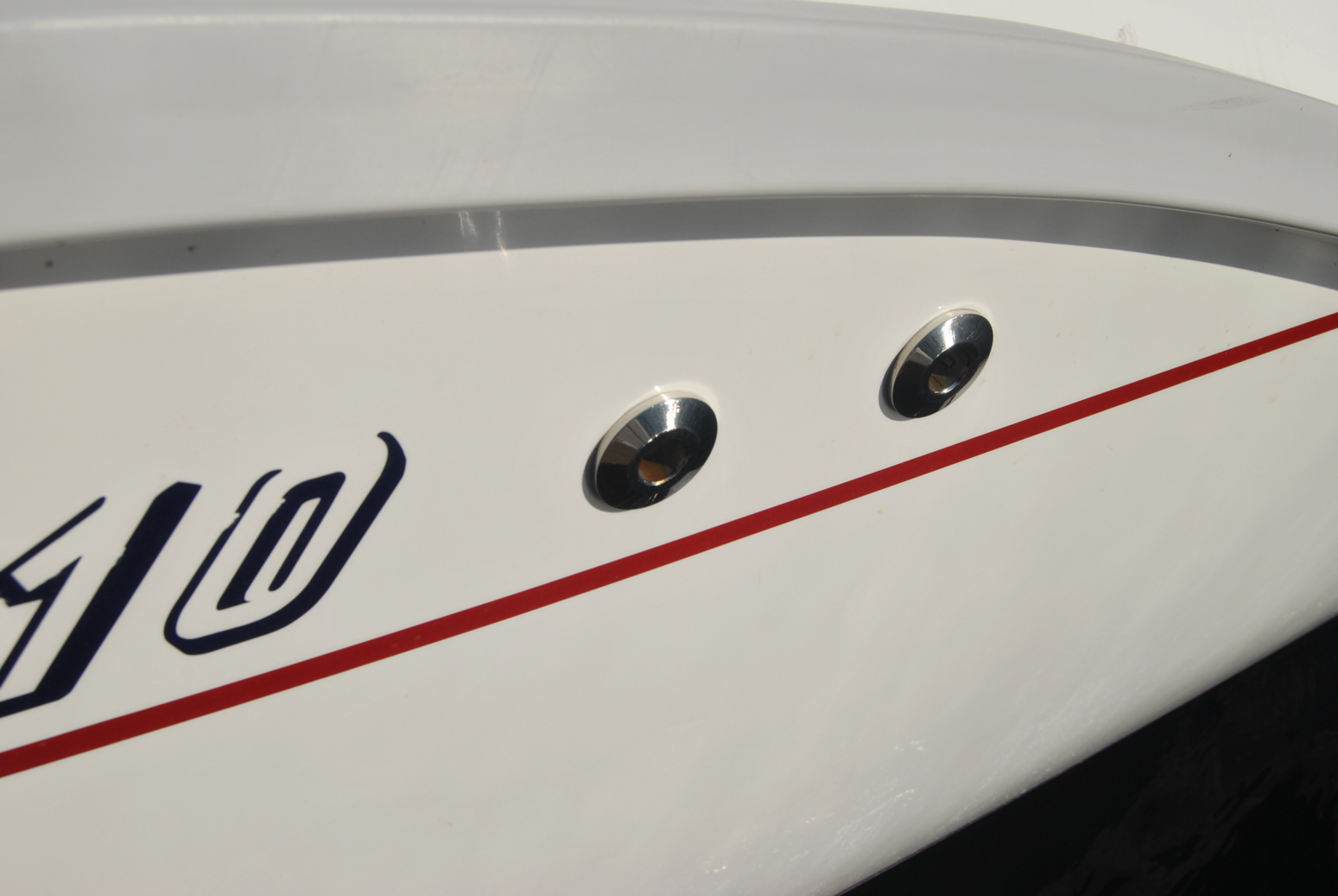

Brass vent caps corroded like crazy. Nickel plated brass (or bronze).
Present :
New ones are SS with internal loops of about 18" up to the underside of the deck.
With the internal NPT thread in the thru-hull, you can pull a quick upwards turn with a street ell 90° elbow and into a hose loop before heading off to the tank.

Thanks for info & pics. I never thought of these. They look great!
