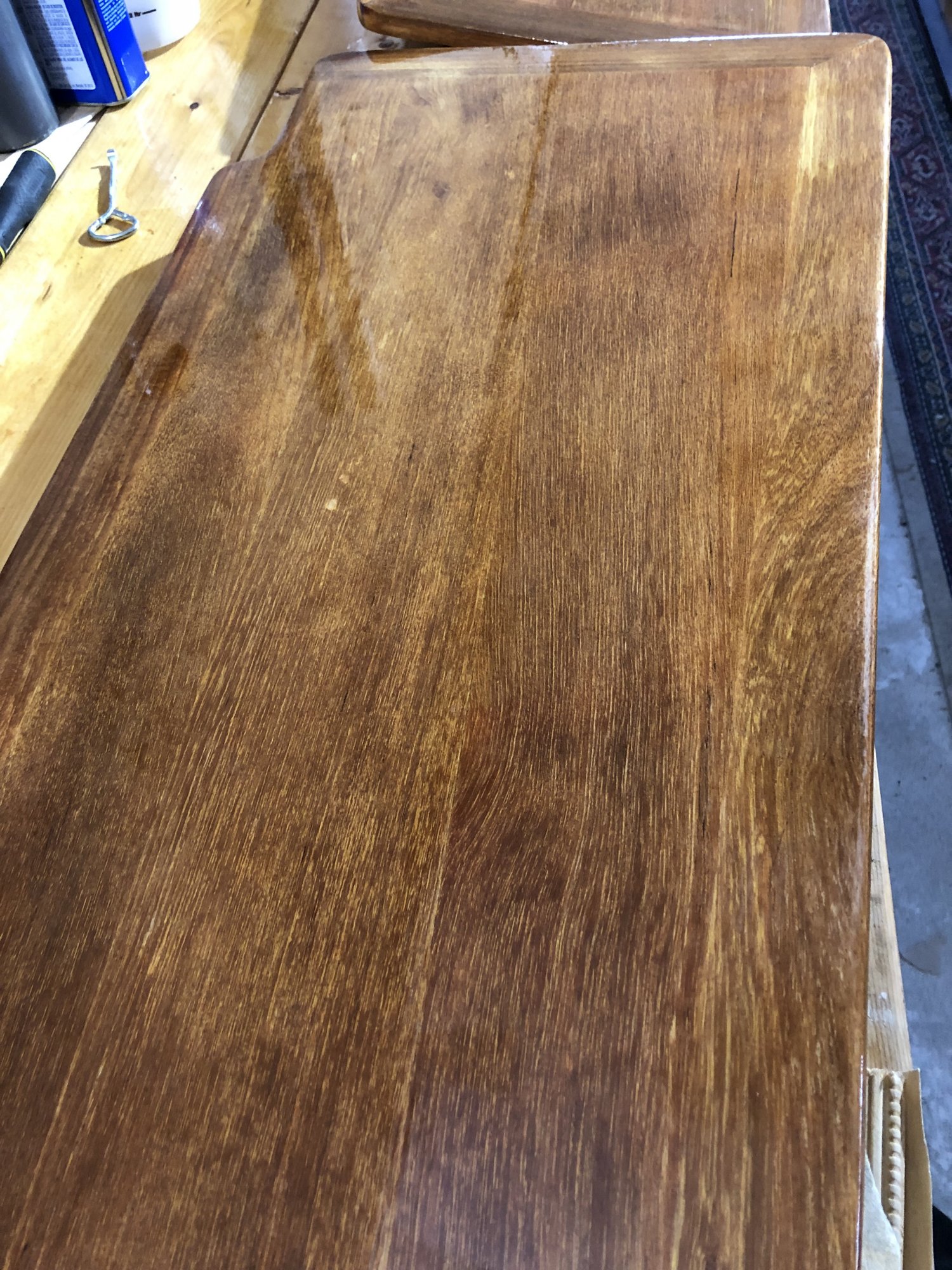

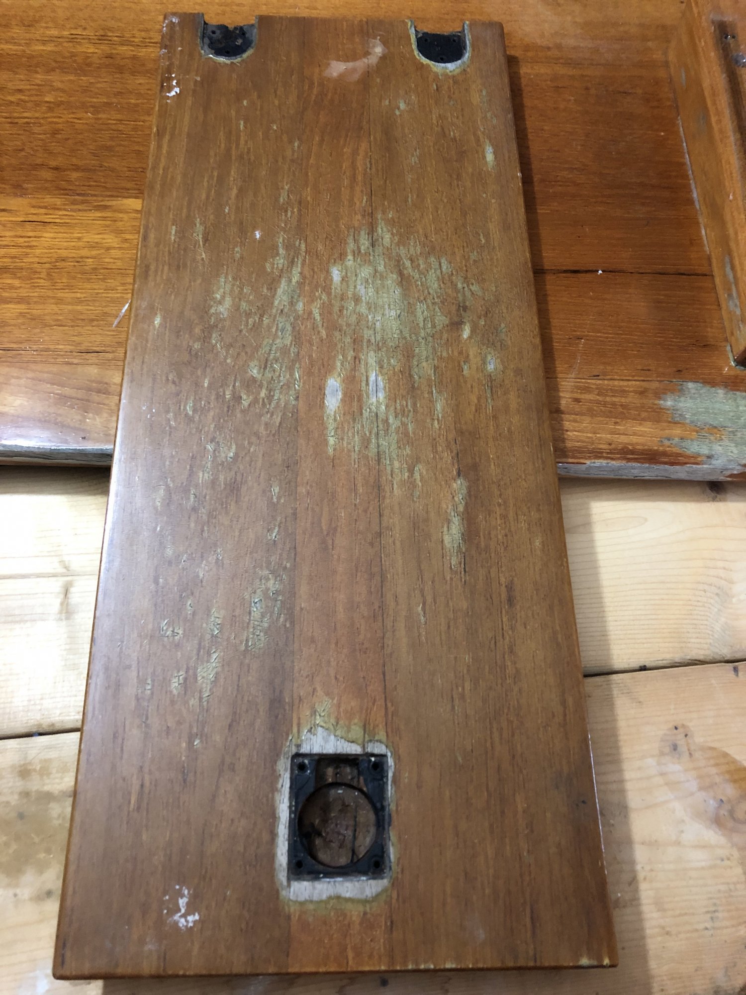

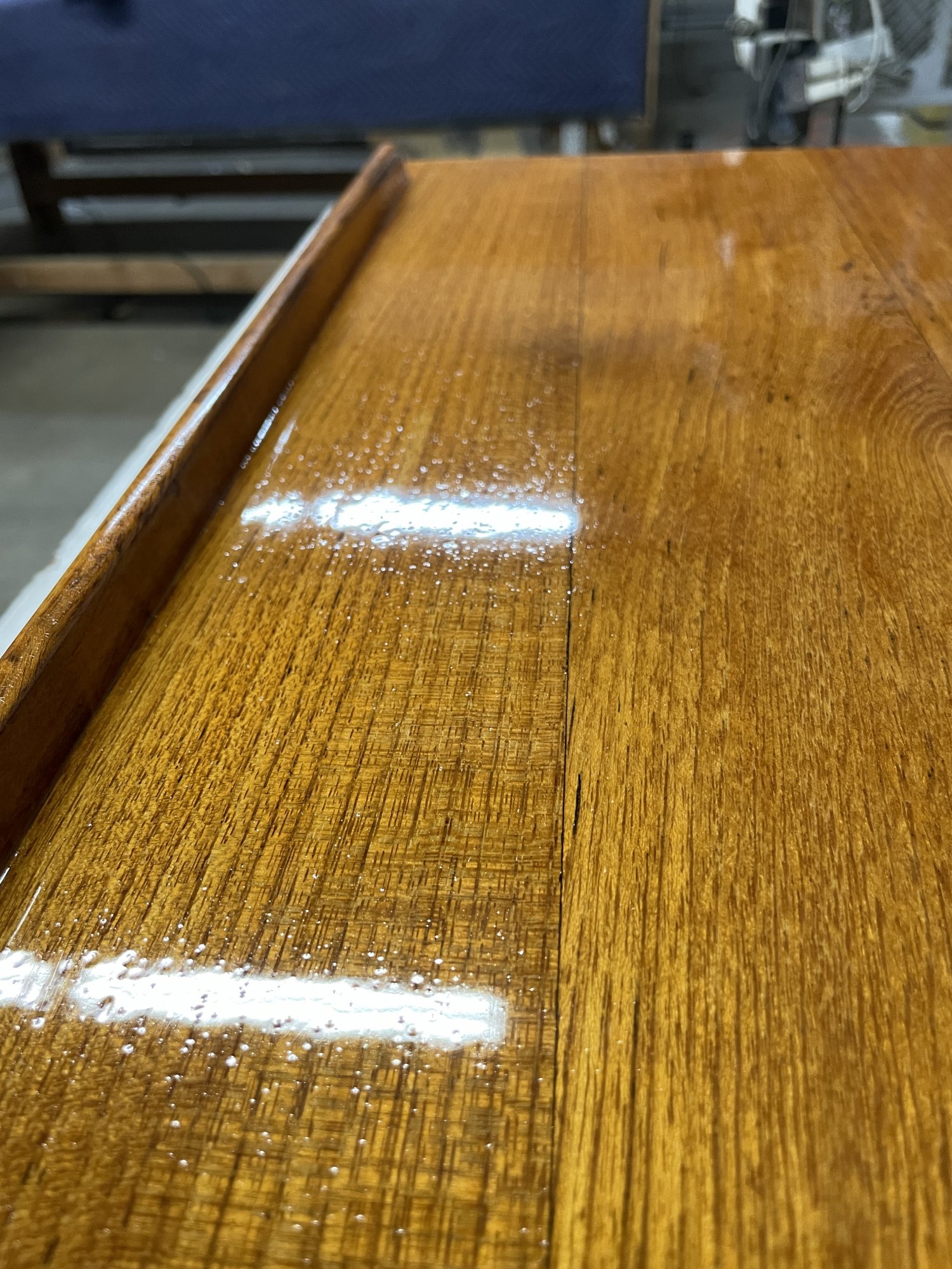

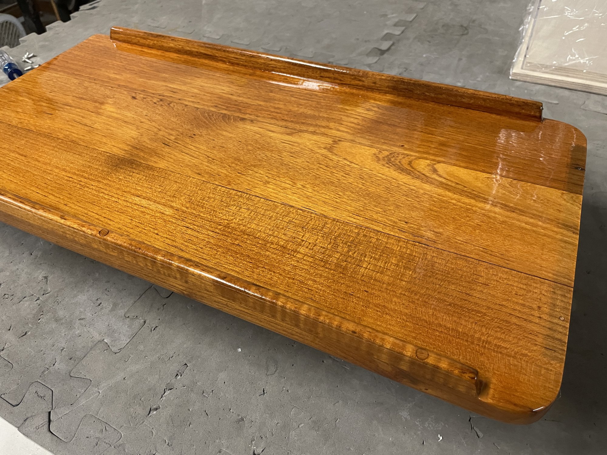

I'm trying to teach myself how to varnish. I have a lot of teak on my boat exterior i want to varnish, so thought i would start with some simple projects to get the hang of it.
I bought a liter of Le Tonkinois Original varnish a decided to start with my cockpit table. I sanded the table to 400 grit, smooth finish, cleaned it well and applied three coats so far sanding between each coating. From a couple feet away the finish looks amazing. I'm really impressed so far, however if you look at the finish at an angle in the light, there are countless little tiny what look like microbubbles evenly disbursed over the entire finish. Its not settling dust, i noticed the formation of them immediately after i 'tipped' the surface. It almost looks like micro air bubbles like you see in some epoxy coatings rising to the surface while it cures. Im using a decent synthetic brush but certainly not a great brush. Its probably a $15-20 Home Depot 'Purdy' brush. I'm working in 75degree low humidity shop, perfect conditions.
I tried taking a picture of the surface but its really hard to see what im talking about from the pics. The camera males it look more like pinholes. Is this problem common and due to using the wrong brush or technique, or is this common for this particular varnish? I have seen pics from people who use this varnish and their surface looks like glass. I dont really need a perfect glass finish, especially for a cockpit table, but i'd like to get it a little better for the exterior teak.
Thanks for any insights.

I can't really tell from the pictures, but it sounds like it might be surface contamination under the new finish. Did the table have some sort of finish before you varnished it? After you sanded it did you wipe down the surface with a solvent? Teak is very oily and should be wiped down with acetone before re-finishing or gluing.
Do a Google search on "fish-eye" or silicone contamination and finishing. Depending on how much it bothers you, your only recourse might be to sand it all off and start over.

I can see the tiny bubbles you describe. They appear to me to be solvent evaporation. The previous surface was not cured before you applied the next coat. I’ve not used the varnish you describe. I would examine the manufacturer’s requirement for cure before applying next coat. Your cleaning solvent may not have completely evaporated before you started to apply the next coat
I watched a worker at the Mystic Seaport Museum Shipyard applying varnish in the open dock area to the bright work of a boat being restored. Conditions were open to environmental contamination, 83 degrees,
full sunlight. Application tool a cheap foam brush. He stated he wished he had a quality brush. Varnish was Awlgrip. He said the shop applies the product hot (surface is dry to touch, not tacky) so no sanding required between coats. 2-3 coats per day.
Standing 2 feet apart at the gunnels of his boat the bright work looked great. No bubbles of contaminates were evident. I was a bit surprised as the work place was exposed to the environment.
To address your project first assuming the bubbles are unacceptable, you need to strip the table back to bare wood. You might explore another varnish product. I have been getting good results using Total Boat varnishes. Follow the instructions regarding application, cure time for each coat, sanding between coats, cleaning of sanded surfaces, use recommended cleaning chemicals, allow dry time after cleaning so that all solvent is evaporated.

It had Cetol previously. I scraped the cetol off with metal scrapers, sanded the teak with #120, #220 and #400 sandpaper then cleaned a couple times with alcohol before coating. The first coating i did did not have this problem.

Thanks Dave. Good stuff. I was wiping the brush several times after dipping against the side of can. I read this in another forum last night and think this may be part of the problem. I will try again today NOT doing this and see if it makes a difference. Might also switch to a natural brush. Have a few lying around.

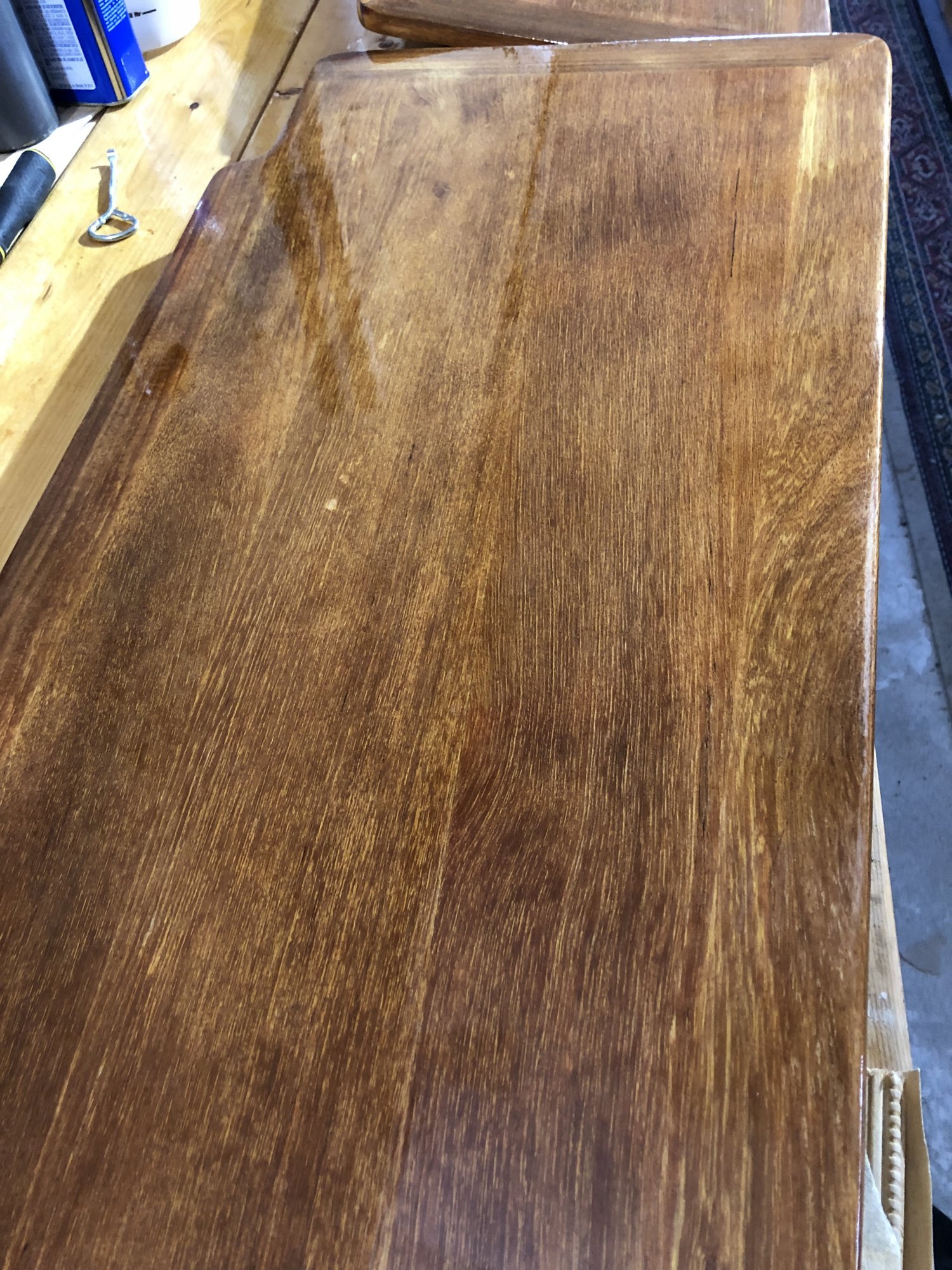

My table has this amazing slight cherry red color. The picture i posted looks brown, but its not really that color. If i can get the rest of the teak that redish color i would be very happy. Its what i imagine teaks perfect varnished color before ii even began. fingers crossed.

I realized after reading this that i did sand and wipe the surface with isopropyl alcohol to get the sanding dust off and did varnish it fairly quickly after that. I wonder if the alcohol seeped into the previous surface a bit and was evaporating? I figured alcohol would be the most mild solvent to clean it with but maybe not. I will try today without wiping with alcohol. Le Tonkinois recoat is 24 hours and the surface is very hard so i think my recoat time is ok.

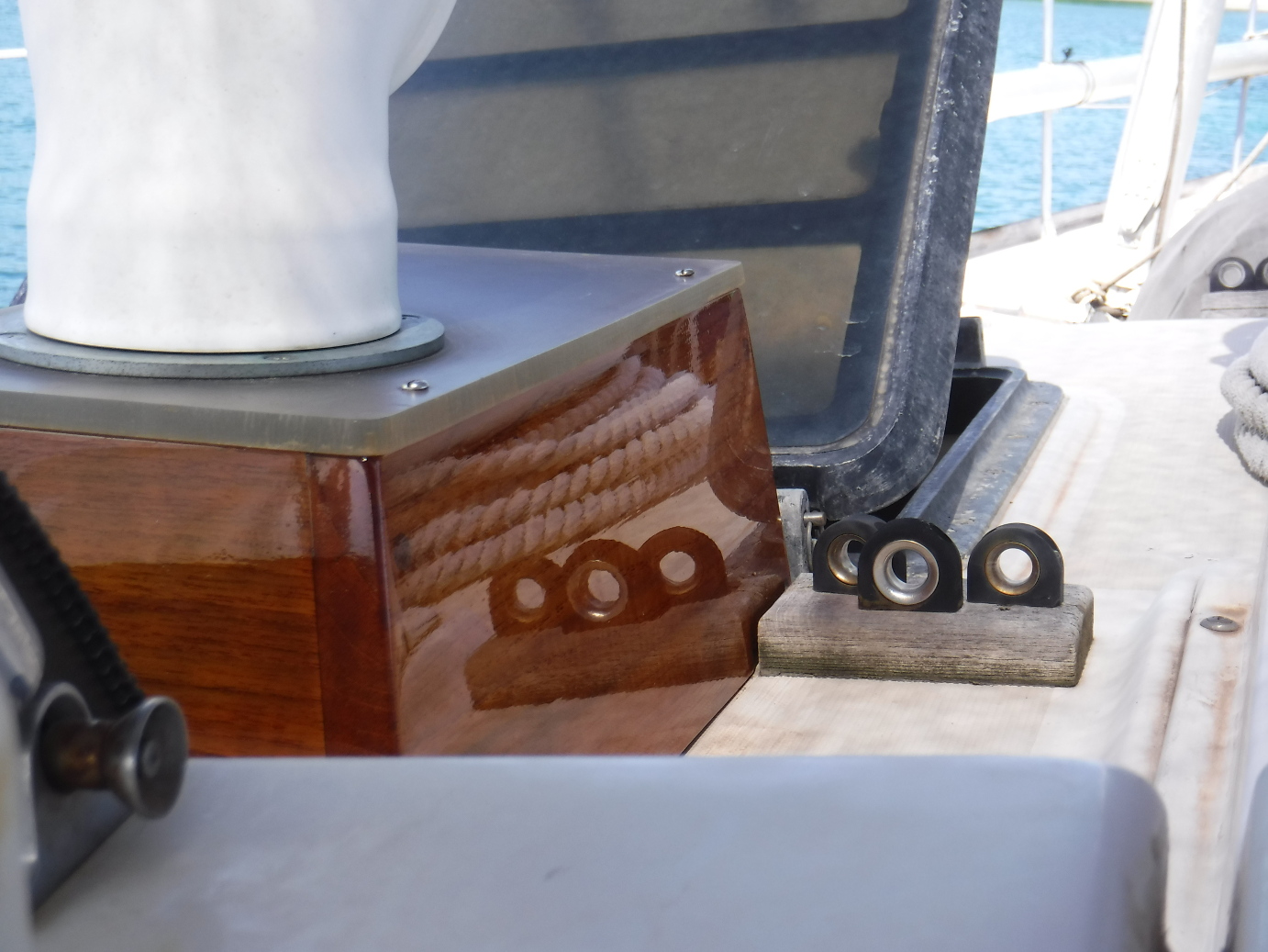

Of course, all the info is important, but from my experience, it's about preparing the wood.
Any old varnish must be completely removed and the surfaced and sanded smooth, around 400 grit. Then a teak cleaner, I like "Snappy Teak-Nu Two Step Teak Cleaning Kit" best, but be careful, the stuff is dangerous. Wear safety glasses, gloves, and protect painted and metal surfaces from teak cleaner.
After cleaning the teak, the grain will have risen again, and it needs to be sanded to around 400 grit a couple of times, then repeating with 600 grit until it is very smooth. As above, use a tack cloth after every sanding. You do not want to varnish over sanding dust!
At this point I put a couple of coats of clear wood sealer on, thinned on the first coat. Sand to at least 600 after the clear wood sealer has dried. Now your wood is sealed from the elements, and you have something to varnish to.
Now is the time to thin the varnish (I prefer Pettit Z-Spar Captain's Varnish 1015) at least 50/50 or even more.
See above posts from here, just remember to sand between each coat, using a finer grit each coat after you are at the working strength. Sometimes full strength varnish just isn't possible, so don't feel any instructions on thinning are binding.

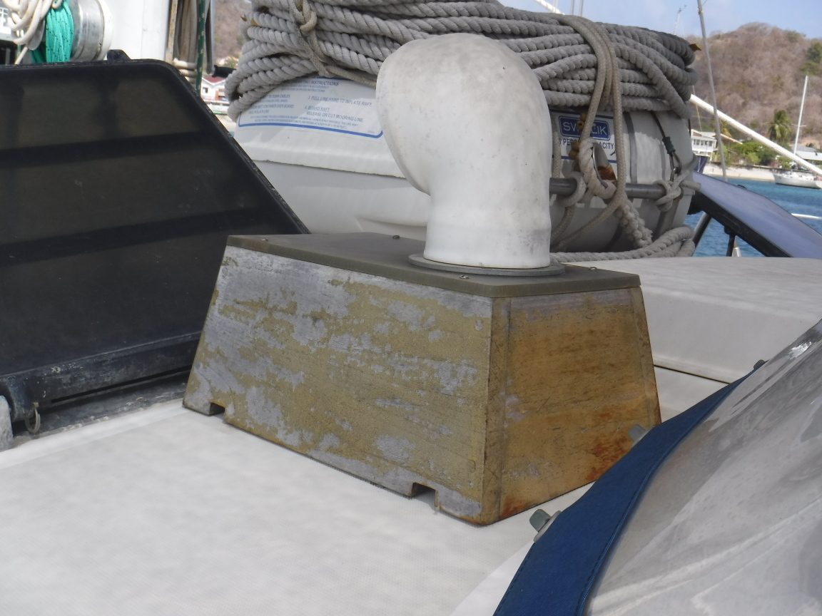

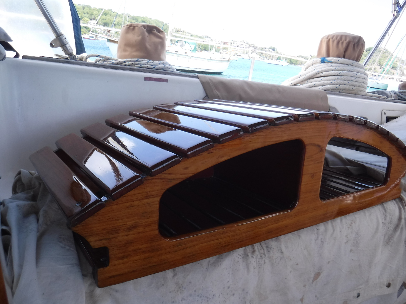

Below is varnish done aboard Skipping Stone at anchor. The before & after on a dorade and the helm seat, which was just too complicated to do well, in the time we had.
24,615
I like your thoughts, @capta. I have a dorade resembling the "dorade old box 1" image.
Maybe I can get it to look more like the reflection image in time.
