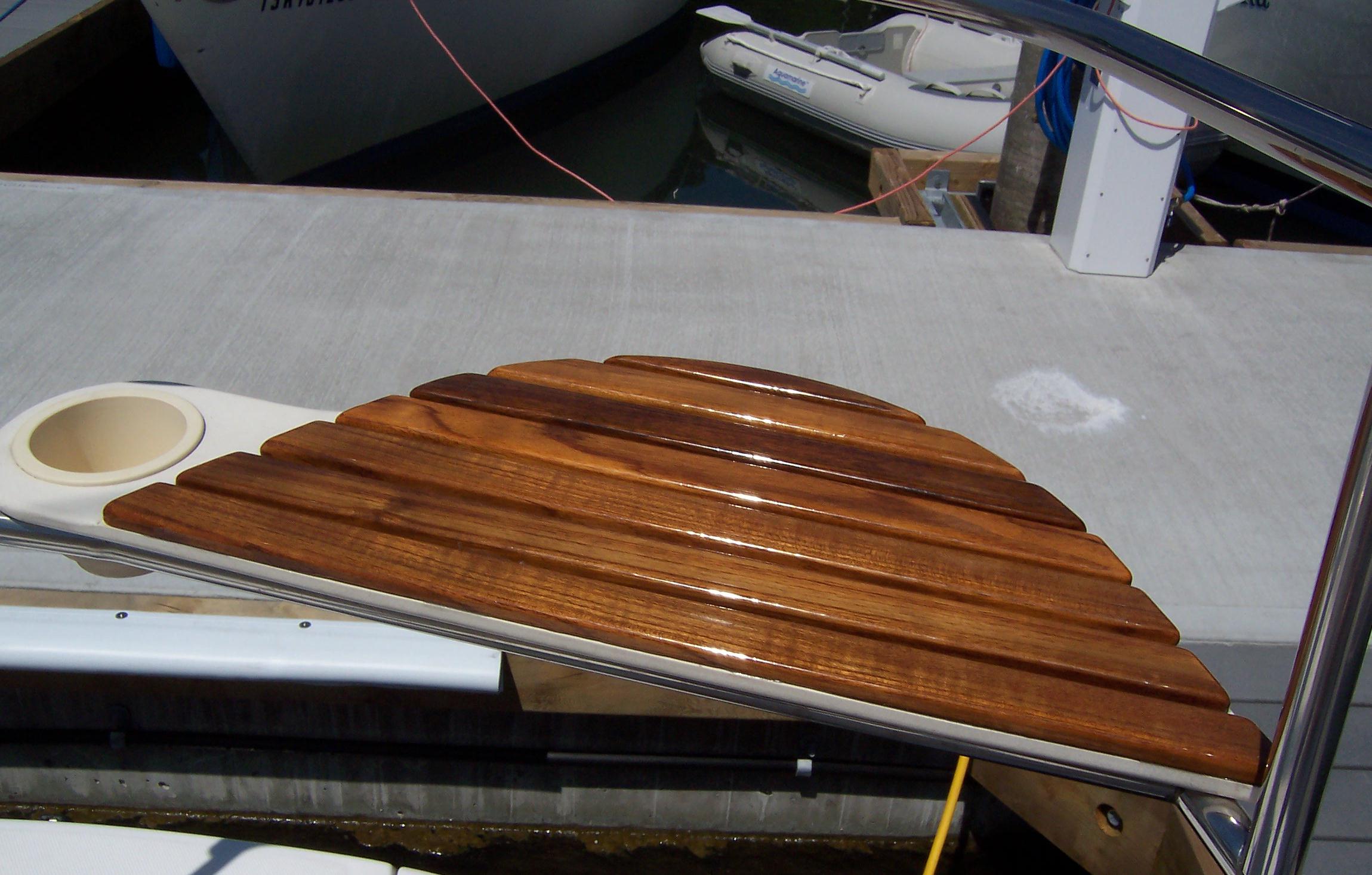

I have done this on two boats. I remove the strips and on the underside mark them with a number so I know exactly where they go when done. I then sand them down by hand starting with fine paper and progressively finer paper down to 220 grit and then refinish with around 6 coats of Epifanes varnish with very light sanding between coats with the 220 grit. While the strips are off, I clean up the white seat and spray paint them with Rust-Oleum White Vinyl Spray Paint which gives a semi-gloss surface. Seems to hold up for years. By doing it this way the white part of seats get no varnish on them nor is there any gouging at all.

If you're really into some OCD perfectionism :(, remove the slats, use a razor sharp jack plane to remove the flat surface varnish both front and back, a 3/8" radius round over router bit for the edges, and finish with 180 grit paper.
Apply 5 coats of clear epoxy and 3 coats of varnish for UV protection and .....................
Still looks like wet varnish after 8 years. A good winter project.

Wow! This is what makes this page so great. Thank you guys for all the great ideas. After seeing Ralph's seat I am rethinking the project. My seats look about like his, although a bit darker. The varnish is still in great shape. If I do become hungry for a project in November, I think I will use Tom's suggested method with heat gun and putty knife, simply because I have a heat gun and many putty knives. But if I run into problems there I have all your ideas above to fall back on. Biggest pain with this project is the eventual need to remove the wooden slats, probably one at a time, to strip them. However, I really like Lehighsail's suggestion of numbering the slats and painting the underlying composite seat with Rust-Oleum, which requires removal and marking. For sure I will report back.
