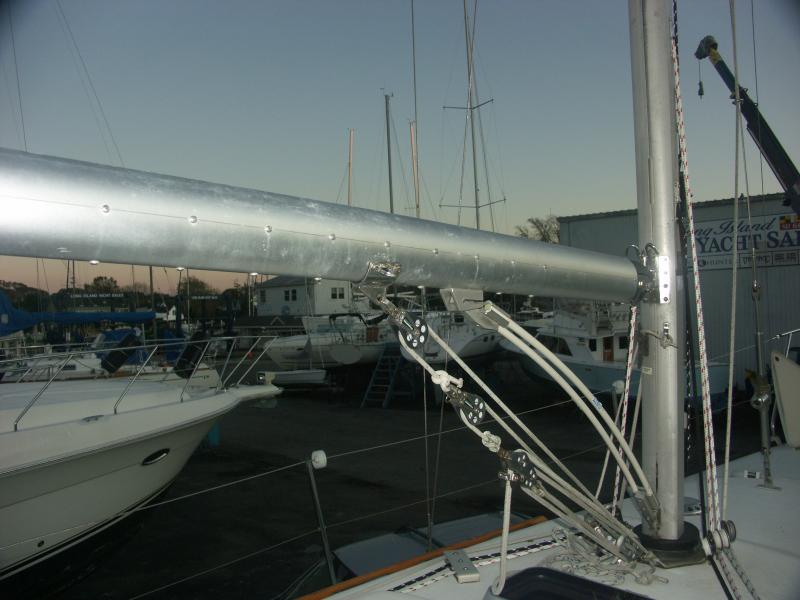

This is not exactly on topic but it's relevant to installing a new boom vang.
Using a boom vang to adjust main sail twist going upwind will put enormous loads on your vang, boom, gooseneck and all related hardware. It is very possible to permanently bend your boom. You can prevent this by installing a sleeve within the boom at the attachment point of the vang. I added a 36" long internal sleeve to my boom last season. The row of fasteners on the boom indicate the limit of the sleeve. There is no perceivable deflection now.

I Added a Block to the Tang on the Mast Step
The line on the vang runs from the boom thru the block and back up to the boom. The boom already had an extra bail on it so I moved that one forward about four inches back from the original. Using the extra block gives it a greater mechanical advantage and the block with the cleat being further aft makes it easier to use. If I can get out to the boat before I forget to I'll take a picture or two.
